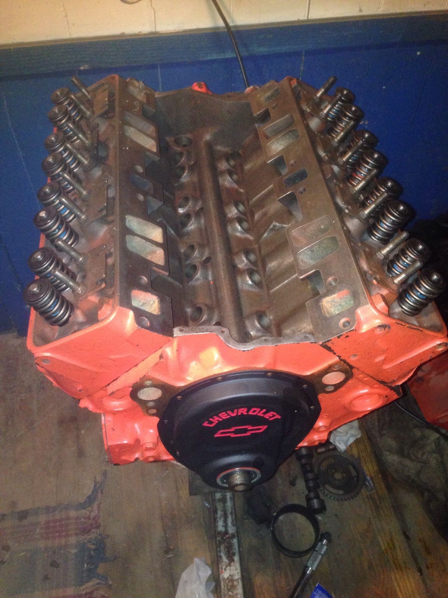

Hi all. My son was recently born so I've taken some time away from my project. Now I'm anxious to dig back into it and thought I might share some info and a video about my car. I've got a 2 bolt main sbc 400 punched .040" over to a 408 (closer to a 409 but don't want it confused for a W motor.). Heads are an old smogger set that have 76cc chambers, good porting, 2.02"/1.60" undercut swirl polished stainless steel race valves, 1.6 Howards roller rockers and springs to match my Howards hydraulic roller .560/.560 (.597/.597 with my 1.6 rockers part # CL111815-10.) Pistons are forged aluminum flat tops with deep valve reliefs on 5.565 I beam rods taking me to a pump gas friendly(ish) 10.0:1 compression ratio. Torker II and Holley 600 cfm (I know way too little carb this is just the intake and carb I had around when I was eager for the first fire. The 750 had some gaskets tear while setting float levels.) fuel is supplied by a Holley black pump with the supplied regulator from the summit kit. Torque converter is somewhere in the vicinity of a 3200 stall in my car. I have a Mellings high pressure oil pump. Cooling is handled by a Be Cool direct fit system with dual puller fans. This is all fed through a TH350 and what I think is the stock rear end. I foresee my trans and rear end being replaced soon with this kind of abuse. The trans plan is a TH400 full manual reverse valve body in the future. I'm not sure what gears are in the car. I'm hoping that my Z28 came with the 3.23 posi. I plan to figure that out when I can take the car out for a cruise. Certainly better than the slightly hopped up 305 that came in the car with only 1 side actually having the bolt through the motor mounts. So any of you experienced gentlemen have anticipated power output/ 1/4 mile ets for this car. I don't have good rubber on the car so if you want to estimate ET based on the right rear end and a good set of slicks feel free! I know I've got a ways to go before this car is finished. Recommendations for improvements are very welcome while insults are not. I'm still and forever will be a student in all this. When you stop learning, you stop progressing. Here's a video of myself and Dad during the first fire. Keep in mind that timing hasn't been tuned in and the car was kind of thrown together in a way we could see and moniter everything.

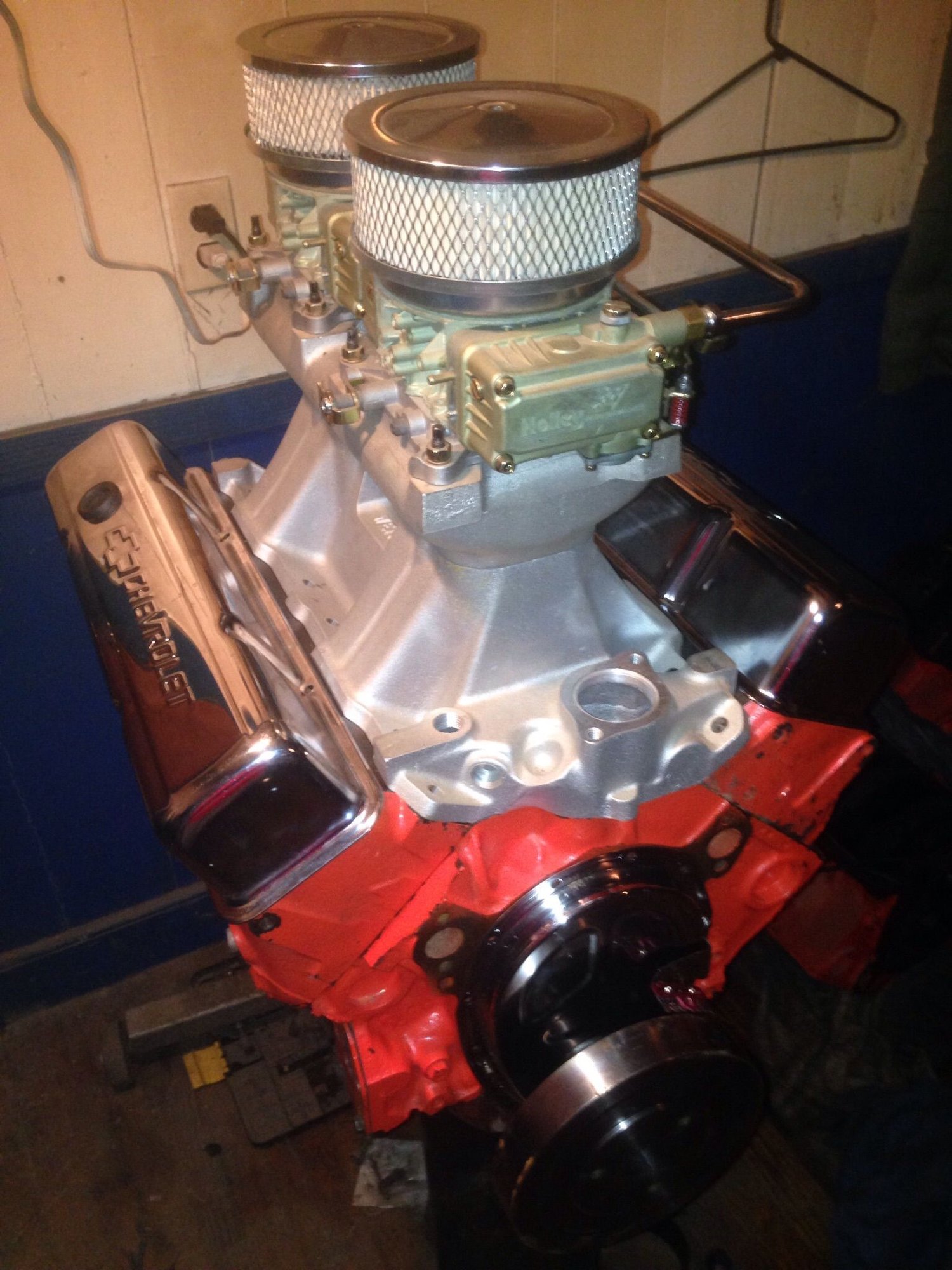

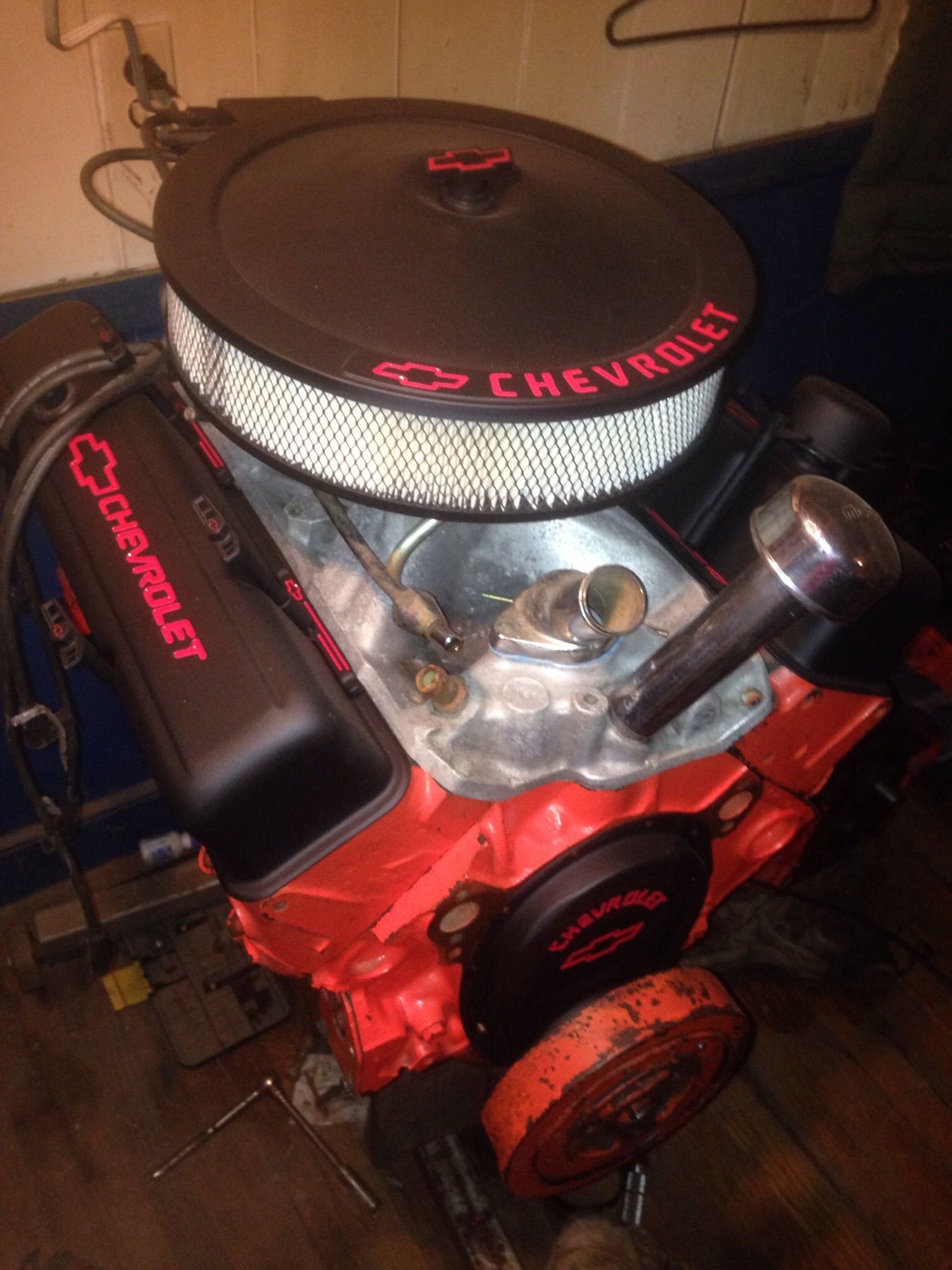

Forgot the pic.
This is the dress up I went with.
Without the intake.
Playing around with other parts around for a different visual. This is the intake and dress up on my Dad's 406 with camel humps (not the block and heads pictured.)
