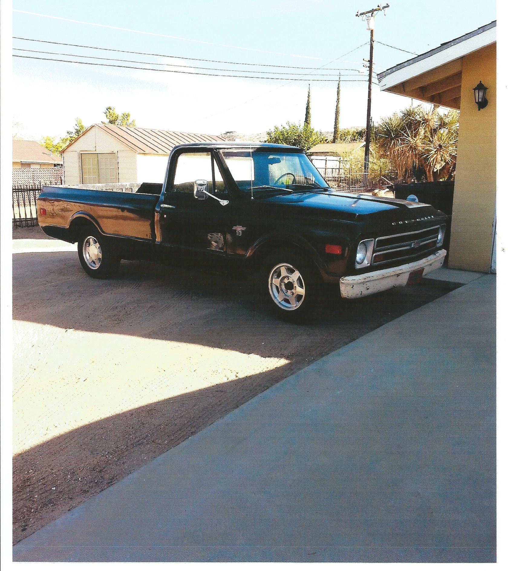

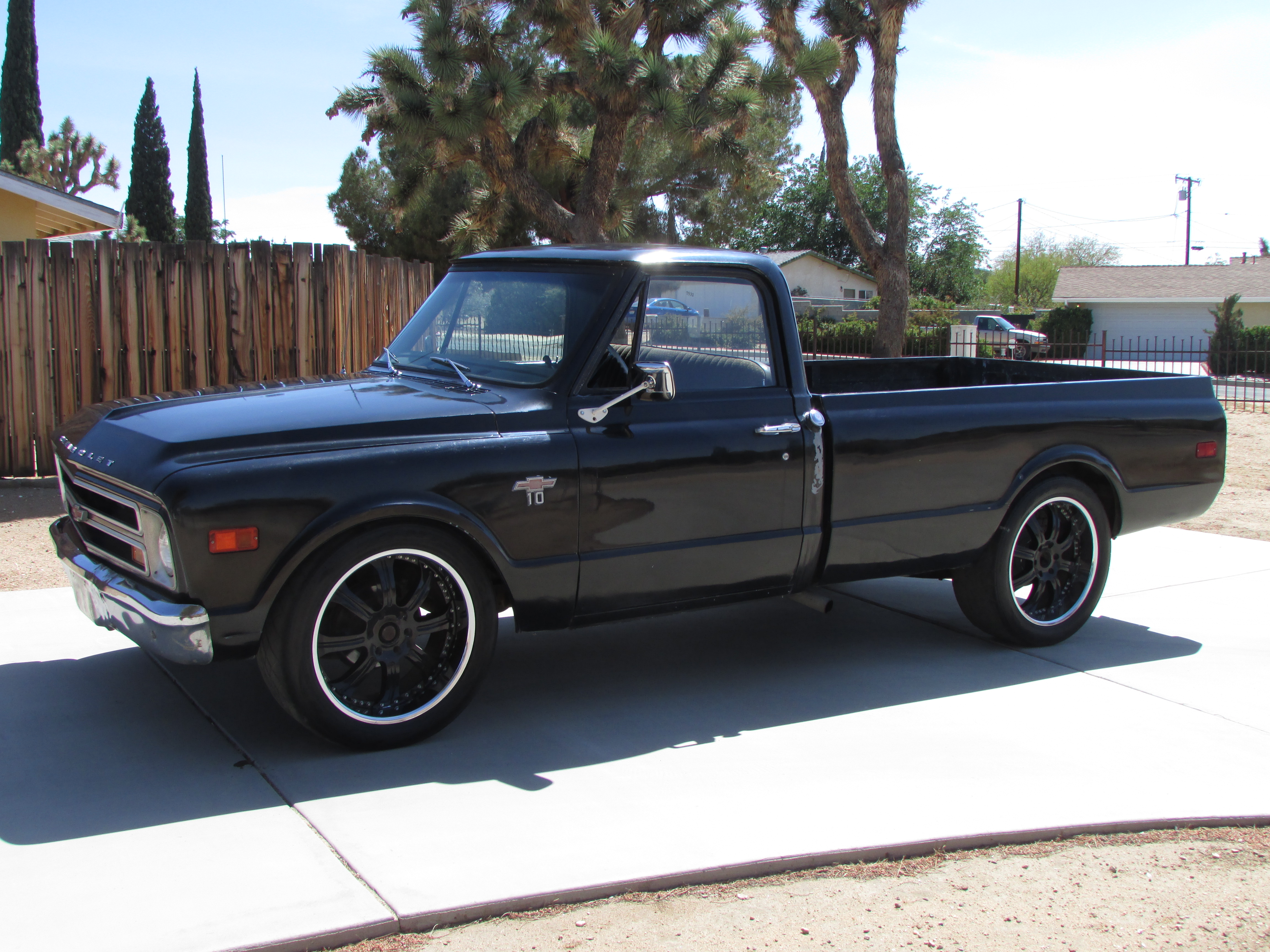

I know the 305's aren't nothing to write home about but that's what was in the truck when I bought it and it does run pretty good so it will stay for now. Where is a date Code on the 305 engine located? This might give me a better knowledge on the engines year. My truck before & after getting rid of the "wagon wheels" LOL

V0221AKA - V = Flint plant, 02 = Feb., 21 = day of month. To find the year, you need the casting date of the block which is on the rear drivers side of the block. Goto NastyZ28.com for a load of info on casting codes. There is another site, Mortec.com, that has a lot of info also. And, btw, there is absolutely nothing wrong with the 305 in your truck. They are very good engines, as witnessed by their longevity, just not the best for a performance build. I do like the "new" wheels, very cool!
