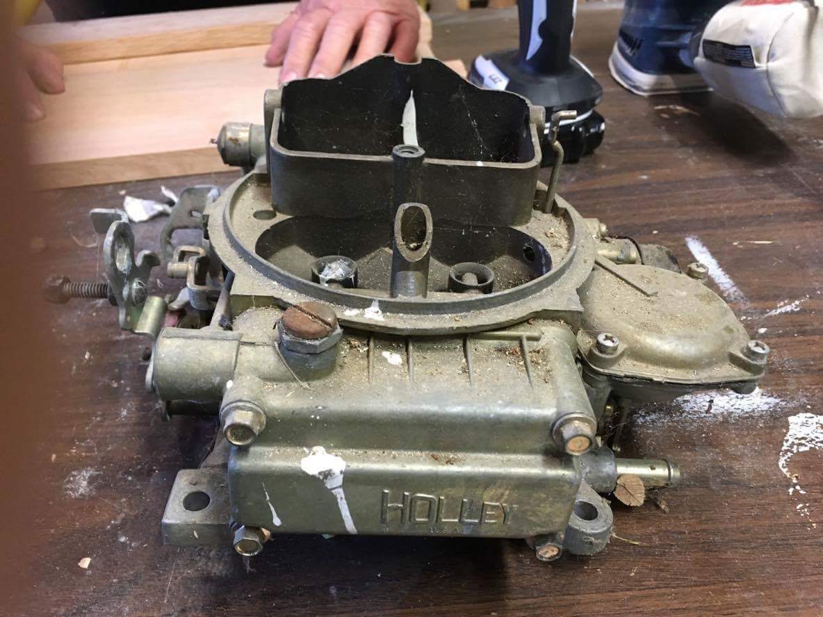

-4160 Holley carb that I had to rebuild

50$ carburetor
