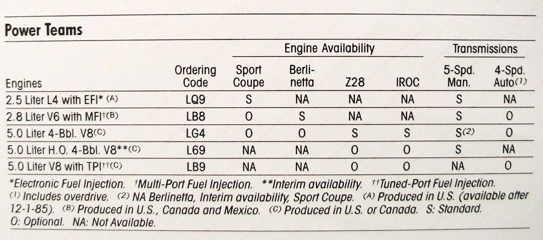

The 5th digit is a W=Trans Am. And you have Trans Am Ground Effects not GTA,GTA didn't start till 87.
This info is for 86.
