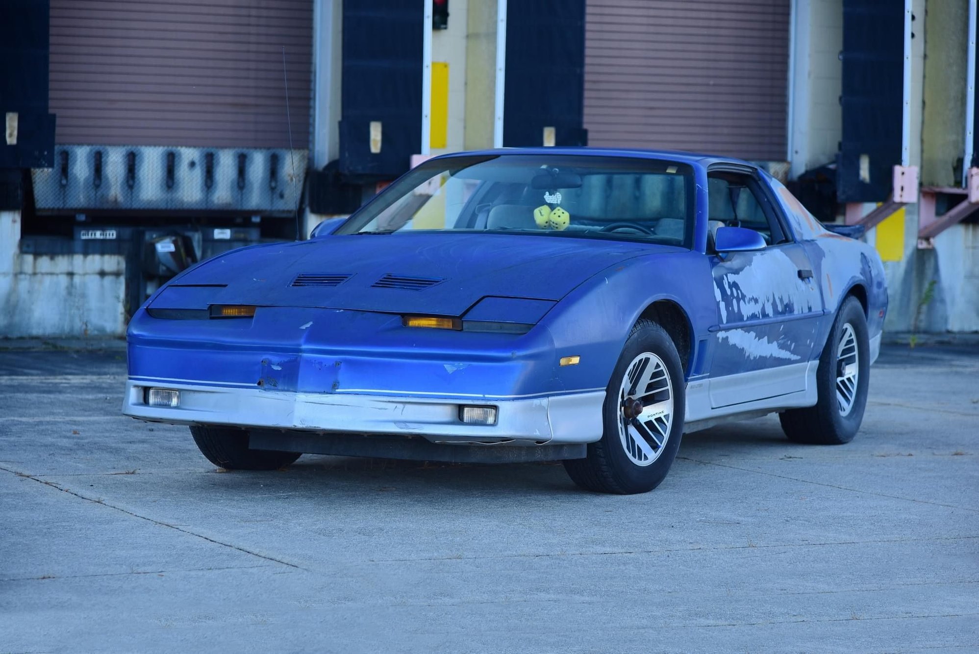

Thinking about building my 305 since it already has some aftermarket parts thrown at it from previous owners. (Im the 9th. And it has 82,000miles)the car is an 87 trans am. And I just want it to be faster and make around 300 hp. Dont know what motor I want in it eventually but I want a high revving old Chevy v8 or supercharge a 350 sbc. Anyways does anybody have any thoughts?
Plans is to make it street able and be faster and make it look like a scca car

On the vin it originally had a 4 barrel carb on it from factory. But the intake and carb are aftermarket. Ill get a picture taken of the engine bay when I get home. The carb is an Edelbrock performer 1406

to the OP, I agree w comments of the exhaust flow comments. Headers/exhaust make sense. More than that you're gonna open up a can of worms. I pulled the LG4 out of my car in 2000. I'd chill and save money for a 350 swap. A set of headers and exhaust will fit a 305/350. When I pulled my old engine I swapped in zz4 w a standalone EFI system. It was a massive change from the 305. Then in 2019 I put bigger heads/cam w a modern EFI setup. Again it was a massive difference. Swapping to a bigger engine allowed me to build on it more over time. Something to keep in mind is the rest of the drivetrain and brakes. Your car looks to be in good shape and I bet will be a good car to build. Just take your time and plan it out. It will save you money and headaches in the end!
