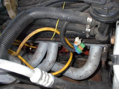

How'd you EVER get those in from the top??? I can almost see it on the drivers side with a valvecover off, and maybe with all the AIR stuff gone first on the pass. side but still... eesh. But hey, If you can do it that way :hail:
My pass side:
