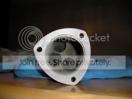

The OLIVE inside coating is the same as the outside.
The "PROBLEM" is they are a **** company that doesnt have the right tools to do the right ceramic coating job.
that OLIVE look is the ceramic coating BEFOR its finished/sealed/polished.
let me guess the inside looks like this?
How about the outside of the y pipe is it as good as the headers or look like this
In reality it should look like this. Almost like the outside. This is a set of Hooker Supercomp LTs I did
The COMPLETE inside looks like this.
They dont have a VIBRATORY POLISHER to get the inside done right. and its not worth more then $20bucks of work.
Im not tryin to rain on your party but the way they did it is no better then if you went to walmart and got a 99cent can of 1200* VHT paint and did it.
