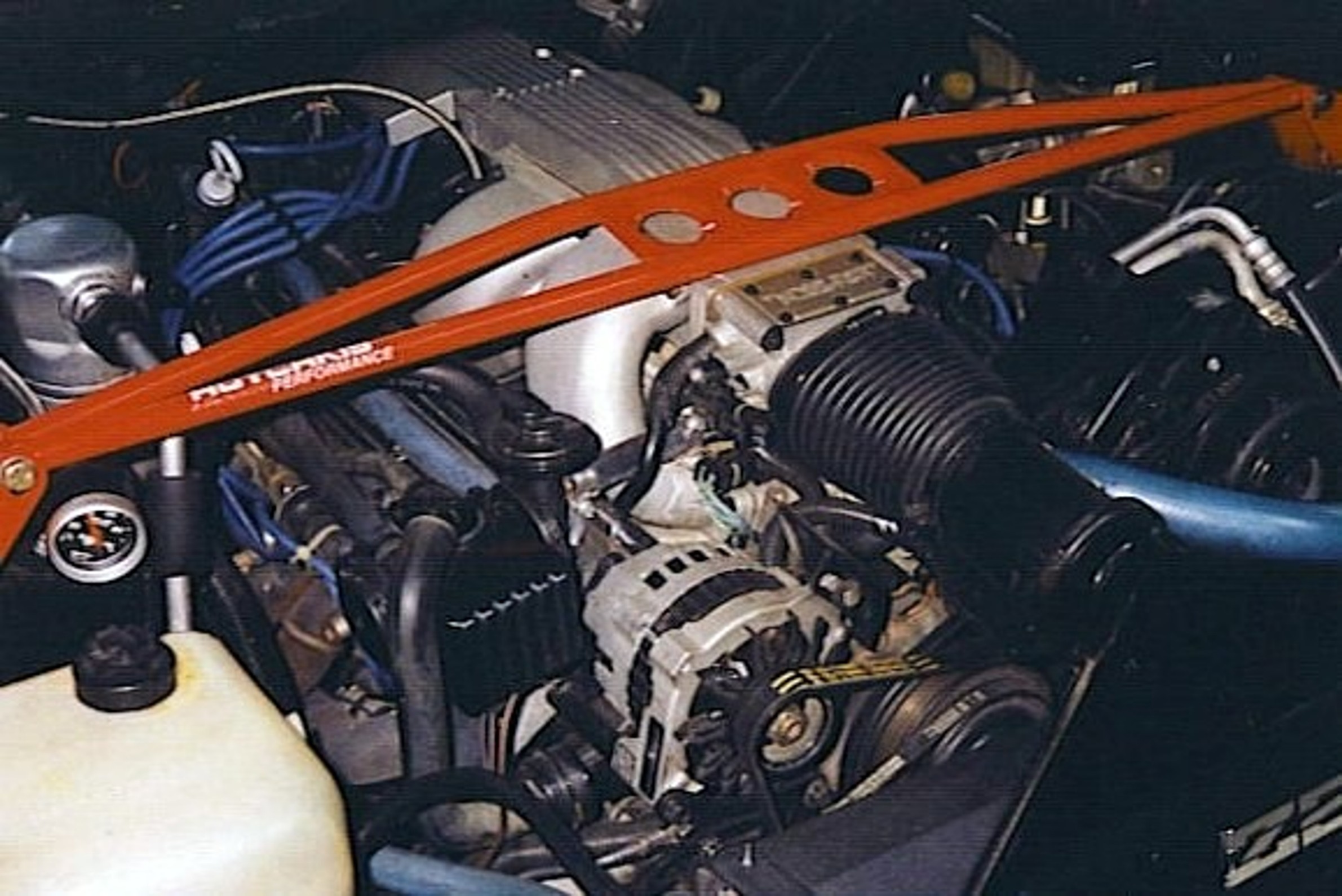

45 degree angled boots work the best with headers. I also use the LT-1 metal sparkplug boots.
Attached Thumbnails need some help - spark plug wires??-engine-picture-right-side
