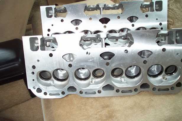

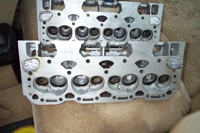

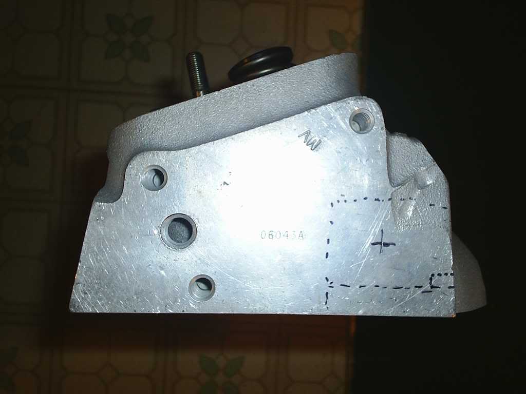

Originally Posted by injdinjn
Dont know when that article was written, but
https://www.thirdgen.org/forums/tpi/...eads-gen1.html
Looks like the pics have gone MIA. Might try an internet archive search on that.
Another member sent me a few pics that they had saved from that thread...
If anyone has anymore from that thread post them up.

dig up
i do have 305 SBC with LT1 manifold with distributor mod and water exit made thru back of intake, see picture:
now if i want to swap LT1 heads all i need is to:
1. weld water ports and redrill just to mach head gasket?
2. drill water passage on intake manifold side of heads and use Gen1 manifold gasket?
any thing else?
best regards
Old Dec 6, 2015 | 06:34 AM
  #75
83 Crossfire TA's Avatar
Joined: Jun 2001
Posts: 8,028
Likes: 93
From: DC Metro Area
Re: LT1 Head conversion project. (Info, Part numbers and Prices)
this part is easy, lay a SBC gasket on it and you'll see you only need to drill a couple of holes
Not so easy, the LT1 heads have large oil returns where the SBC coolant passages go. I considered making sleeves, machining passages, pressing the sleeves in... In the end I decided that I'd have something that was likely to leak eventually in a location that is just going to dump coolant into the lifter valley (some of it there is no good way to weld, and I don't know how much I trust epoxy for this kind of thing long term).
In your case at that point you'd have something that just goes to the somewhat sketchy locations that you drilled in the LT1 intake... no sure that's the best option.
I did mine with a combination of using something similar to the old school smokey yunnick SBC cooling system modifications, some of the circle track coolant re-routing and the stock LT1 head "burp" lines.
any thing else?
best regards
That depends on what you've done with the rest.
The LT1 head intake bolt pattern doesn't match a stock SBC intake, so if you've filled and redrilled your LT1 intake for and SBC pattern you'll have to weld the face of the LT1 head bolt pattern shut, machine it flat and drill/tap the SBC pattern (this is what I did). That will run 4 of the holes into the LT1 "burp" holes so you need to figure out how you're sealing those, and if you're running something to the or plugging them off.
Intake port locations are slightly different, which depending on how much you care might be an issue. You can't go off of gaskets, since I found that stock LT1 gaskets covered the bottoms of the stock LT1 ports. I ported mine dead on to a felpro 1205, but found that by the time I put everything together I needed to use a 1206 so I wasn't covering something up.
The exhaust flange uses the alternate, outside bolt hole locations which could be a problem depending on what manifolds/headers you're running
The valve spacing is .050" wider than SBC, so that can lead to interesting problems (different or adjustable guideplates, I'm running mine on a 305, and decided to notch the tops of the bores for better airflow).
rocker arms could be an issue depending on what you have now...
I think that's everything...

ok, if i do exits like FueledSoul showed in post #68 then i can use stock LT1 intake gaskets and forget about water passage thru oil passage to intake manifild problem, right?
intake bolt pattern is no problem to redo.
headers can be easily redrlled to match bolts.
i don't plan using guide plates
and will run with scorpion full roller rocker arms
best regards
do you already have some LT1 heads? If you try to look inside the heads in that area you'll see it's not a great place to put the holes. It's sort of the traditional place for the yunnik cooling system mod holes, but the water jacket in the LT1 heads is somewhat blocked off in that area.
best regards
the pushrod holes are not broached in LT1 heads, so you either have to run guide plates or self aligning (guided) rockers. FWIW, a few of the pushrod holes are tight enough on one side that you may have issues with 3/8" pushrods. I used adjustable guideplates and was just barely able to get things to line up in a way that nothing touched. If I was going to do it again, I'd either run 5/16" pushrods (though I'm running enough lift on an aggressive enough lobe that that wouldn't be a great idea) or clearance those holes some before putting them on the engine.
Old Dec 20, 2015 | 03:36 AM

as my heads ae still waiting for welding the coolant passages i came to an idea for water exits to remote thermostat, can i just use sensor wholes with proper screw in joints ?
will that cause any cooling problem?
also will use stock lt1 water crossover pipe that goes in back of heads.
i already have CLT sensor for ECM in thermostat housilng and moving gauge sensor is not that problem.
best regards
