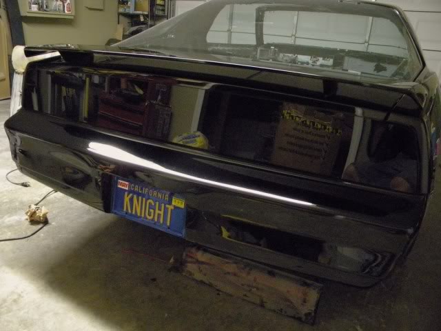

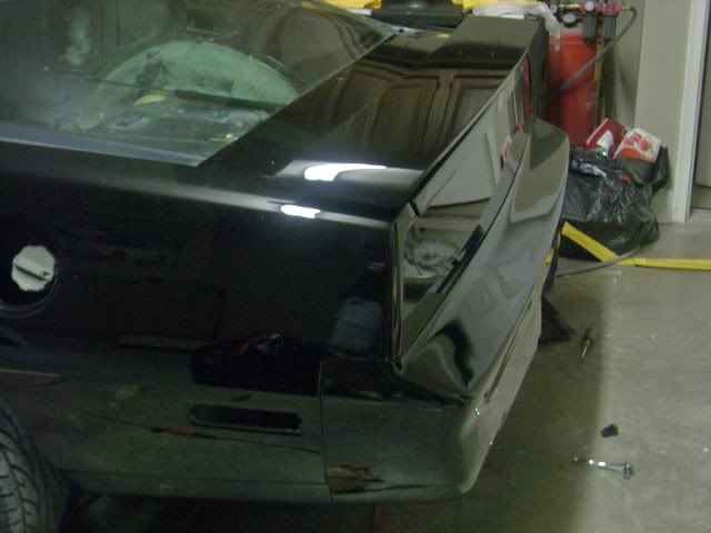

Well I know you guys don't feel great about these Knight Rider cars(some of ya, but you might like this tail light Knockout from Billy of Knight Designs.....Would look cool on any trans am..anyway Well, before I got started on the interior and engine stuff....I just had to go ahead and do this to the car...been waiting awhile to do this, but here it is... MY TAIL LIGHT KNOCKOUT!!!!! YEY!.... I got the tail light knockout from Billy of Knight Designs, although you might want to take your time on this as it does take awhile to do. First off, this is my second one of these, but this is my first from Billy. Billy's is definately sturdy and not going anywhere anytime soon, that's for sure. This is not a tutorial, this is just how I did it...First off, you have to split the tail lights into their two sections....which, just undo the pins on the bottom and the two pins on top(plastic ones).....then , you go ahead and mount the tail lights and make a few brackets.....go to your local Lowes hardware are any hardware store and get some 90 degree elbows made out of aluminum.... then mount it.....
When you take the tail lights apart , you will see that the tops of them are undone. You have to secure these as these are what holds your knockout bracket on. Here's the knockout bracket put on.... By the way...that center section has to come out or the middle will not be flush with your bumper....too much space....found out the hard way... Anyway
I put long holes on the brackets so I could adjust them before tightening...this way you can get the knockout plastic to be exactly with your bumper....
After I got this done, I just had to put the plate on.... anyway...that's Billy's knockout. Definately a days work , but worth it. I still need to get me a chrome bezel for my plate. but that will be tommorrow.... Anyway Thanks for a taking a gander
