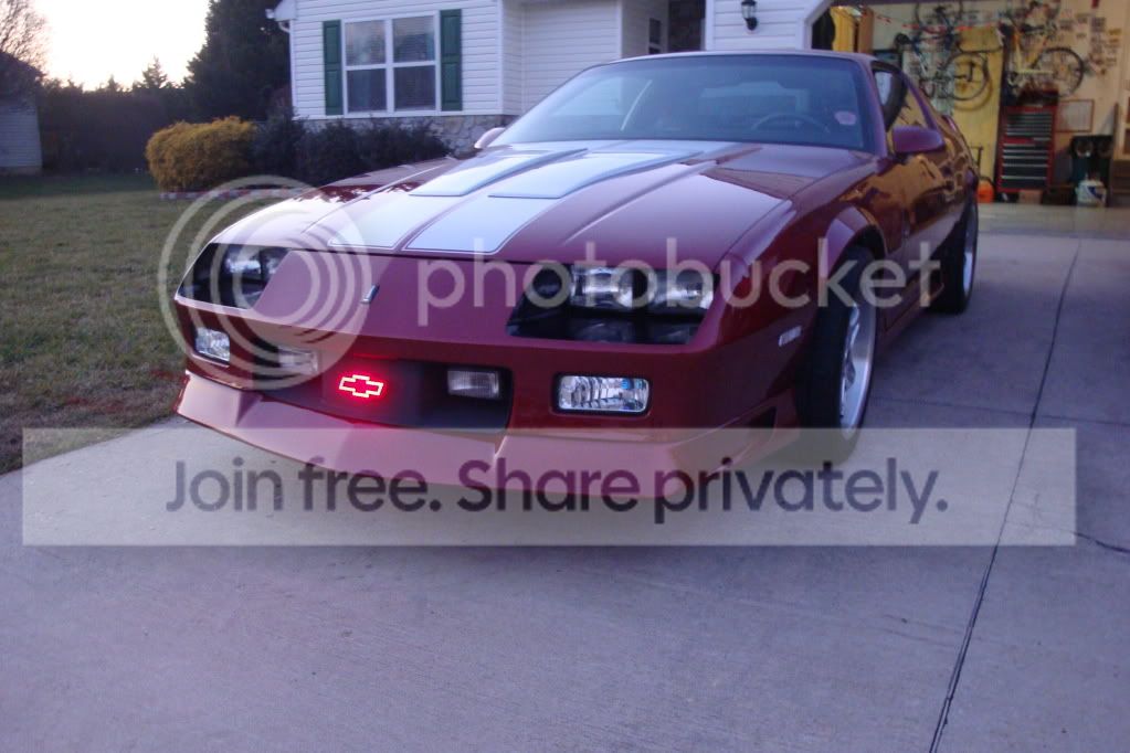

This might not be for all, but thought it was different. I basically got the idea from the Impala SS guys, they take out their bowtie emblem from the center of their grill, and wire in a LED bowtie. I started with a stock front piece off the Z, sanded down the bowtie that was on it, used a block that the Impy guys use for an aftermarket grill that has a recessed area for the LED to sit in, cut the block down, V'eed the back out to fit the 3rd gen nose piece, bonded it into place, sanded, filled, primered and painted it to look like it was molded into the plastic piece. Them mounted it back into the car, and ran wires and a dedicated switch to the cabin so it is independent of all the other lites. Just something to do during the winter months.

wow looks very VERY nice, should mod the third break light now

I love it! It's unique and looks great!

looks very nice, just a FYI if a cop wants too he CAN pull you over for that though since red lights arnt "aloud" to be lit on the front of your car but very nice fab job it looks very nice

That is ****ing sexy. Maybe get a nighttime pic? Im curious to see how it looks at night.

Yea that is why it is on its own switch, seperate from the rest of the lights, and it will prob be a parking thing, I don't drive it much at night.

I see. That's a very cool mod. To bad maryland requires you to have your tag in front

Just like Texas, but that doesn't mean it has to be right there blocking the bowtie. I mounted mine using 1 scrap pieces of aluminum & it uses 2 existing bolts under the nose so no new holes were needed. And no, it doesn't blow backwards & scratch the paint when driving.

I think that looks great. Just to be on the safe side, I'd have to go with the white or amber. Great job of fabbing that up

Most of the Impy SS guys run red, I think once again for parking, cruise night, shows etc. Esp at Carlisle, the Hotel parking lot is full of LED Bowties!.

It really does look cool but I'd want to have mine on all the time when I'm driving at night.

I LOVE this mod. Great job

Looks great. I'll have to check it out when I see you at Carlisle this year.

Very nice, looks like someone likes red!!! Very nice.

It was there last year. No one hardly noticed during the day, and it was on at the hotel with all the Impy guys as well, I think my mod is the only one on another car other than a Impy.
