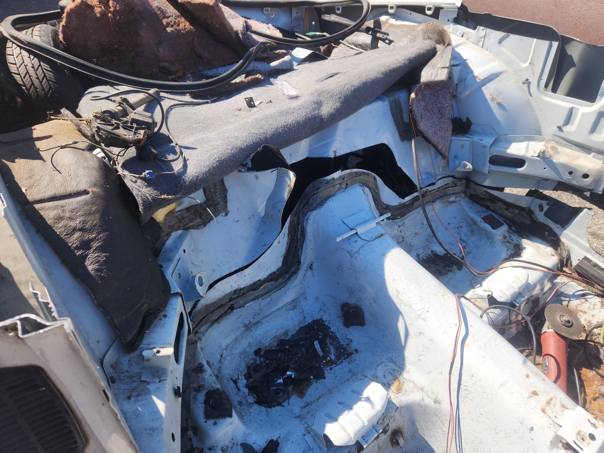

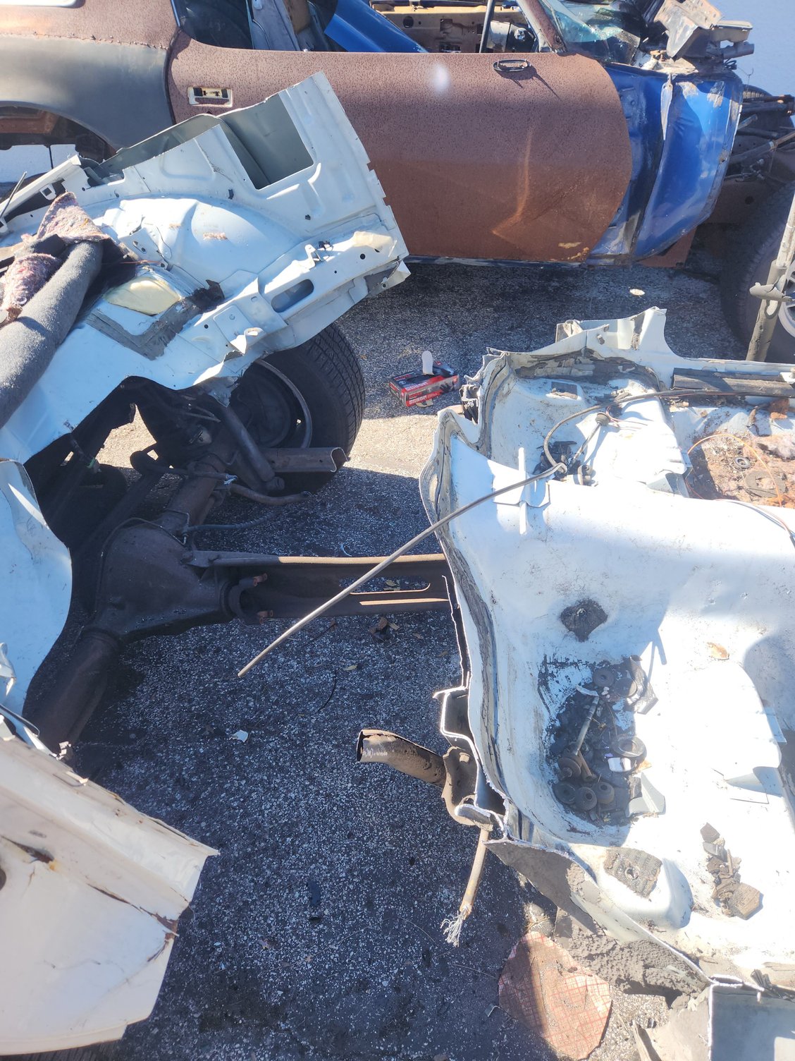

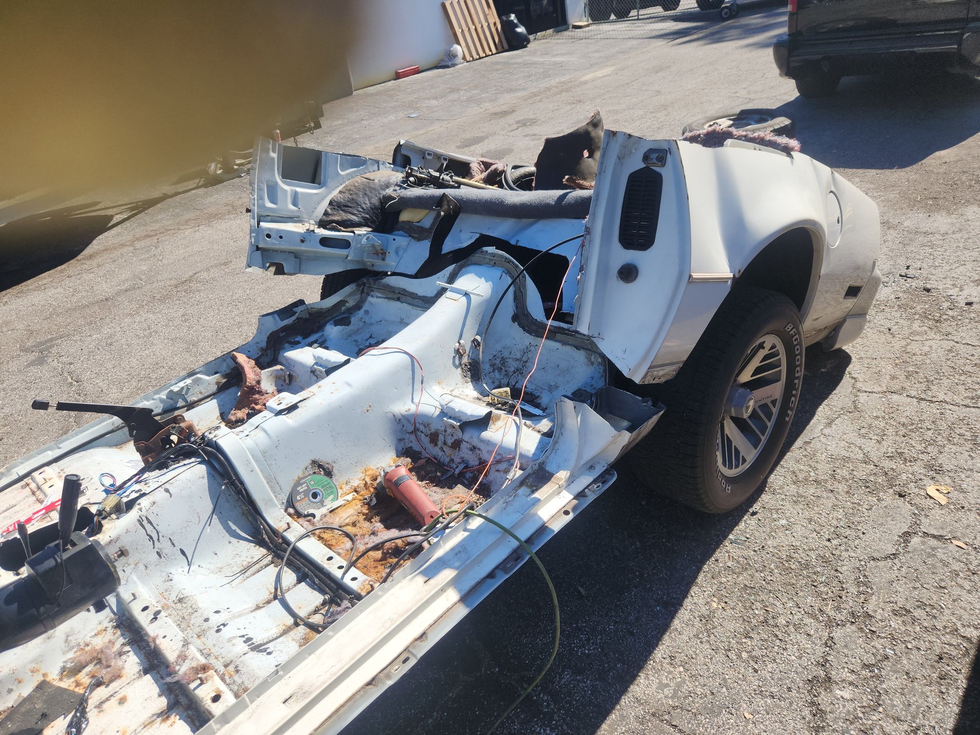

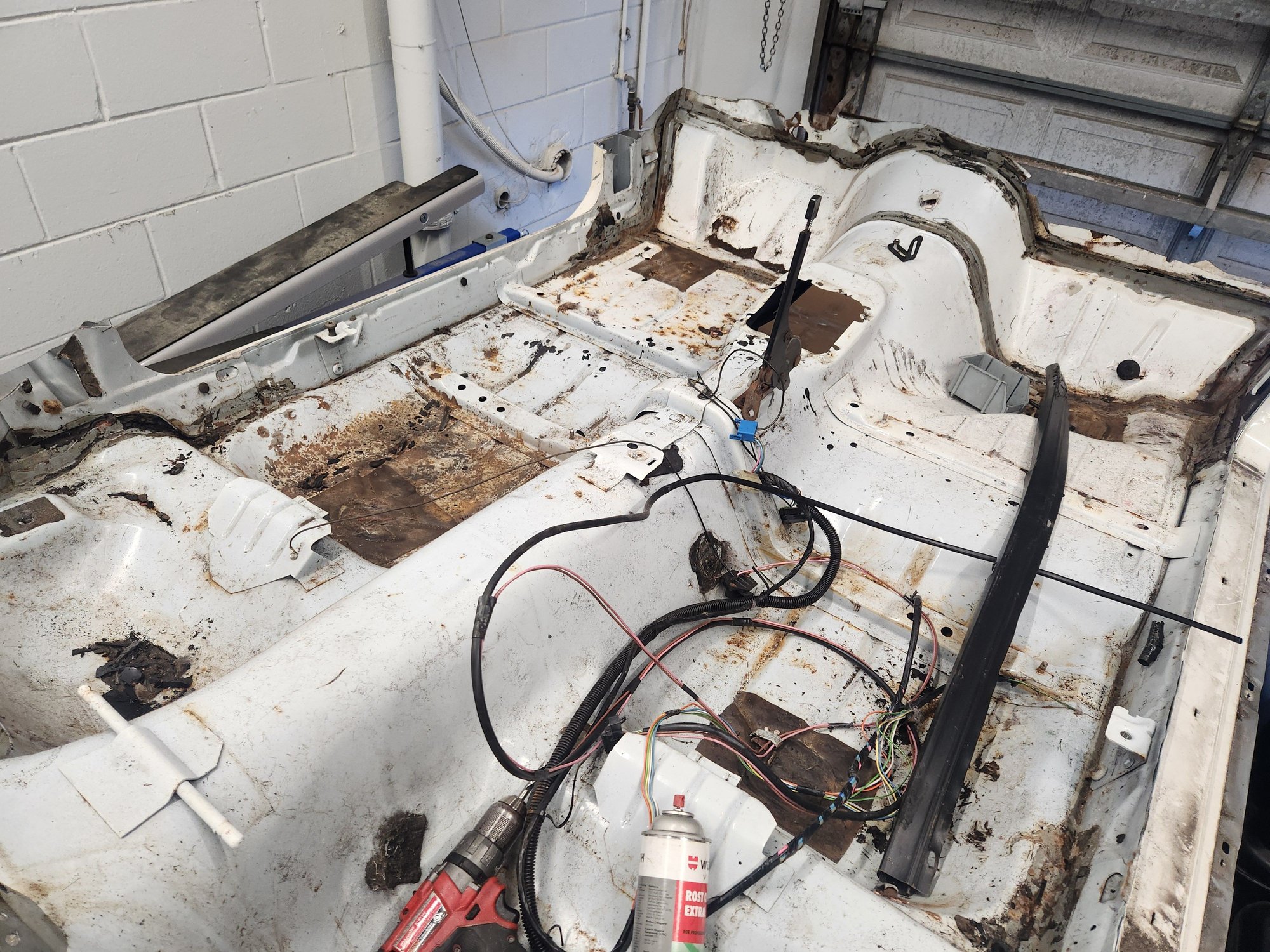

Parts or labor? If you're looking for parts and near Florida, I have an entire floor that I'm looking to get rid of. The driver's rear foot well is marginal, the rest is fantastic. Id be willing to sell the entire thing for $250
