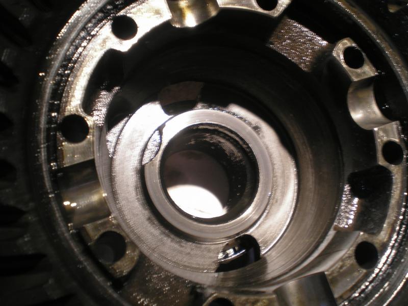

Re: Everything I know about 9-Bolt Rearends!
cones eventually hit the ends of the case
so instead of friction between cone and side of case the friction is just the end of the cone on the axle end of the case
in this situation they don't work
however if you pull a cone out you will find the face is flat but the section for the splines is counter sunk by .5-1mm
so you can take that much off the flat face with a lathe, 1 mm off the face of the cone without detriment to the spline width acting on the axle.
you then add shim between cone and side gear until you can not seat the cross properly
then you take out enough shim to allow it to seat.
once happy with one side build the other side the same checking how much shim you use
then build up the normal way....ring gear side on axle shaft sat in vice
cone, shim, side gear, check cross fits, spring pack side gear shim cone (align) the top half and put the lid on
put other axle in to check alignment of cone and gear
loktite the bolts
do up in cross pattern to take up the spring
do up to torque....

My 9 bolt is finally apart... the cones are worn bad..and the case too.
i am curious if its possible to use any other minispool or lock right or anything else made for a GM, ford,chrysler with 28 splines...
28 splines is 28 splines???
the complete assembly is 3 1/2 wide inside the carrier
the cross shaft is .660''
4 1/2''long
if not i will probabely end welding the spiders and the cones...
cant find anything in us and www.9bolts.com dont answer e mails

OK my cones are machined down and i cant find the 1105 shims in canada.
and the site sugges us to use torco 85w140 with F type but in torco website f type is for clutch application ford....gm/bw use cones so should we use???

I've got a rearend out of an 88 GTA Trans Am with brand new cones and an aluminum support cover and a 3:27 gear that was in my 82 TA that worked great when I pulled it to put to the Moser in I have now. If you are in or anyone is within driving distance of Gulfport, Mississippi is interested I would take any reasonable offers for it.

OK standard diff oil
with mopar sure grip additive works fine, this style of cone diff was invented by Borg warner for Mopar
pop into your local chrysler place get the additive for 8 3/4 sure grip clutch centre...yes thats a clutch application but its all the same additive
and use it with 90 weight gear oil..
or just use the stuff they use in catapillar plant diffs
its a ready-mixed and it works great....
shims
you may have to find shims from some other application
buy a pile of them
take them to a machine shop who can clamp the pile into a cylinder and hone out the middle...
various US suppliers will do shim
infact the first few posts of this thread make suggestions
Dave

My 9 bolt runs like a charm since i machined it (50$) and use Home Depot Shims 0.49$ X2 !!!!

Another 9 bolt needs help.
Pulled the axle from the '86 T/A parts car for my '91 and found it has almost no posi action. (Dump the clutch and you'll spin both for 5 feet or so, then one wheel from there. No posi action during cornering)
Took it apart to find worn cones (no surprise). The case looks OK, the cone ends just barely kissed it.
My question is machining. How much and at what parts of the cone? What do I tell the machinist?

Okay so the cones have a taper to them. Meaning of the flat end one has more diameter than the other. The idea is to machine off the smaller end. The posi unit uses springs in the middle to force the cones toward the outside which uses friction to grab the sides of the case causing the axles to lock since the cones are also splined to fit the axles. As for how much it just depends on how bad the cones are. Obviously It will need to use shims to take up the additional slack. There is a post here that discusses the window and spacing that should be used. Posted from Thirdgen.org App for Android

ok, I machined the cones .030. When fitting the crossshaft, it rocks a tiny bit even without anything under it. I suspect it's bent. Tried different positions and same result from the same arm. I think I'll have to live with it even though it's certainly not ideal.
Whats the typical amount of shims used here? .070 and no difference yet...
As far as shims you will just have to add til it is tight. I did one cone with the cross shaft and spiders in place and then the other. This got me close. But the total shim was less because doing one side at a time doesn't take into account the play in the spider gears. Also, it is helpful to have everything clean and dry when checking clearance. With everything "close" and it bolted together I was able to feel and hear the side clearances. I got it to just about "0" clearance.
One final note, if you set it up tight you may notice some popping and clunking in turns. Make sure you use the GM additive. The part number is somewhere on this forum. But if you go to the parts counter they have it. It's well worth the $8.

Thanks! I'll buy some more shims and try again.

Workin' great! It's been a few weeks now, should have posted earlier. Thanks for all the advice!
