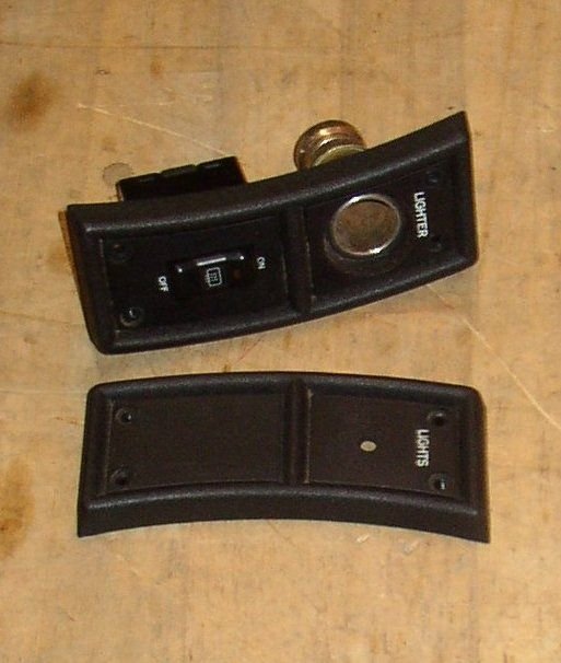

Dash Doesn't Look Right,The 1982 Cars Had The Words "Lights" And "Lighter" Spelled Out.

Wrong dash pad.....

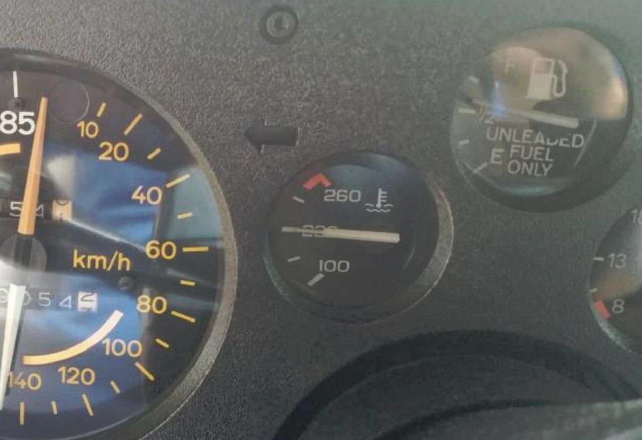

The gas gauge and temp gauges should have a different earlier font and fatter needles like the voltage gauge, correct? With the seats redone, replacement tires, etc it has to be a restored car...
They should look like this...

Quote: The gas gauge and temp gauges should have a different earlier font and fatter needles like the voltage gauge, correct?
Looks Like The Temperature Gauge Has Been Replaced It Has The Step Down Needle Which Didn't Come Out Till 1985,The Gas Gauge Has The Taper Down Needle Which Is Correct For 1982.
