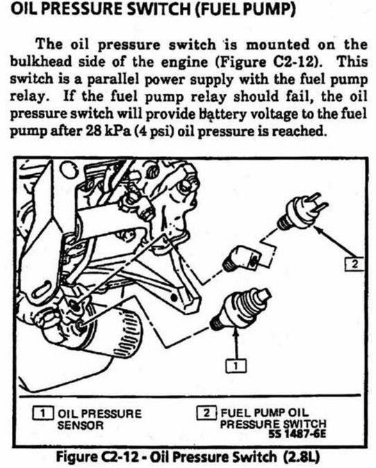

Here is a little more information.
As you can see in the diagram the oil pressure switch contacts are wired in parallel with the fuel pump relay contacts and they don't require a key on to start the fuel pump if the oil pressure switch contacts are welded closed.
This is very helpful! Thank you!
