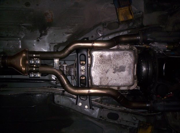

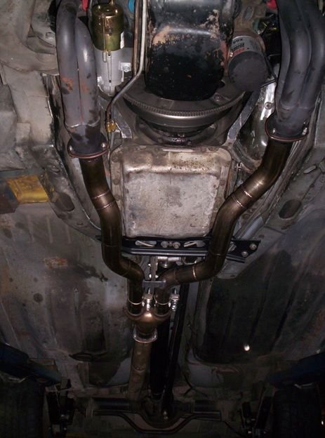

Unless there's chassis interference, I would think that the BP pan could stay. Then some mid-length headers (like the Headman model I have) and a fabbed y-pipe to what ever cat back setup you have now.
Sort of like this:
That's a couple of chassis' ago but the idea is the same.
Headman headers. Fabbed y-pipe (could be in mild steel rather than stainless) and a Magnaflow or Flowmaster merge.
It's difficult to see (and I have better pictures) but the oil pan doesn't come close to headers. And I went with a mini-starter (OEM style ) for added clearance.

It might be more than you're willing to get involved in although you did buy an aftermarket engine!
Here's a better view.

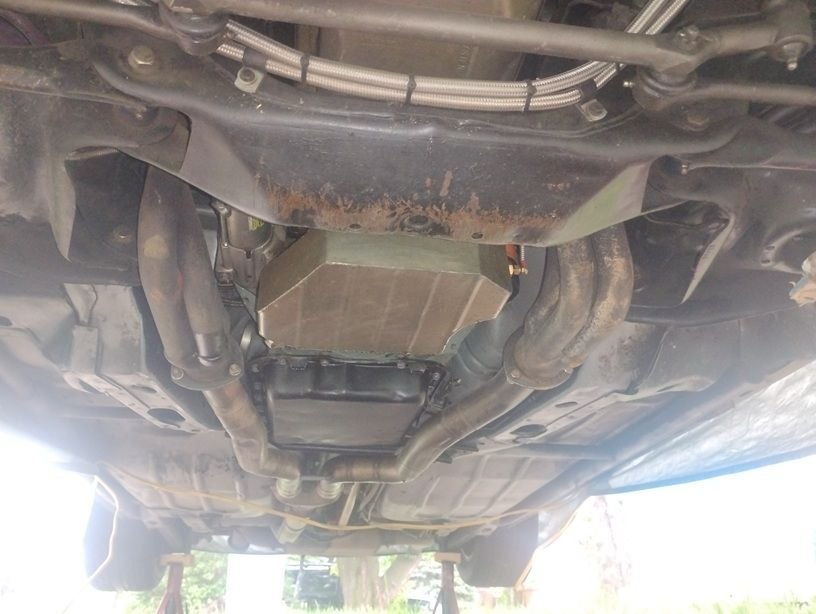

what car is that on? I don't have the same room down the driver's side on my 88 gta.
I am currently using Doug's shorty headers and y pipe. The drivers side crosses over to passenger side between the oil pan and cross member. The drivers side runs out of room for exhaust just past stall converter.

Can any of you confirm the clearance is ok on the stock pan with the 383? I'm seeing some posts that talk about using a hammer to gain clearance on a 383. Id rather change the pan then adjust clearance on a new motor with a hammer. Any other options in pans?

Originally Posted by george88gta
I also have a 700r4 trans, so the brace bar (torque arm)is also in the way, no?
it worked on this car and numerous others like it. If you look, theres plenty of room around the oil pan. This car could get even better clearance w an x member w recesses in it for the exhaust.
this isn't the best execution but you get the idea.
Old Yesterday | 11:16 PM
george88gta's Avatar
Posts: 451
Likes: 22
From: Long Island N.Y
Car: 1988 Pontiac GTA
Engine: 5.7 l98
Axle/Gears: BW 9bolt with torsen carrier
Re: 383 gta exhaust
thanks, it's tough to tell but is that exhaust out below the oil pan, my car is lowered (only a inch) but I also live in NY. So ground clearance worries me, as my taxes go to everything other than paving the roads🙄. I will have to take a look with myself under the car while viewing this picture thank you
