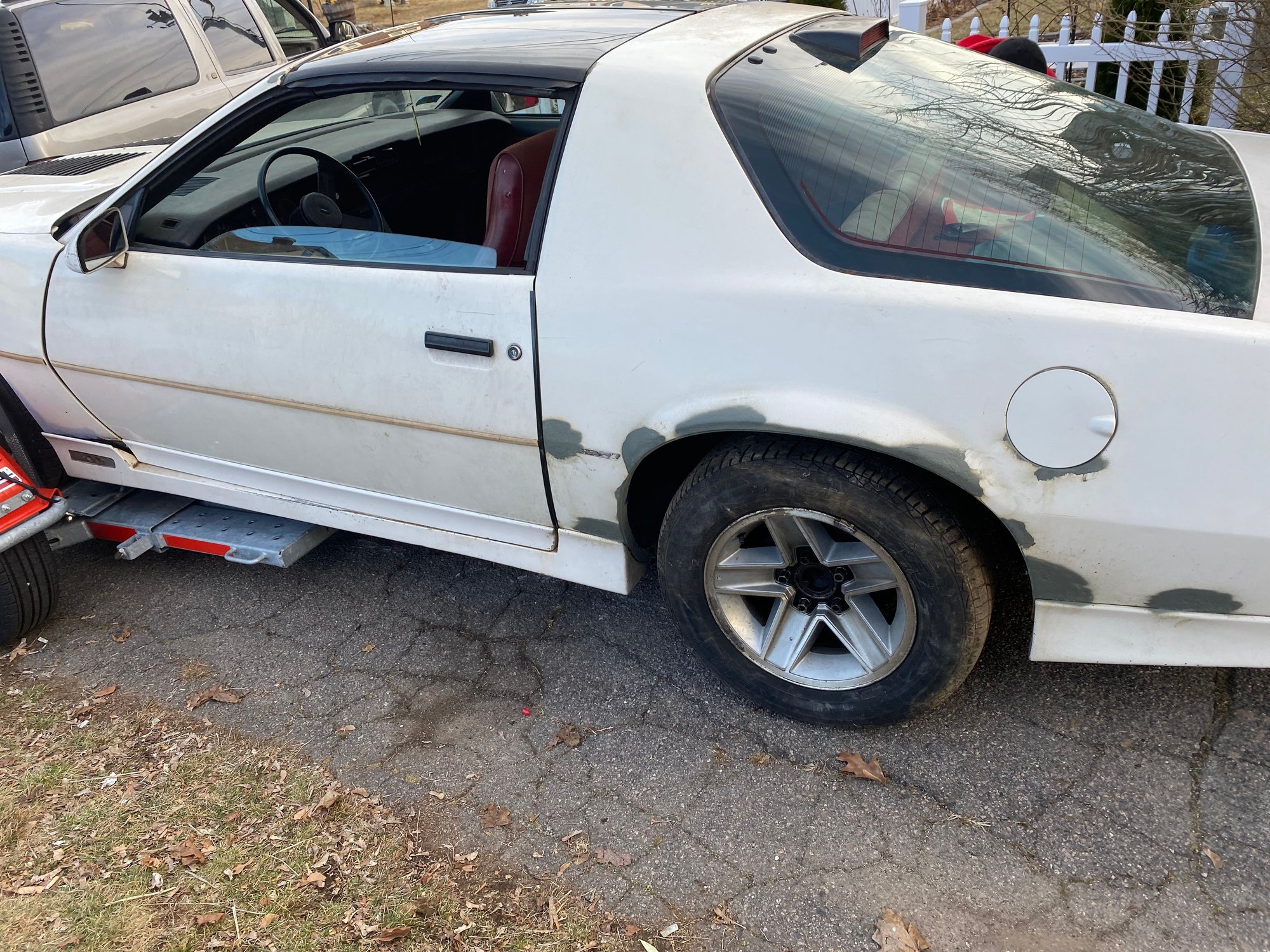

I had started some body work on the car before I found out we had to move. I had taken out the spark plugs and shot penetrating lubricant in all 8 cyl. I have drained the coolant and stripped the interior. I was about to begin going under and tackling these issues but I ran out of time.
The floors are beginning open up under the seat position areas, it’s in New England so getting it’s fair share of moisture and temp fluctuation, sad but expected.

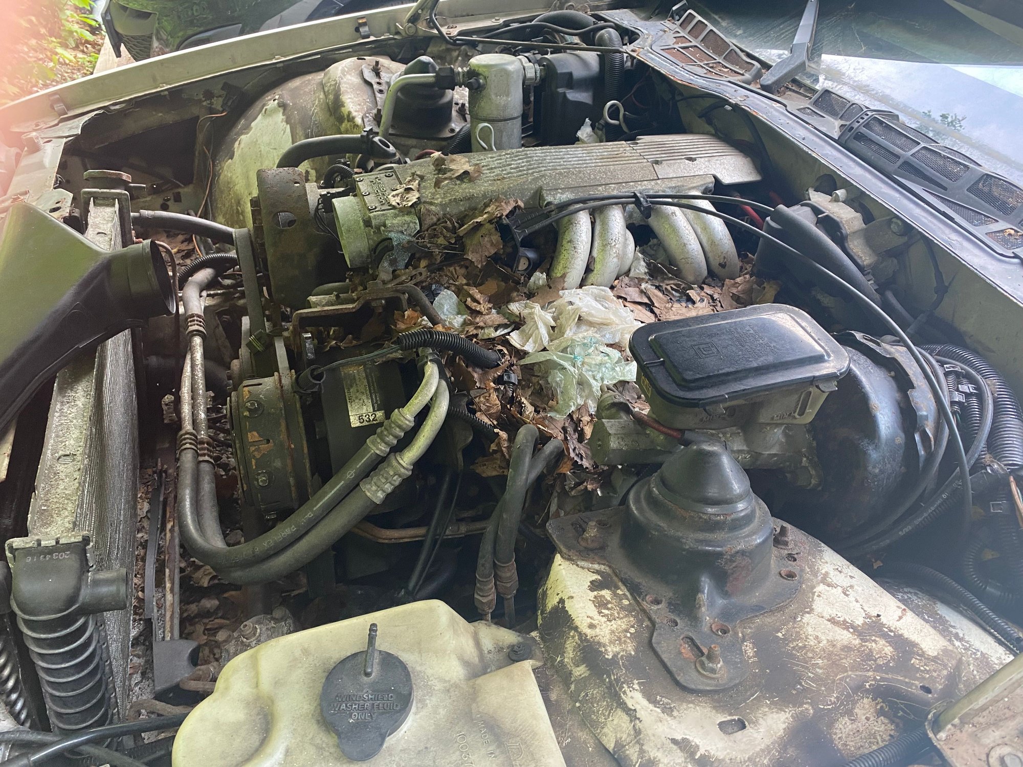

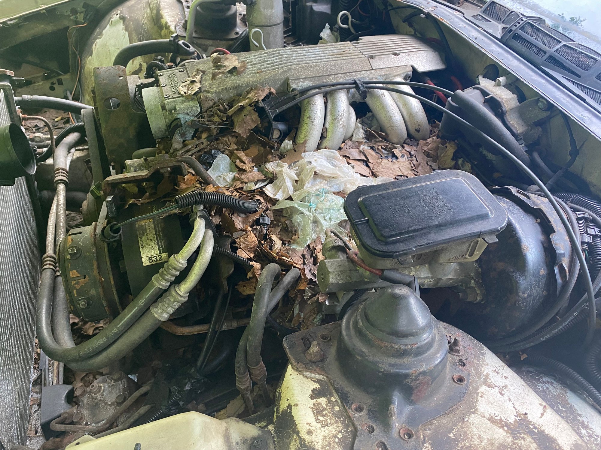

I just popped the hood. Boy was i in for a surprise.

Lol....holy crap!

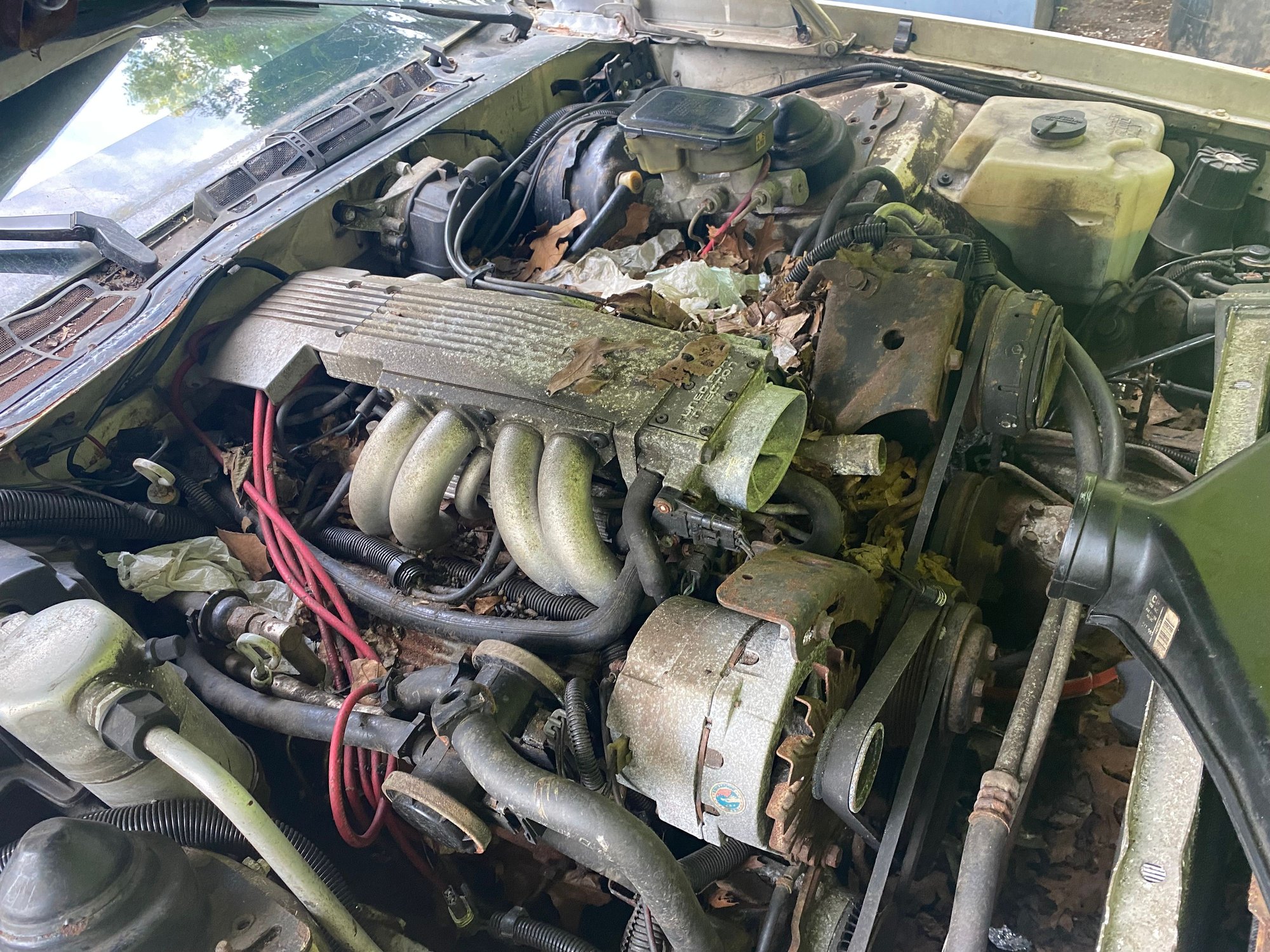

Hopefully you have been collecting rent from whoever was living in there for the past years. That could offset the cost of the replacement MAF you will need, and a few other items of interest.
It would be good if your tenants did not chew up any wiring, and the photos don't show anything obvious. Still, keep an eye open for damage to harnesses and wires. At least it appears that most everything is there, minus the MAF and duct, and battery.

I do have most of the missing parts minus the battery. They are in storage along with all of the entire interior.
this weekend i will go remove the nest and clean the area as best as I can safely. Then I will inspect everything I can see.

Do you have a power washer? If you do....I'd hit it good with that, before working on that thing.

I wouldn’t power wash it. I’d get a wet/dry vacuum and suck all those leaves and debris off it. Then, use some compressed air to blow all the remaining dirt and residue off the engine. You don’t want to get water inside the connectors because that may cause electrical issues down the road if the weather pack seals are old and brittle or missing.

Conversely, if you don't get it clean enough, when you open it up, debris could get into the engine and cause extensive damage! Maybe even total engine failure!!
Worryin' about **** that ain't worth worryin' about. Fear mongering.
Use some brain, don't shoot the wand directly at sensitive electronic parts from 2" away. We power wash engines daily at work w/o zero issues. It works awesome, makes things look brand new and it's fast...easy button.

Bad advice. You don’t want to be pressure washing an engine that has leaves and debris all over it. Take some time and vacuum all that stuff up and clean it up the manual way. The connectors and wiring on these cars are almost 35 years old so just take your time and do it like I mentioned. In fact, even if it was brand new, I would never recommend pressure washing an engine. Lightly spraying it off with a hose, okay, but not pressure washing it. Bad advise. These are not tractors.

Curious: How many engines have you cleaned up?
As a wise tech instructor once said:
"I don't know everything....but I know more than YOU!" I think that applies here as in other threads.

Id vacuum it first and then pressure wash it. You don't need to be on the blast the paint off setting but the pressure washer should be fine and its the only way you're gonna clean all that gnarly rodent excrement off. If you just vacuum it its gonna smoke like a ***** when you do get it started. Like really bad. Back in the day we used to steam clean stuff like this. Usually we would bring the car to a place for steam cleaning though. You have a project ahead of you but it's a cool car. Let us know how it goes.
