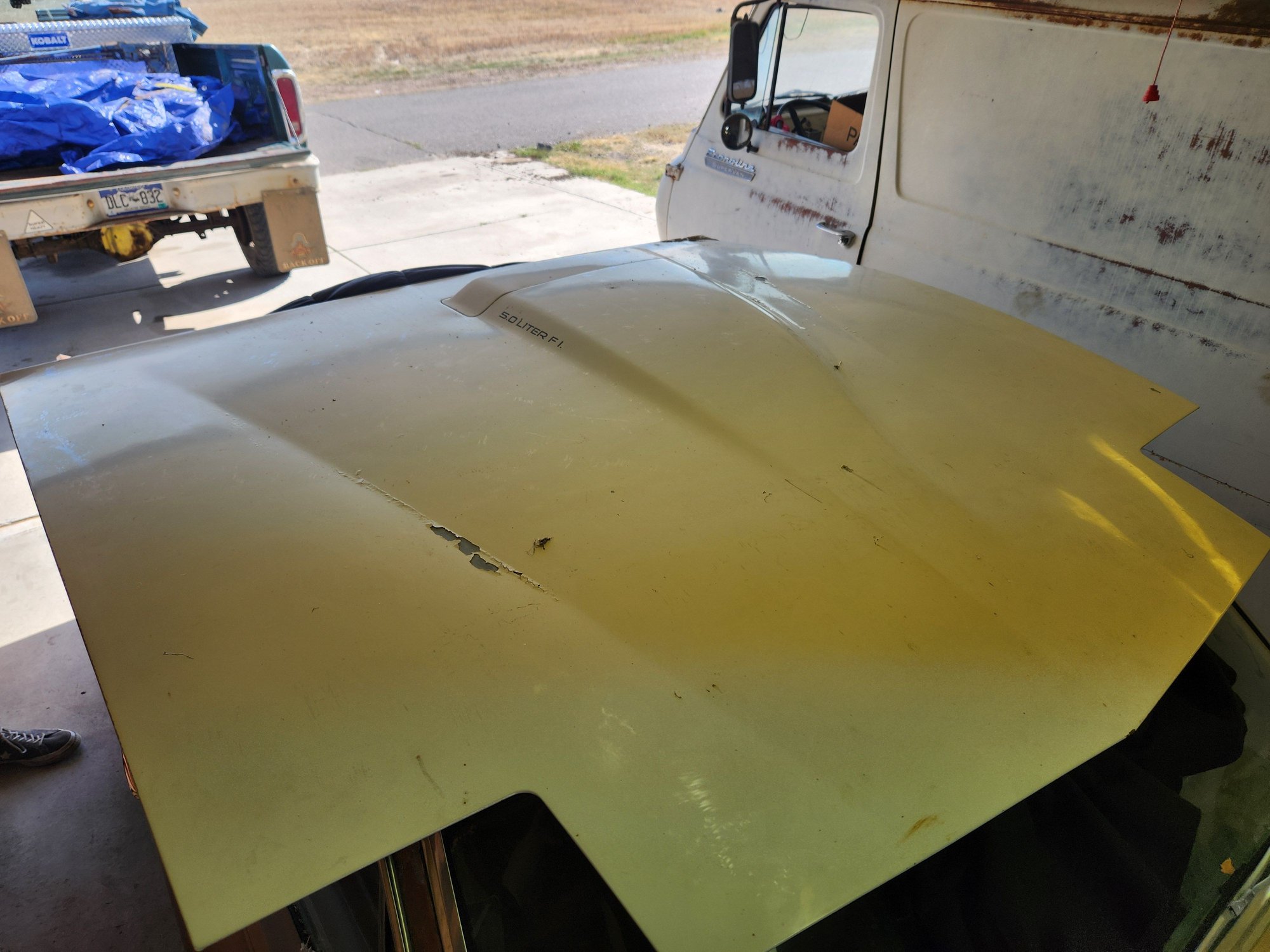

I spent these past few years looking for the correct Formula hood. I don't much care for the Trans Am style, and it's dented from hail damage anyway. Tried to buy 4 or 5 of these hoods, one time almost committing to driving 5 hours one way for a hood that was already the correct black. I found an old boy on a Formula facebook group who had one for sale an hour away. I struck up a deal and left it at my buddy's house who was just 5 mins away from the seller.
Once I rent a truck to bring it the hour home with, getting this hood ready for paint will be my winter project.

4 hours of sanding by hand later... this unit is almost ready for paint.
