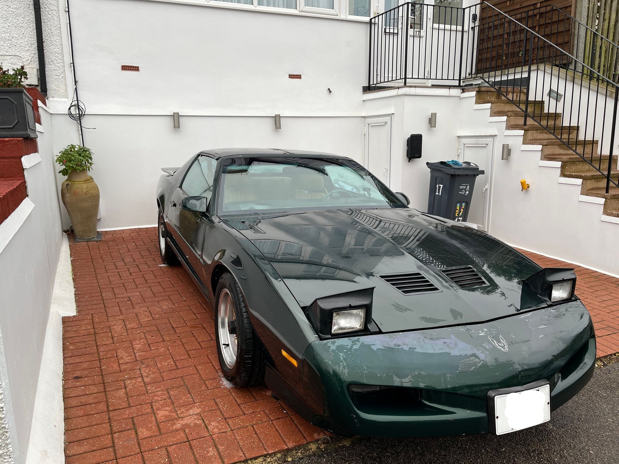

Fellow thirdgenners!
after purchasing a basket case of a trans am in 2016, whose exhaust fell off on the journey home and that soon had a head gasket failure in 2017 on its second track day under my ownership, this car has (and still is) been a work in progress since, but after a fairly trouble free spring drive today with the t-tops off, I thought it enough of a benchmark to post on here. Firstly big thanks to the thirdgen board, its vast posts and those that keep the boards alive today and have answered my queries over the years; has been invaluable for a novice mechanic in the UK to help build and troubleshoot my car into what is now fun and reliable thirdgen
The Car as I bought it
91 305 T5 Trans Am WS6, R6P with t-tops and drum (!) rear brakes. Overall a well used TA with 110k miles or so on it but still fun. It never idled well and after lots of ill directed novice trouble shooting (various service items, injectors etc.) it finally went out in a plume of coolant smoke on the bedford autodrome GT circuit in mid 2017. I was actually happy with the performance of the 305 but with the unequivocal sentiment of a 350 being better in every way, plans started to brew after not touching it for about a year. I also managed a best of high 16s in the quarter mile when it was running which i appreciate was mostly due to a dying engine and unprepped surface (and yep, me)
The Car now
i'll save the intervening years of man maths rationalising ordering a crate L31 Goodwrench (remember when these could be had for around $1,900!), the various rookie mistakes for a first timer putting in a cam, springs (got pretty proficient with the rope trick) and an intake together. And the many months trouble shooting a high idle (TPI to LS1 IAC wired back to front!), a suspension knocking noise (that had a jack slip and ding the oil pan enough that I had to replace it -still shudder at that one), and various other teething issues that probably took about a year of fettling to work through. Luckily I have an amazing partner and v understanding parents (where the car is kept) and am delusional enough not to add up all the receipts...

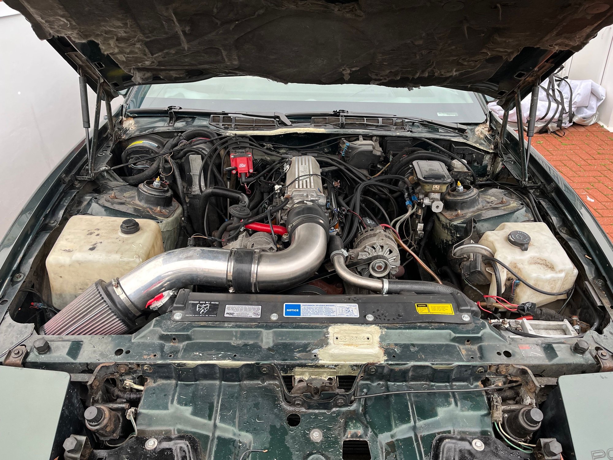

  • Edelbrock Pro Flo XT intake- unported (sidebar with my stock rubber engine mounts, this cleared the firebird hood just fine). Running an extra coolant line from the water pump (bypass mod)
  • 30lb Bosch injectors from southbay-boy do these 'tick'. AEM or similar AFPR
  • EBL P4 Flash and LC2 wideband - I'm running open loop currently fyi
  • Stock LS1 TB and my 4" toilet pipe intake going to a K&N
  • Same hedman headers and y-pipe but cut off the 2 1/2 merge and replaced with a 3 inch pipe. Frankenstein exhaust thereafter comprising a manga flow cat and back box, with a 2 3/4 intermediate pipe and 2 1/4 rear turn down pipes. Exhaust are stupid expensive to ship so this was cobbled over the years and as parts came up in the UK or shipping was exceptionally reasonable. At my power levels I don't think the exhaust is materially hurting me

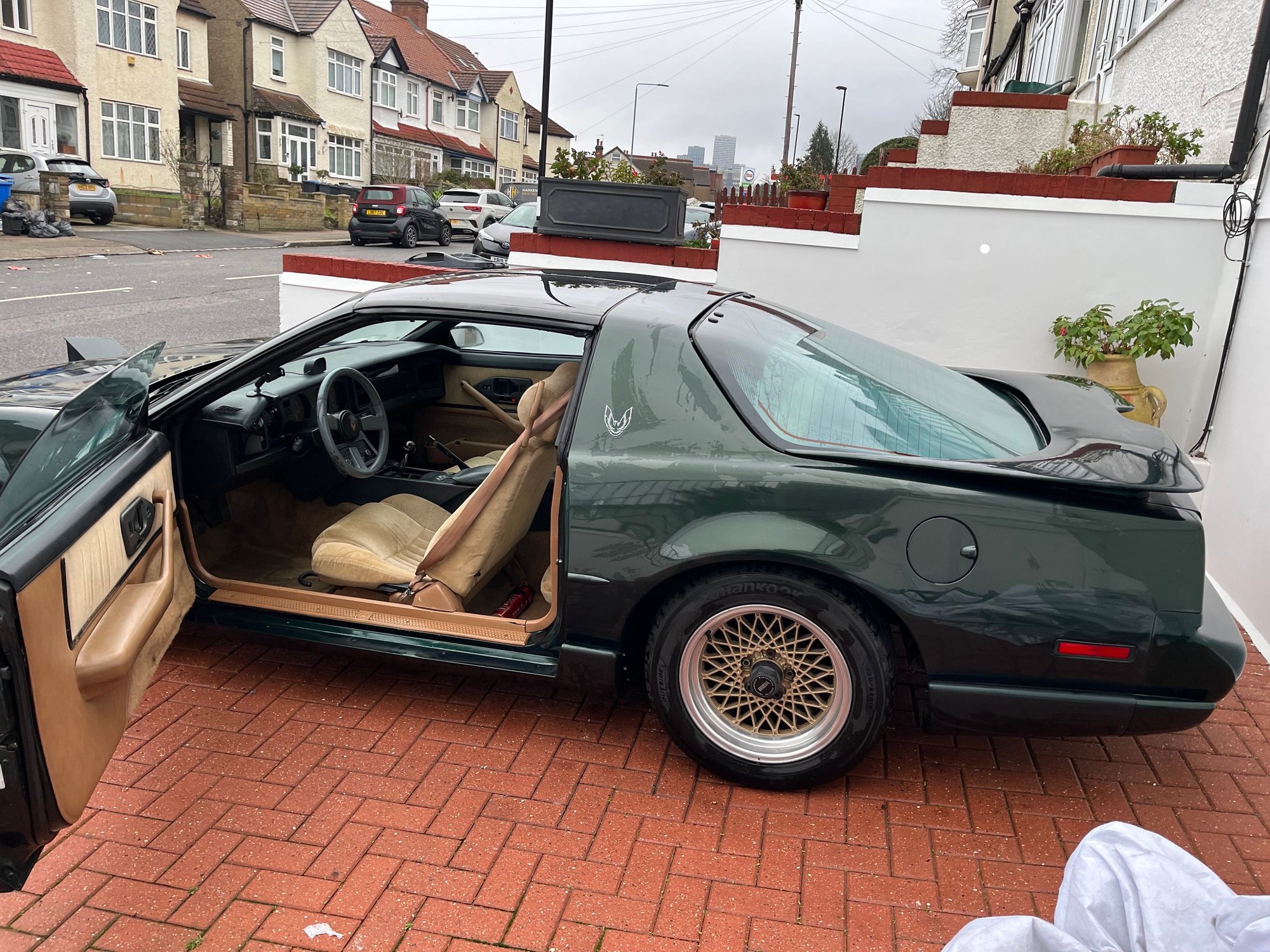

  • Stock wheels that I painted in the GTA gold! Were originally black and tired I? Running 225/55/16 tyres due no availability of the stock 245 size in the UK.
Misc.
  • Earlier Firebird/ Fiero steering wheel
  • 'trans am' script on rear bumper just about to be replaced with trans am written in Punjabi (I'm of north indian heritage) - having a bit of fun with that

Nice T/A! It's has to be no small challenge to build one of these cars outside of the U.S.

Hard to tell from the pics, but is your intake made from PVC, or just painted white?

Indeed it is. My partner is not impressed, mentioning the thermal qualities of PVC. I’ve got some aluminium and ss piping on order

PVC is not good with engine bay temps. I would highly suggest replacing that very soon. Other than that, you have done a very nice job with the build. Keep it up.

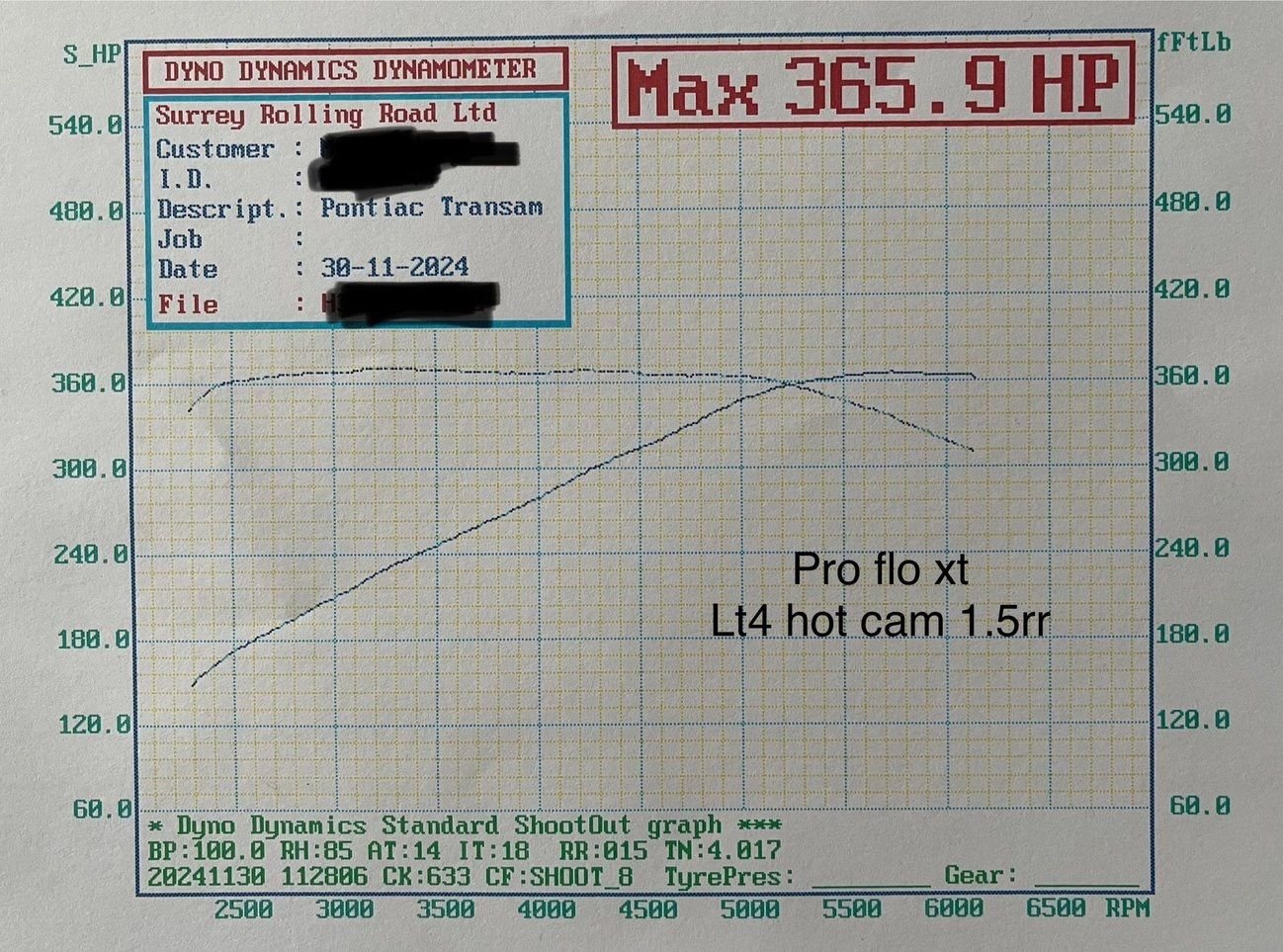

per a post in the general engine section, took the car to the dyno recently; chart below together with some freshly washed pics as I put it into hibernation. Has been a pretty eventful year with the car!
