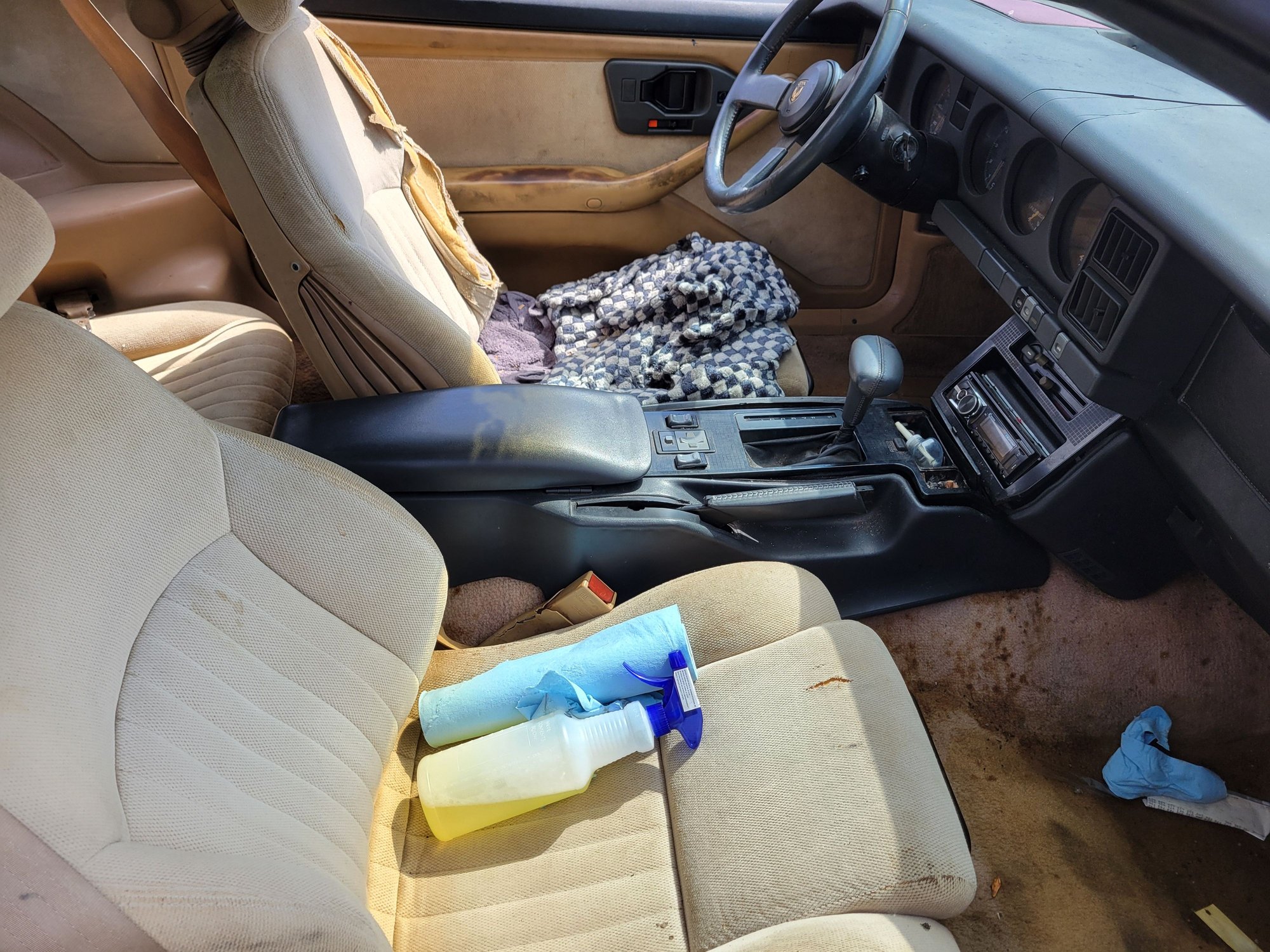

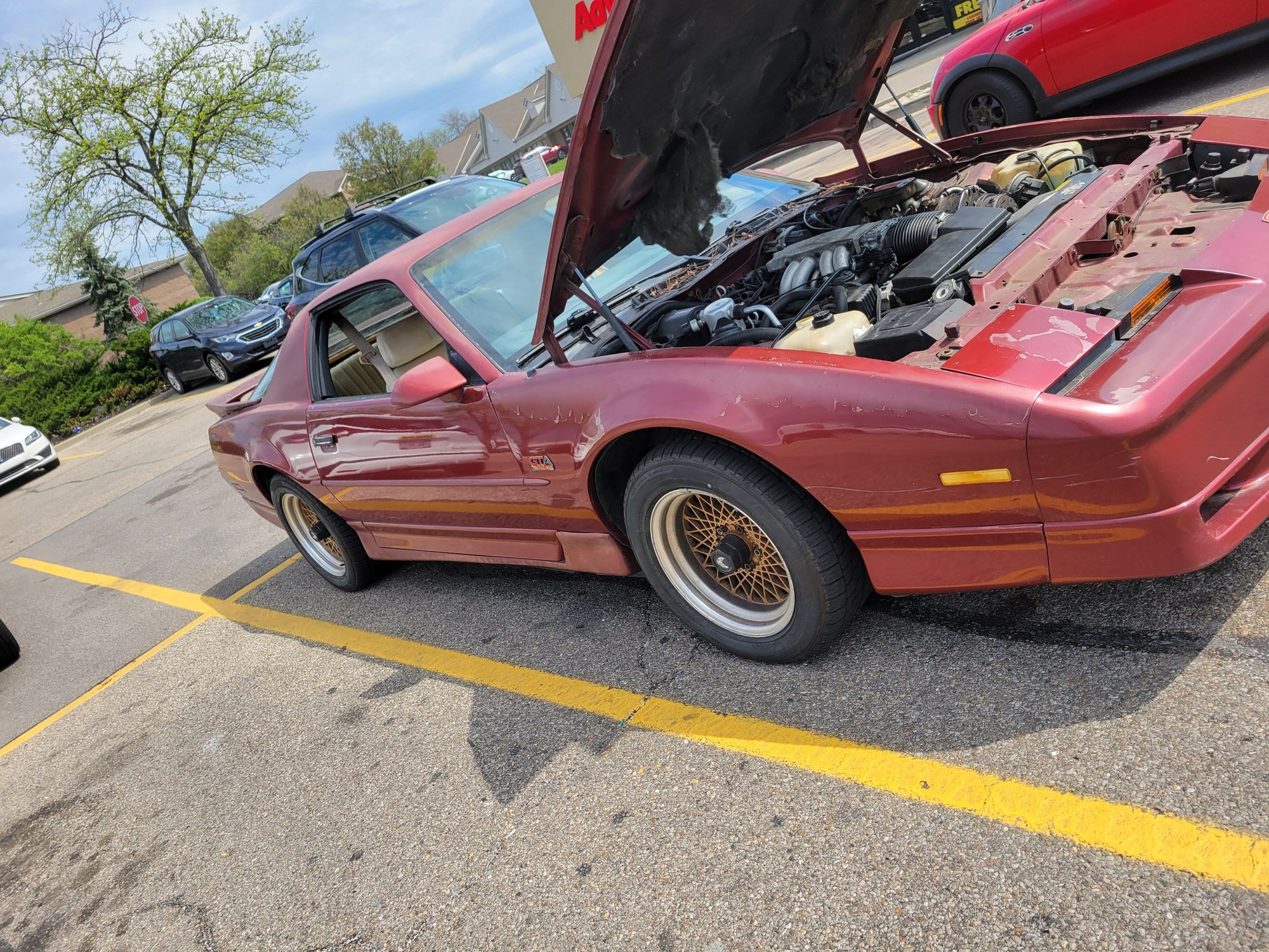

Hello all,
I'm new here. I couldn't find a specific area on this forum for build threads but noticed someone else had a restoration thread going on so I figured this might be the right spot.
So, where to begin?? As a kid, I had an 85 Camaro. It was a great car but I always liked the GTA trans am. So, one day shopping around for another project that I do not need I stumbled upon this car. It was rough in appearance but appeared to have reasonably good bones ad the price seemed decent. We drove 2 hours to take a look and made a deal and I drove it home. It might not have been as well represented as I had hoped so maybe not a smokin' deal but. It's mine now...

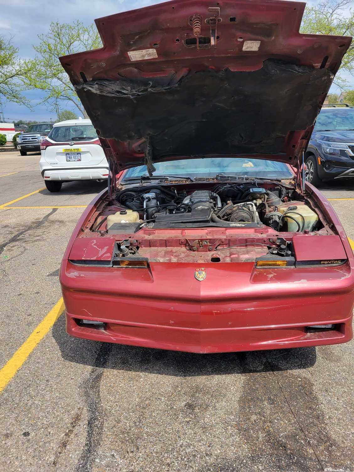

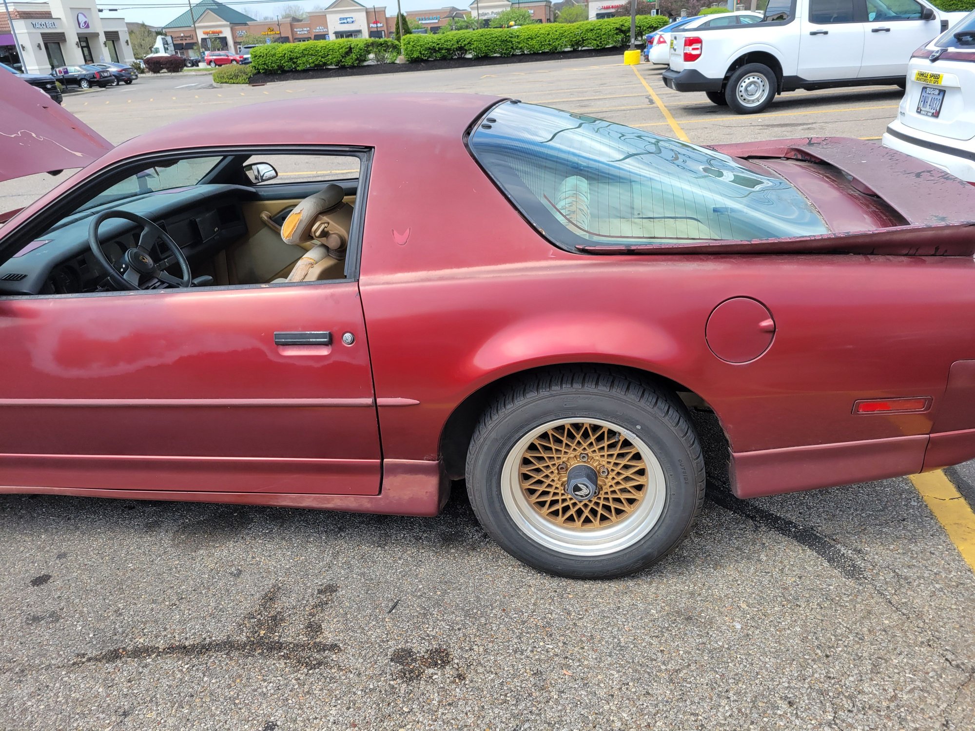

So the details- 87 GTA, hardtop, 5.7L, light saddle interior, Y84r, WS6, G80... The claim was 121k- yet the odo is broken so yea...
Body is straight, wheels are original, interior was wrecked, some small rust bubbles.

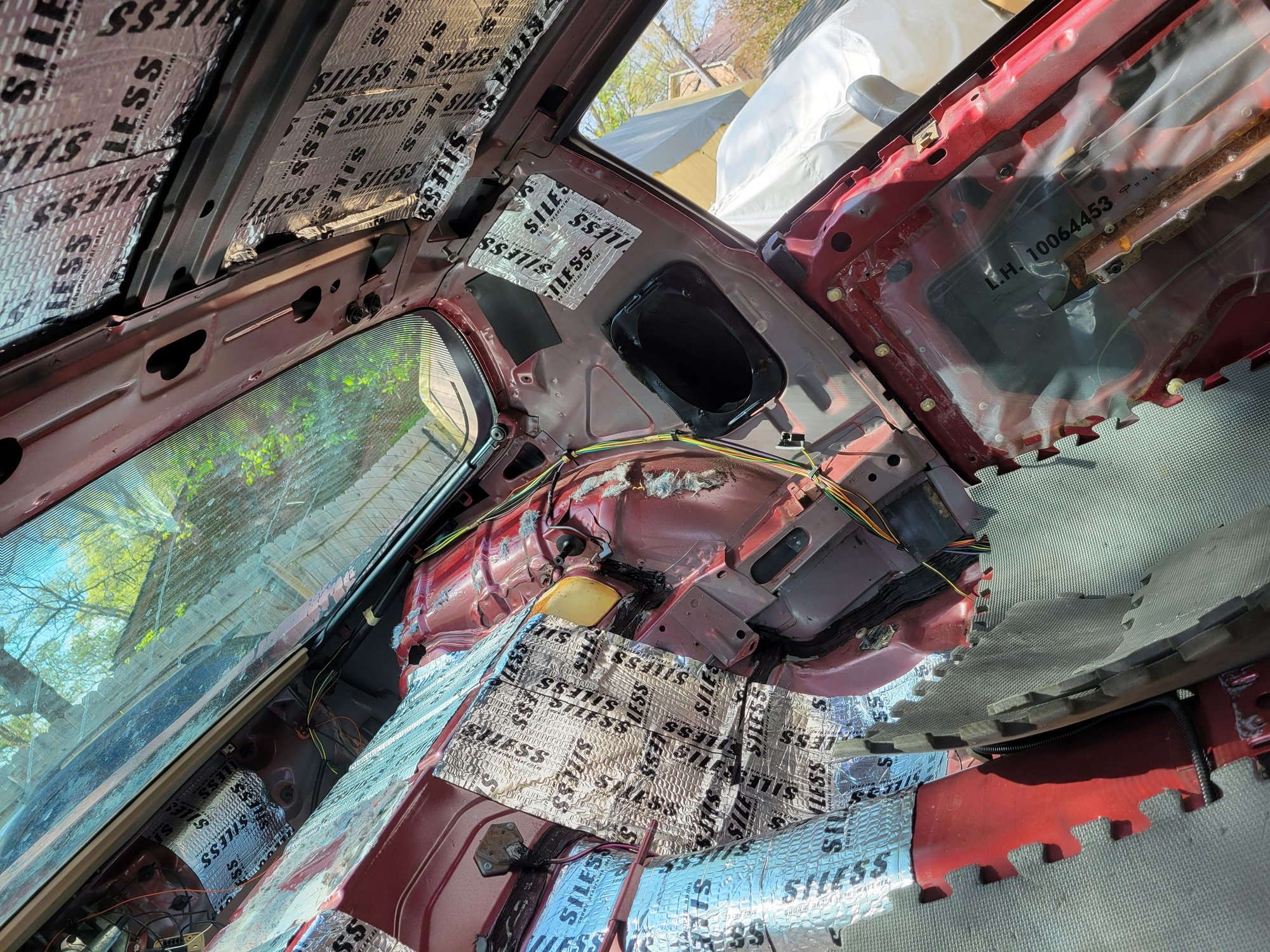

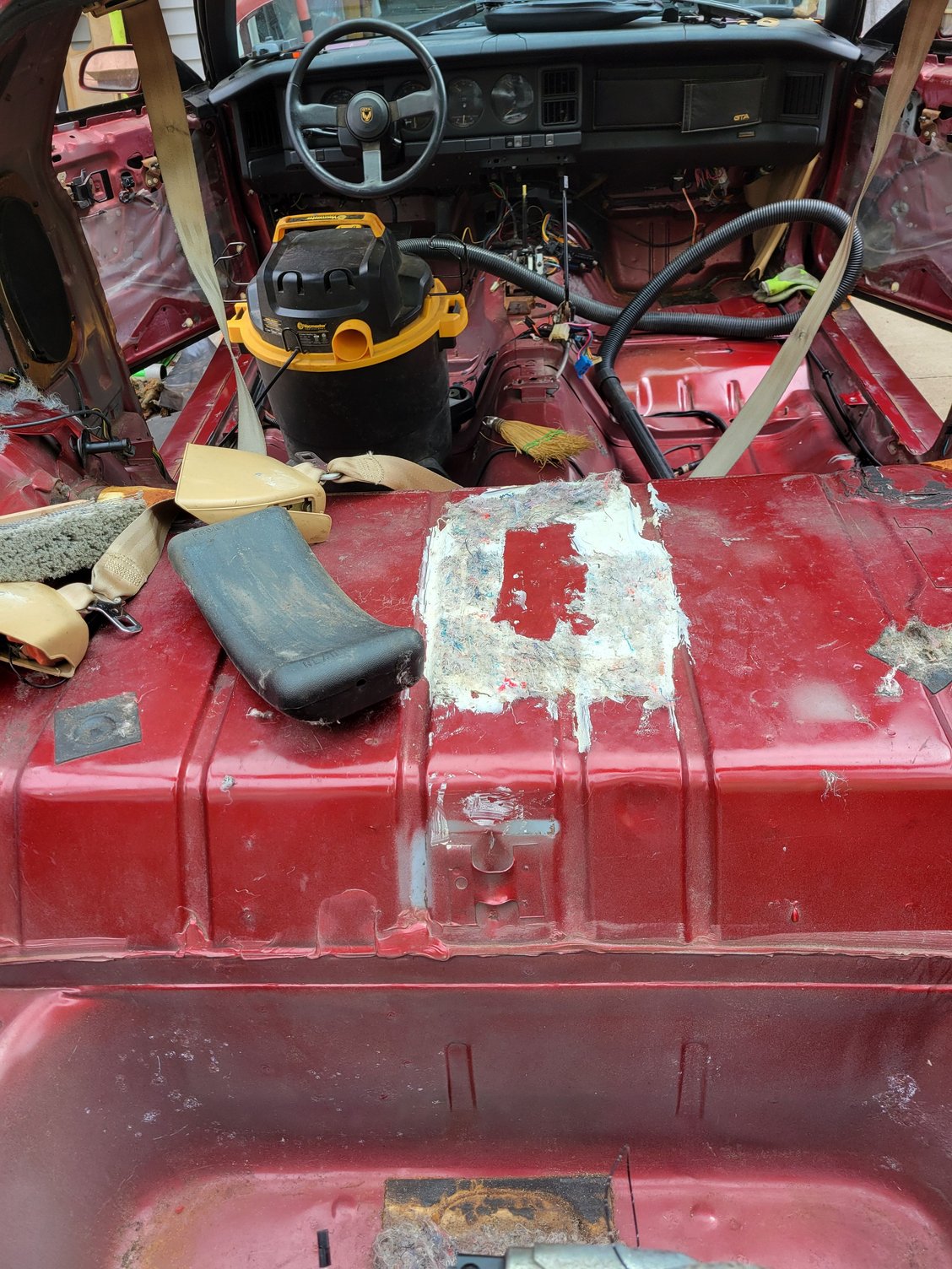

Car drove fine except for all the wandering on the road. 40 year old neglected car. What do you expect. Trans shifted firmly- felt like it might have a shift kit. Engine was smooth except when it wanted to sputter and die at idle. (which was around 500rpm), Gauges told me I had 60 psi of oil at nearly all times and the temp said I was at 220 most of the way. I've read that these gauges are not very good so, likely the issue. Also, noticed that the I couldn't fill the fuel tank without it kicking off. Lights work, power truck lid works as well as it's release, power windows work slowly (don't they all), the mirrors work, door locks work. Even has the original spare and jack, and all new tires So, not all bad.

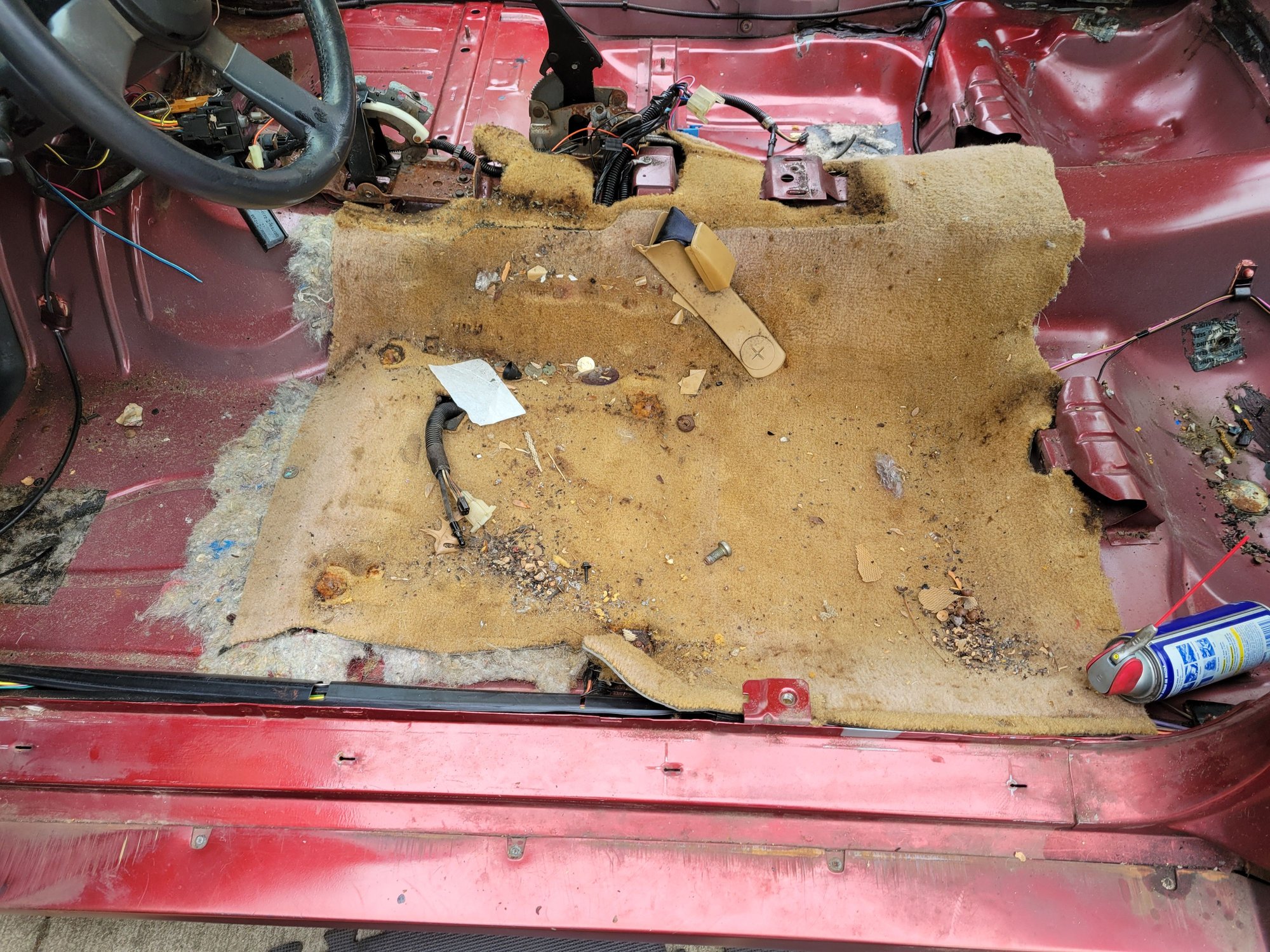

Got the car home and started cleaning but it was simply too much nastiness so the entire interior came out. Lots of mouse houses, and even a dead bird under the back seat- literally feathers and bones... We cut the carpet to pieces and pulled all the plastics. The front driver's seat was stuck in position and we could not get the one of the bolts loose without significant time spent fighting. Finally got it off and discovered that the track had a deteriorated CVS bag jammed inside. It took a while of fishing but I got it all out. Lubed it and now it moves...
Cleaned and disinfected the interior and discovered a few more rusty bits than anticipated. A couple holes under the the front of the car where it appears a jack might have slipped of a pinch weld and some rot out back in the spare tire well, hidden by the cladding.
I didn't think much of it until I discovered that there aren't body panels for these cars... WTF??? Then the issue with sourcing matching interior pieces?? I thought these cars were popular! Ugh. Oh well...

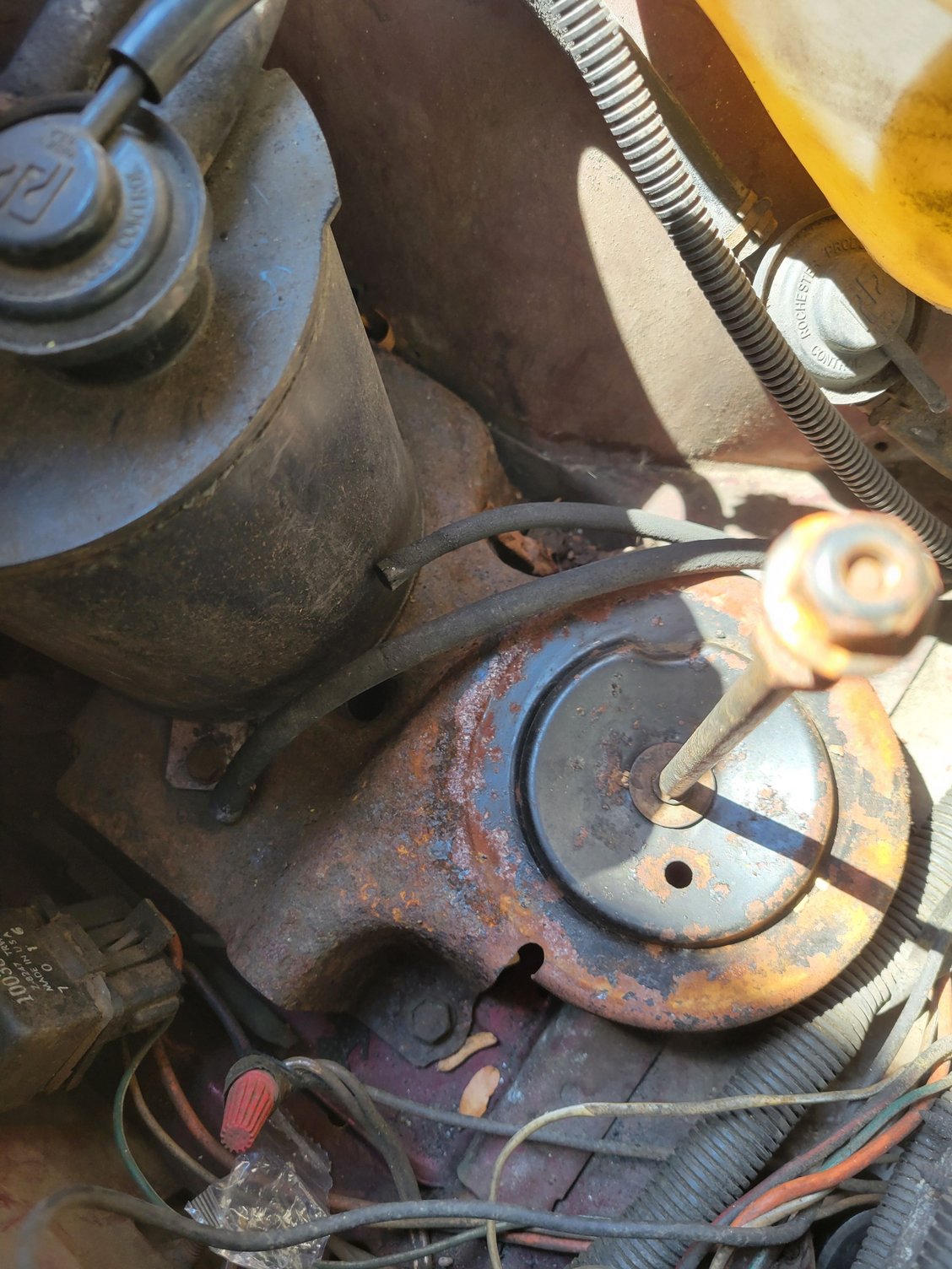

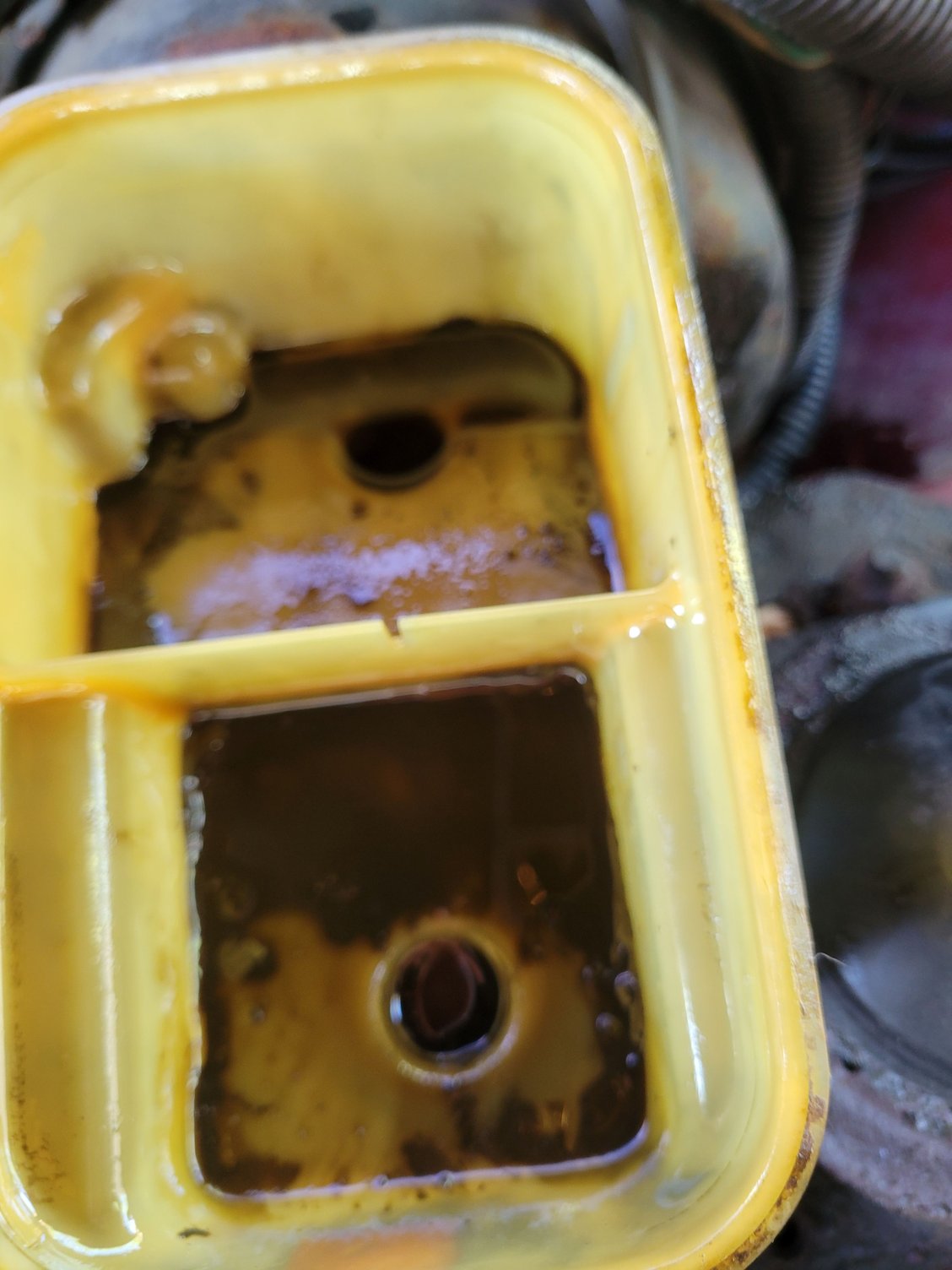

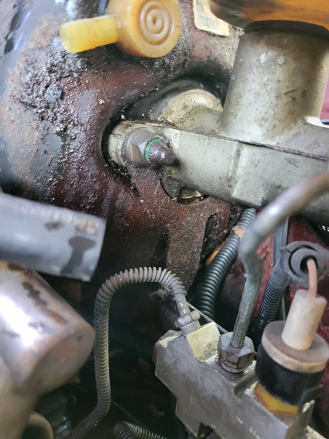

So once stripped and cleaned, I turned to the master cylinder as it was leaking. I painted it to prevent rusty appearance and did the booster as well. I'll be going through things little by little to make the car road worthy-er.

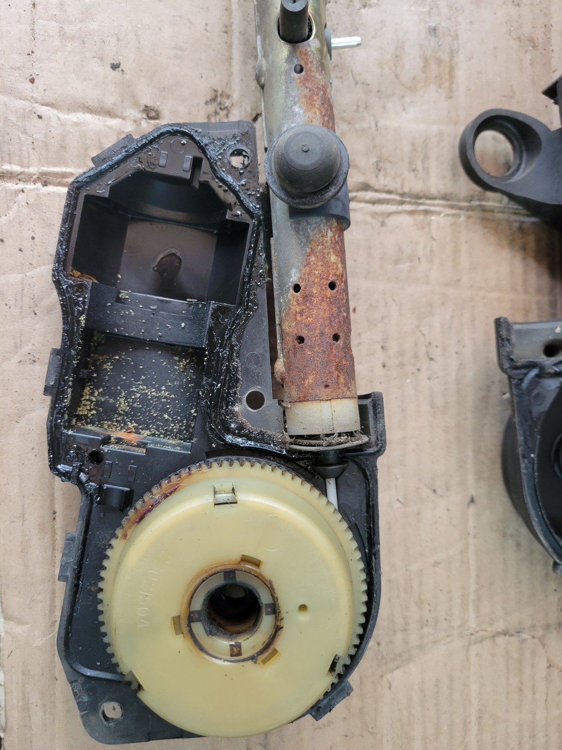

Lots of odds and ends to sort through. Console is being repaired. Rear view mirror the auto dimming one has been dismantled and cleaned, Since I am trying to do several things at once, we also pulled the dash pad to be recovered, (headliner was already missing), and put some sound deadener down to keep us moving in the right direction.

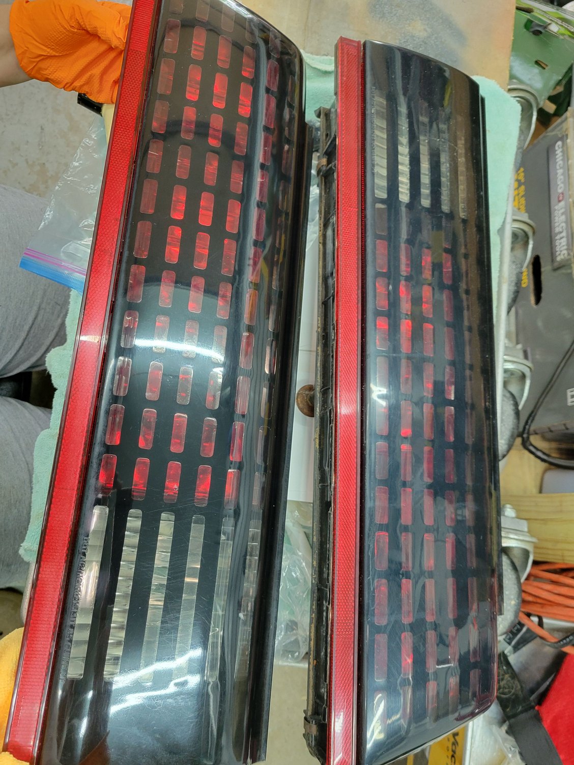

A few more pics

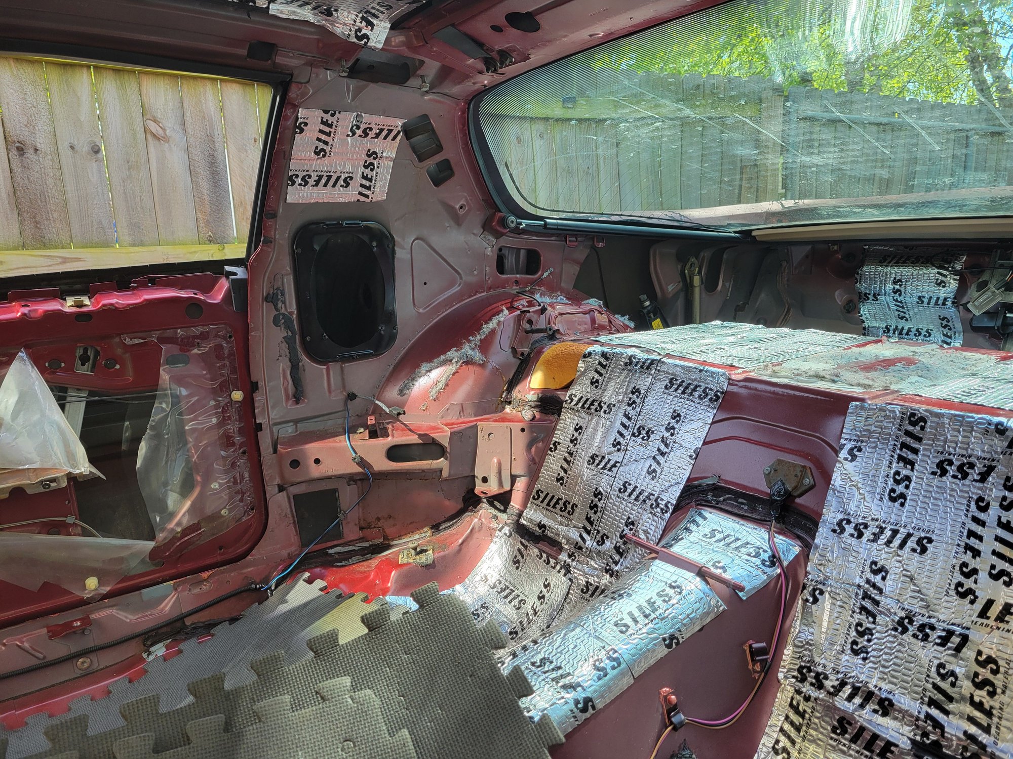

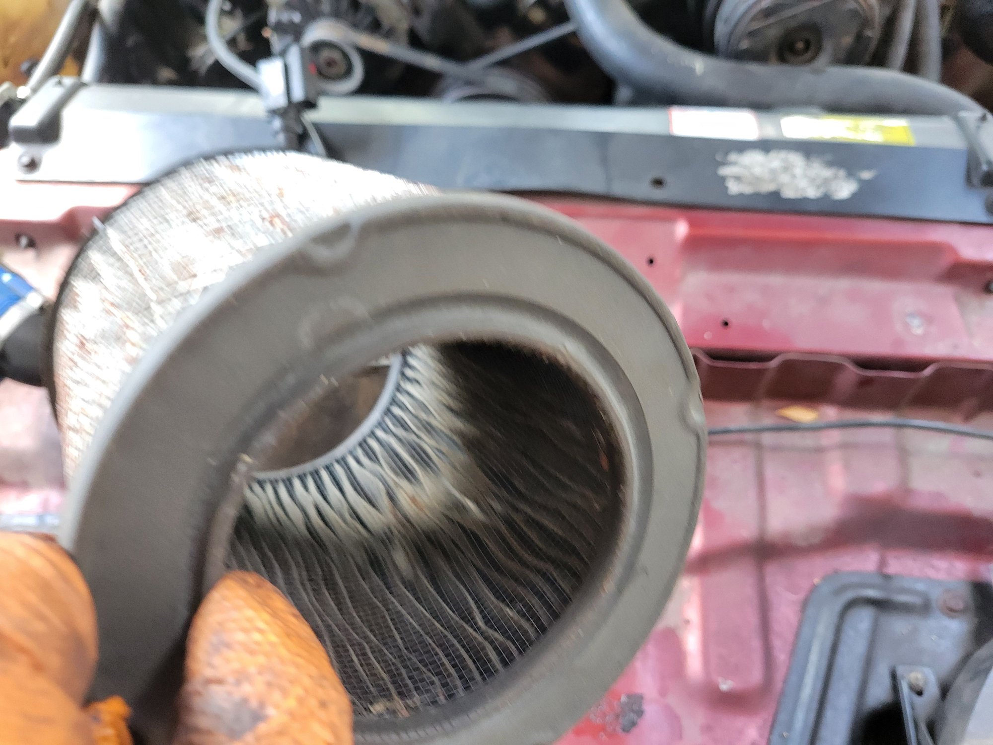

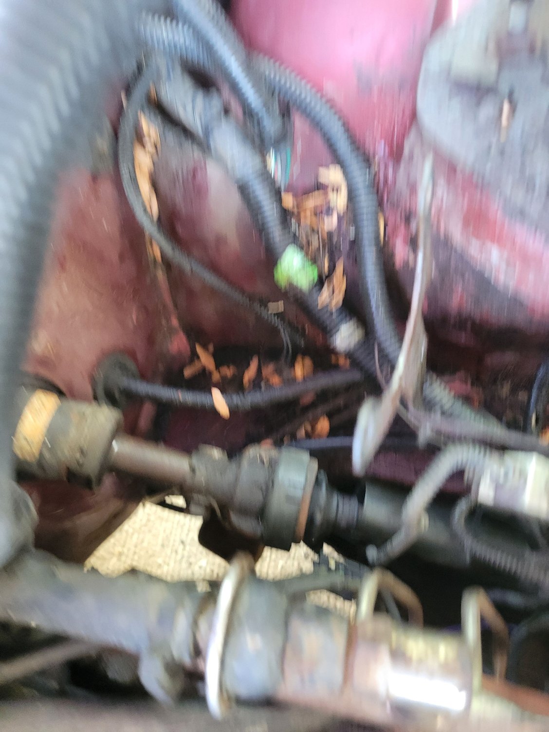

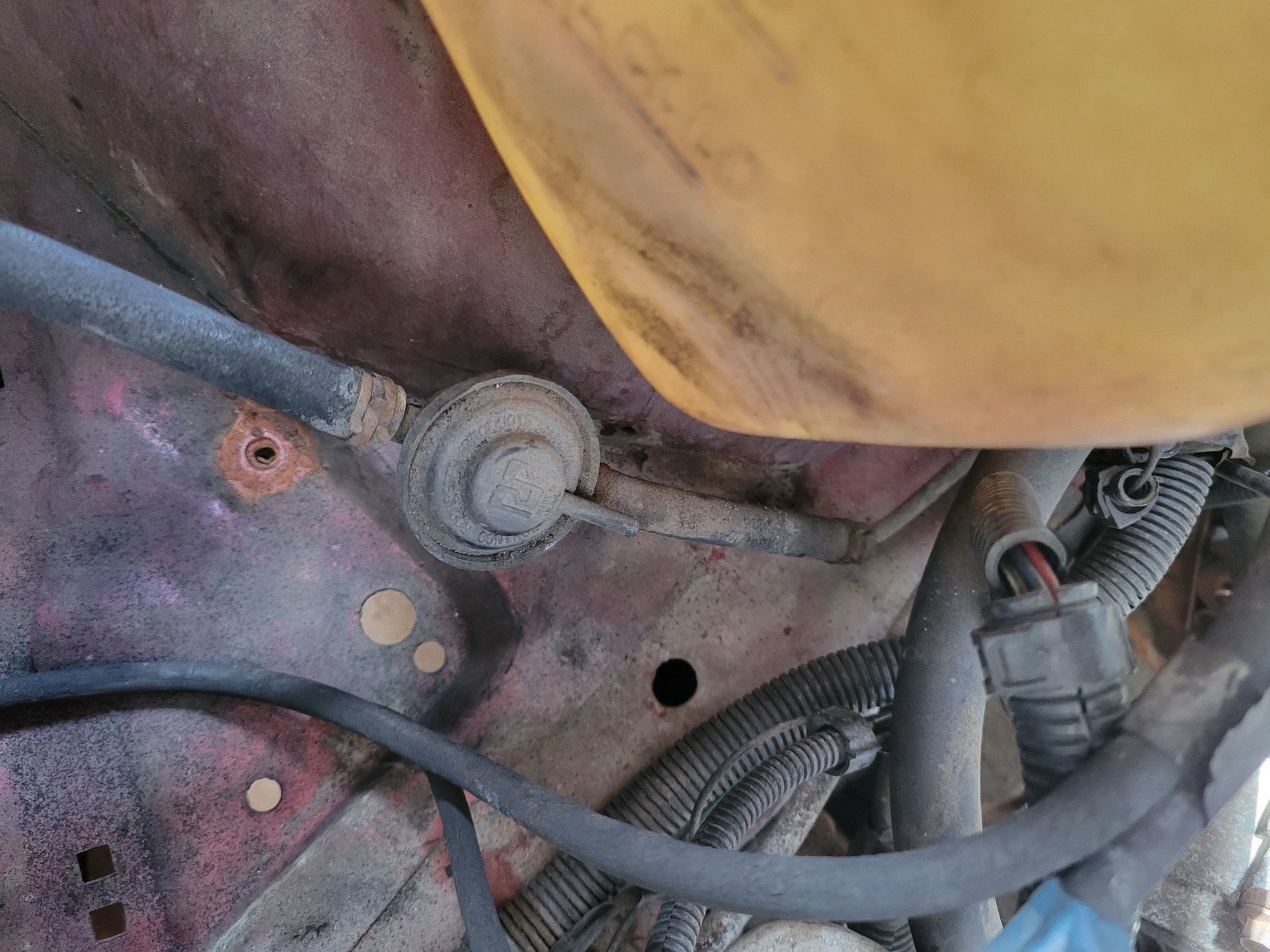

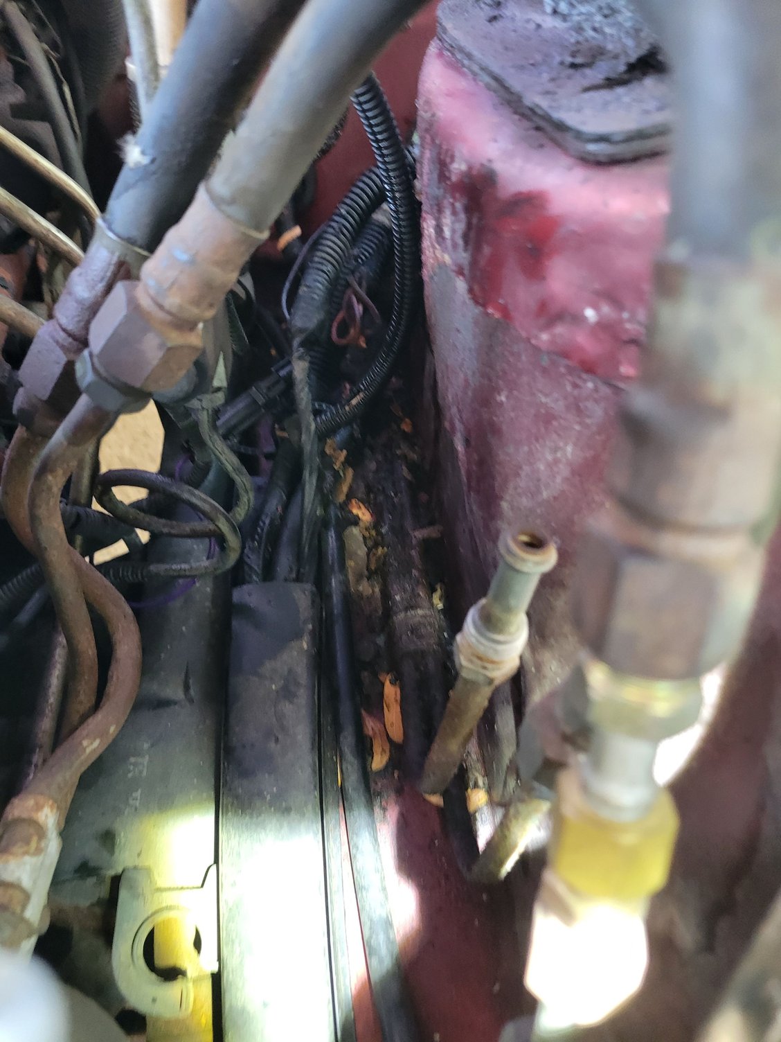

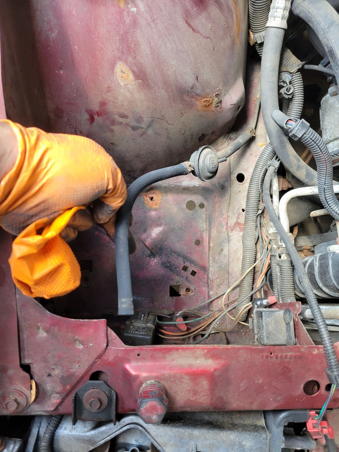

The sound deadener was just placed in the spots seen and the trunk. I have more coming in order to do the doors and the floors- after we figure out what we are doing with the rust.
While we wait on that, we have a few pieces on order- fuel tank vent valve, trans rear seal, new filer and gasket for trans, new rear diff fluid, fresh oil and filter, steering pieces, etc.
If you noticed the fuel hard lines look rougher than a night in jail so they have to be replaced. Maybe the brake lines too. Still need to figure that out.

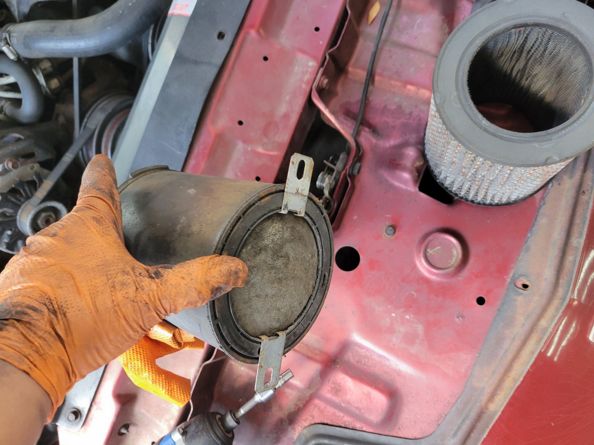

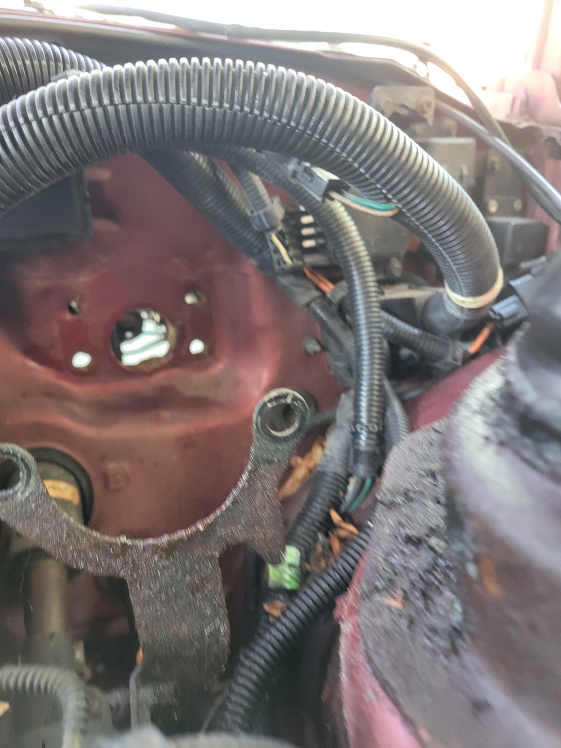

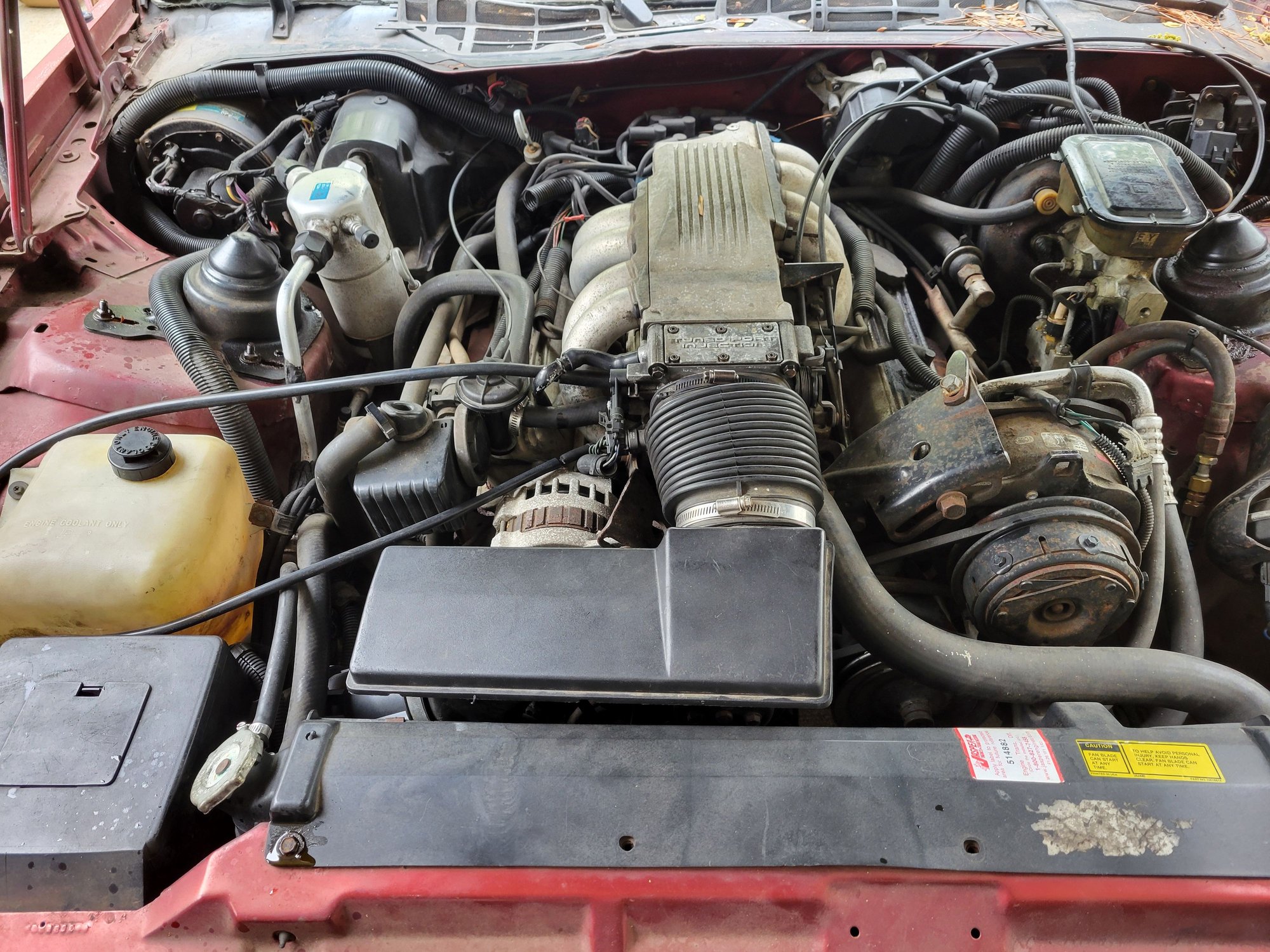

When I removed the air box and charcoal canister I found some "custom wiring to some sensors that was done with speaker wire and wire nuts- Can't make this stuff up. Maybe someone can point me to what I need to fix this mess properly. Also need to figure out vacuum line routing as most were rotten and many disconnected.

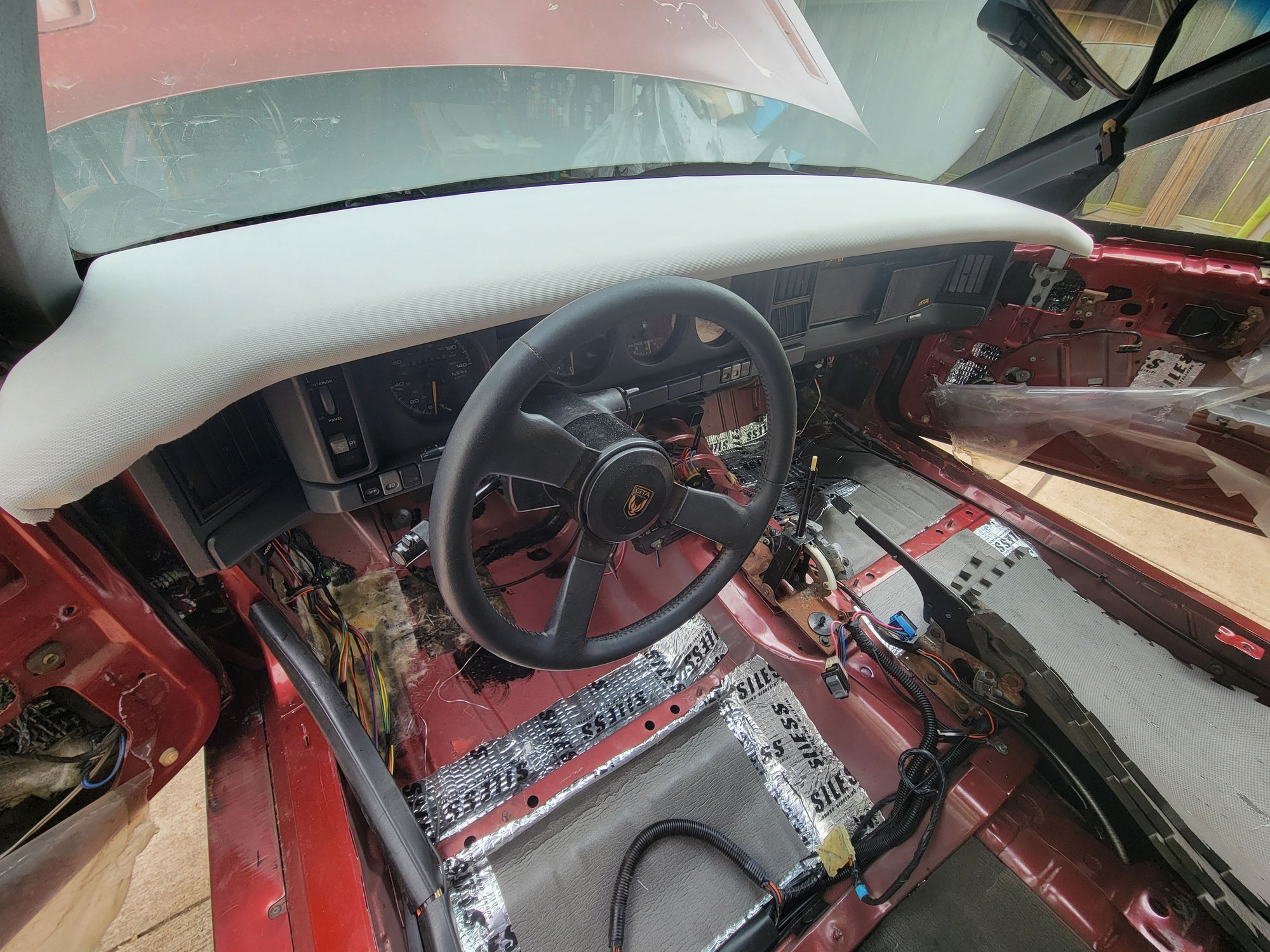

A couple updates:
I think we're going to pull the dash-maybe just enough to remove the rest of the sound deadener. Wife says under the dash smells like R. Kelly's sheets- pissssss. (funny song reference)
Anyway, we'll clean all that and put some new sound material and while we're down there probably take a look at the heater core. While I don't think it was leaking, there seemed to be some dampness on the pass/firewall sound material which I think could be coming from the fender area- I had an 85 Camaro in the 90's and I recall the dealer putting a bunch of silicone somewhere around the antenna area to stop some leak I kept getting on the floor. Anyway, it's worth a look while I'm there.

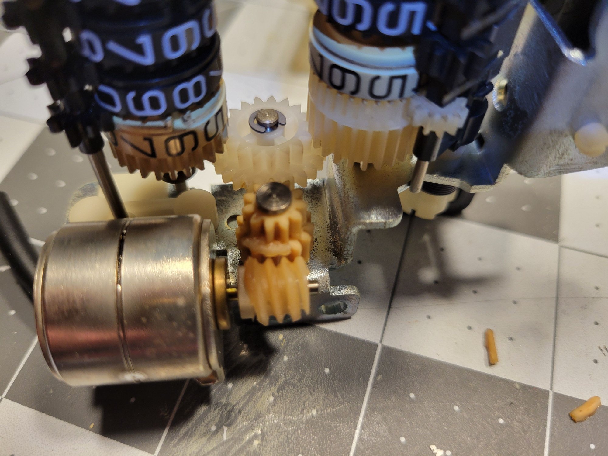

Also, just ordered the Odometer gear repair kit as the odo stopped at 121k and this car has much more than that.
Interestingly, I discovered (after looking at the supplied paperwork that the engine was replaced in 2005 with the car having only 97k on it. This seems like a car someone was just using as a fun car on the weekends (around 5400 miles a year) so, if that was the case and they continued in that pattern the "new" engine would have something like 113k. The body like 210k. But for living its whole life in Ohio, there's not as much rust as one would expect from such high miles, so it is likely much less... Just trying to get an idea of what I'm working with.

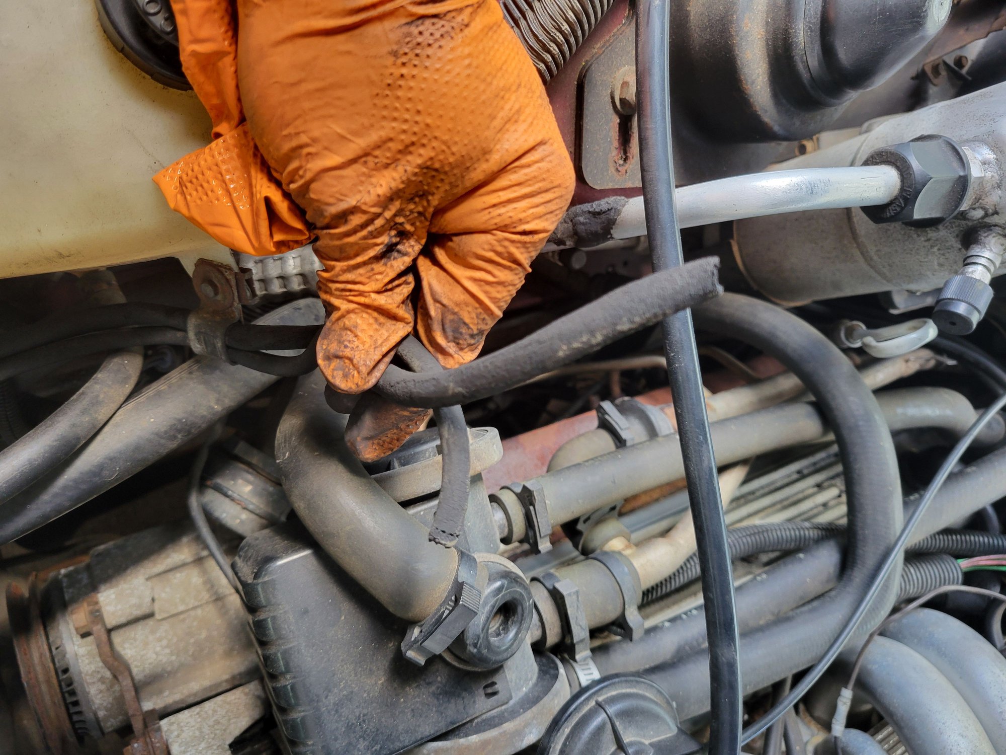

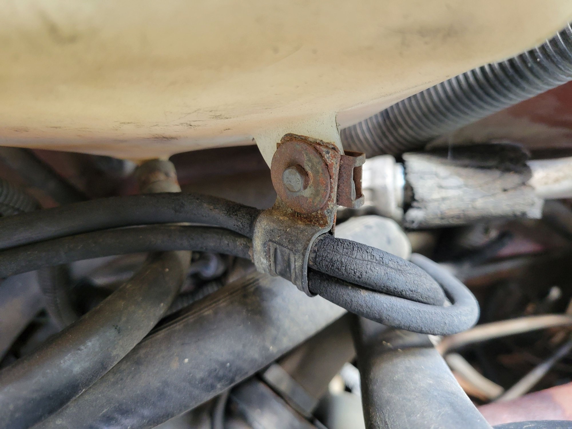

So, today I managed to remove the fuel tank vent valve. Had to cut the line. It was a mess. I have a new one to install maybe tomorrow. Also, removed the leaking trans tail shaft seal and installed a new one. What a PITA that torque arm is! I'm still fighting with it as I'm on jack stands and everything is a bit greasy-might jump under there tomorrow with degreaser and try to clean it up a bit before doing anything else...
Also, discovered the ECM has stock chip. No one has hacked any wiring or modded anything from what I can see. Once I get all the basics handled, this could be a blank slate...

Pulled and cleaned the dash gauge cluster, repaired the broken odometer and reinstalled. Then focused on grinding the rusty areas. For now just going to seal with POR and fiberglass everything. I'll do the proper metal work later when I have a lift.

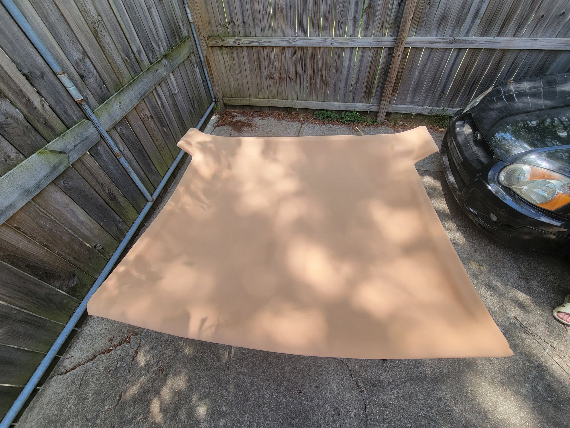

Had windshield removed and we cleaned and fixed everything underneath before having it reinstalled. Now it feels like the interior is finally as clean as it's going to get. We added some sound deadener and it's feeling and sounding way more solid and quiet. There's a few touch up spots that have been addressed as well.

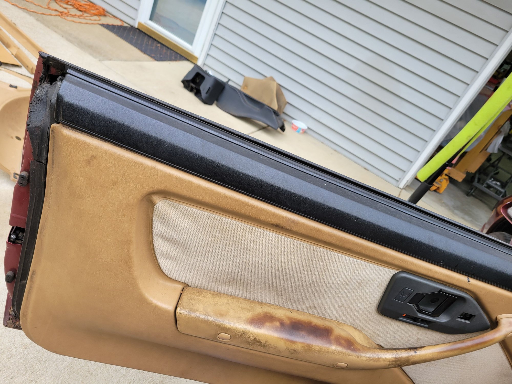

Since I am prone to doing too many things at once, we have the dash pad almost ready to be re-covered, the abs headliner covered and ready to install, the front seat frames torn down and ready for clean and paint, some odds and ends sourced, rear shocks installed, & tail lamps polished.
Still trying to get a good interior paint match for the light saddle. Also, going to try and rebuild the visors since we have extra headliner material so we will at least have some matching bits. Also, going to attempt to repair the wing out back.
In hand we have front struts, wonderbar, front end rebuild bits, filters and fluids and new carpet.

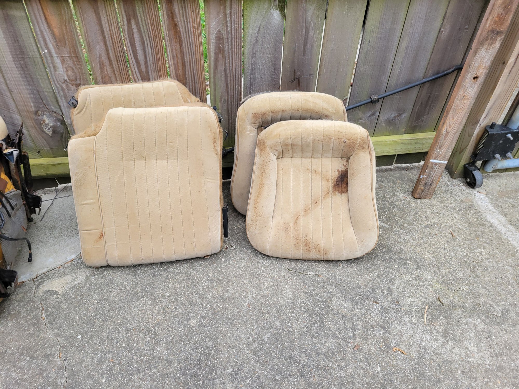

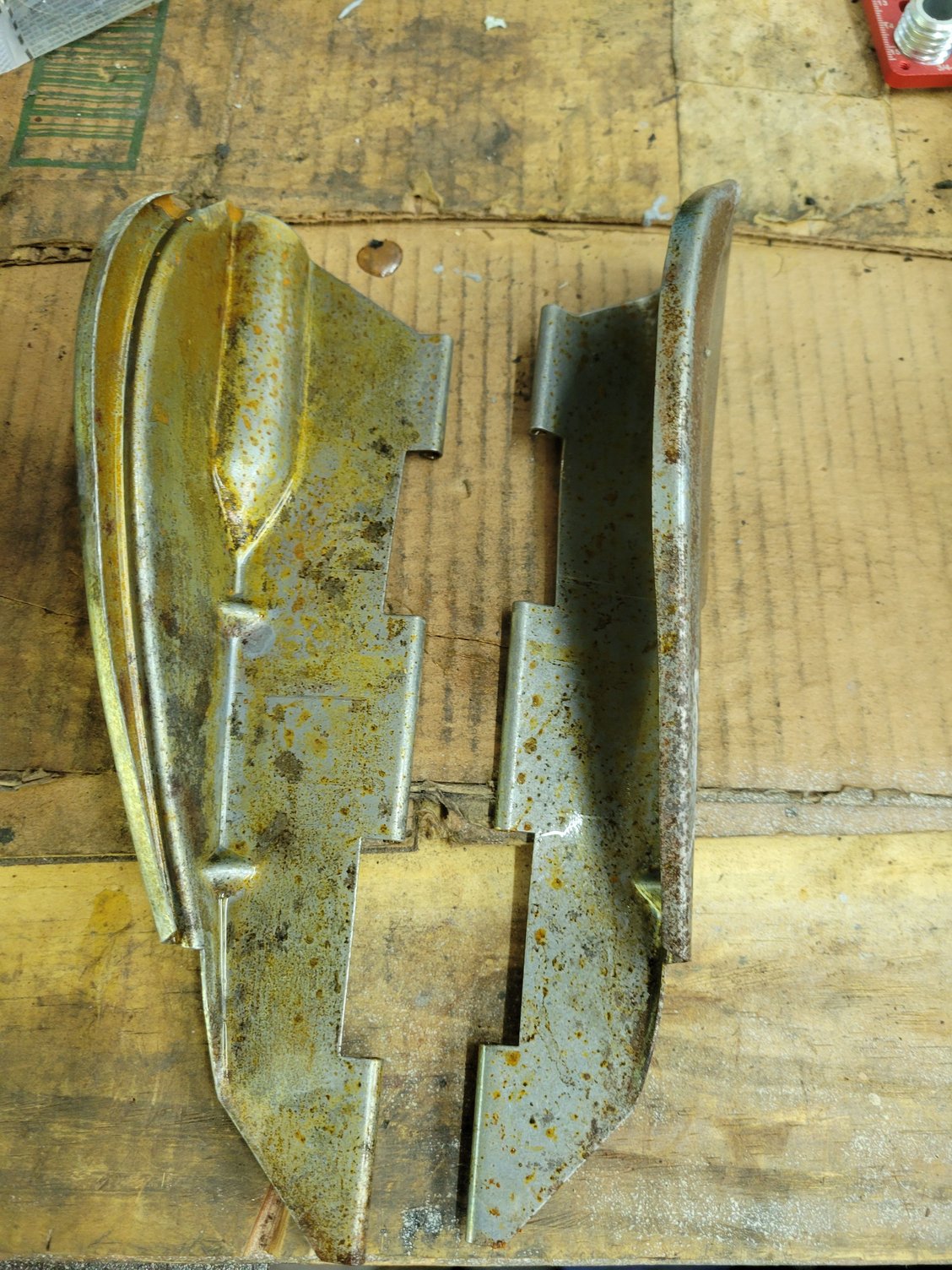

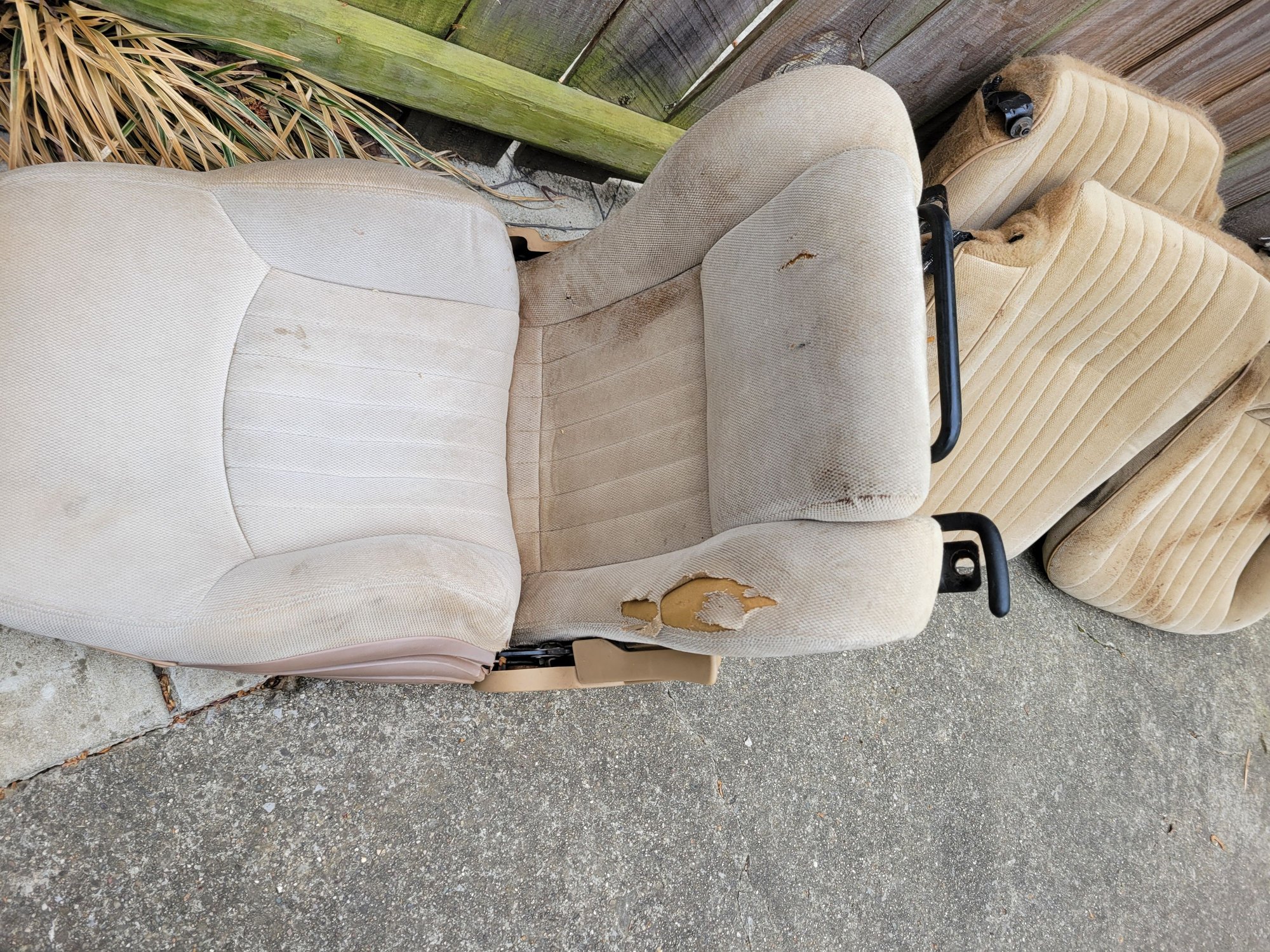

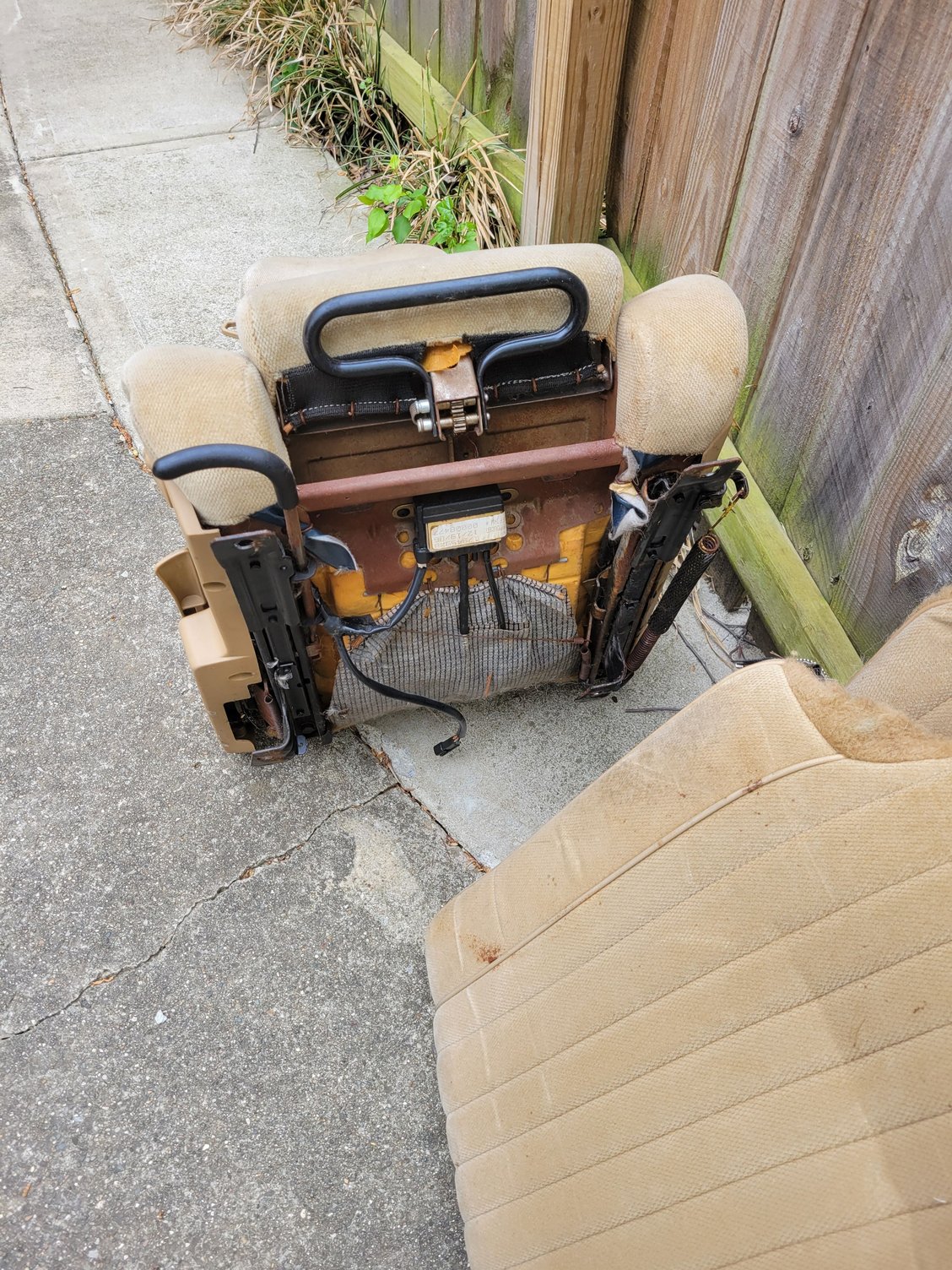

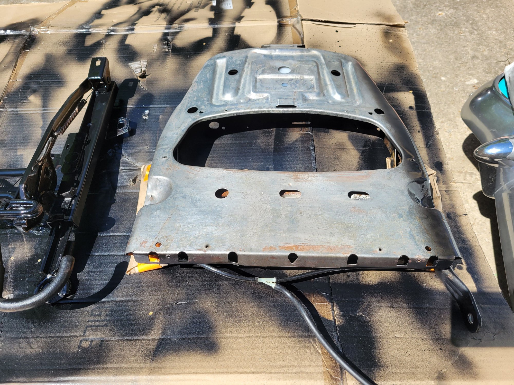

Today I was able to put my rust remover to work and go all the metal seat components cleaned and dried. Only some got painted as it was still chilly and the paint was not cooperating as quickly as I wanted. I'll try and wrap up the rest of the metal tomorrow. And I'll try and post some more pics.

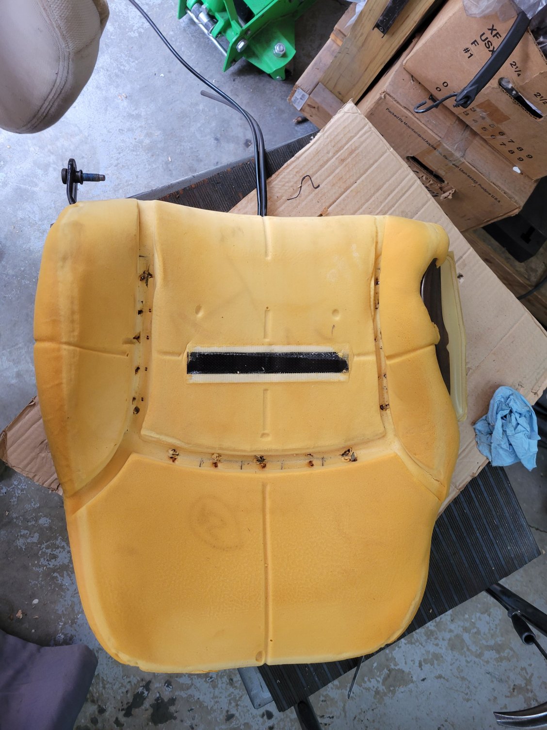

Now to fool with the deformed seat foams:

Master cylinder and booster pulled (master replaced)- still not reinstalled as I need space to address fuel lines

Not sure if I should make another thread on the AQ9 seat details or not. I have a bunch of pic and will post more once I get the upholstery.

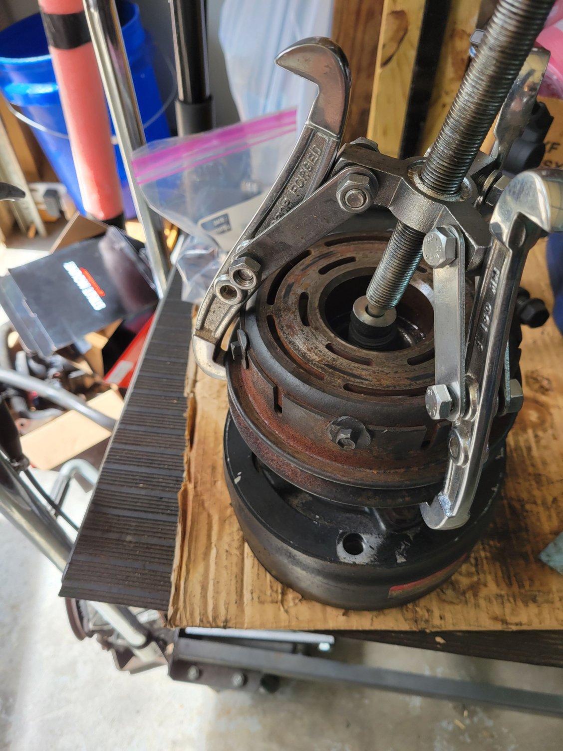

More updates: Discovered tophats/strut mount bearings were crunchy so ordered new stock style replacements. Contemplated big brake swap. Shelving that for later as we're really knee deep right now.
Also did some rust remediation on the deck lid. Sanded and skimmed the spots on top and underneath the deck lid so hope to have those ready for a quick touch up in the next few days.

I've been lazy with the pics so here's a few to catch us up a little:
Odometer
Reply 0

Antenna: I expected it would be non functioning so I pulled it to rebuild. Opened it up and it was fine! Lubed and reassembled and tested and it's smooth as butter. It was zip tied into it's spot.. Not sure what bracket is supposed to be there to hold this in place.

Headliner on abs panel. Covered the back of the panel with some more sound deadener. Also, forgot to test fit the center roof console so there was some serious cutting to do. I've not taken a pic of that. I try to take one later and add to this post.

The dash pad: This was cleaned and sanded to remove rough or high spots. Cracks opened up to give us more to work with. Some small cavity spray foam filled the cracks. Let it set for a few days and cut it down flush with a hack saw. Sanded everything and then went over the repairs with a very light skim coat of filler. Sanded again and cleaned. Attached scrim to give us a more plushy base to set the vinyl on. Test fitted and currently unfinished or trimmed. Need a few really hot days to make the vinyl super pliable. I'll cut out the vents and speakers later.
Reply 0

Quick tail light polish

Finally, pulled the seized air pump and mounting brackets. I'd like to remove that whole system without destroying it but it's likely that will need to wait till the engine is pulled. Not sure if or when that would happen. It just frees up so much more room for activities without all that crap in the way.

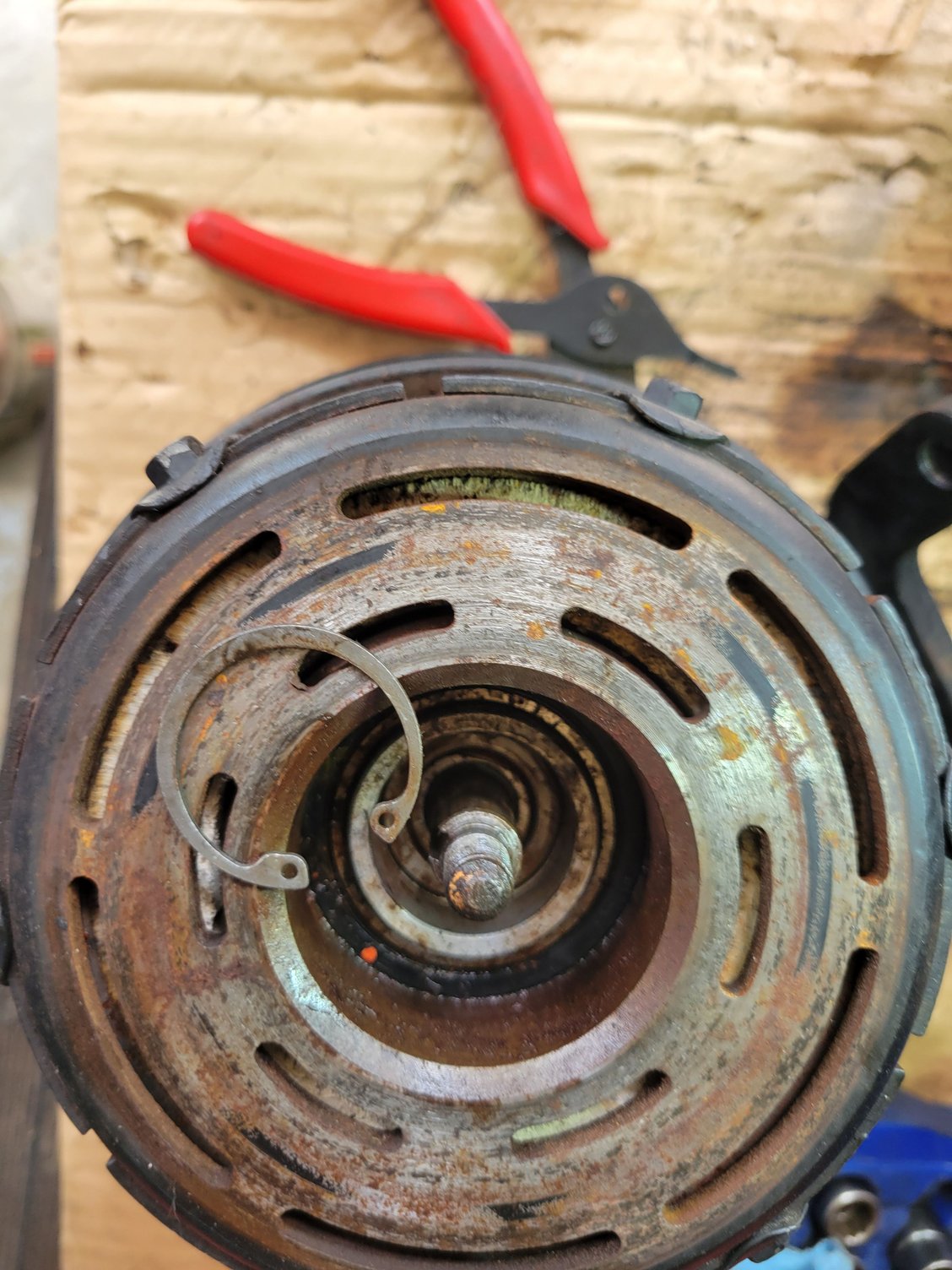

Pics and info for the R4 compressor: Tear down and inspection. The tool kit I used, the jig I made. main issue I ran into on this one was that the seals were really stuck so I added a bunch of penetrating oil and it finally came free. Interestingly, as tough as those seals were they were mostly flat.
