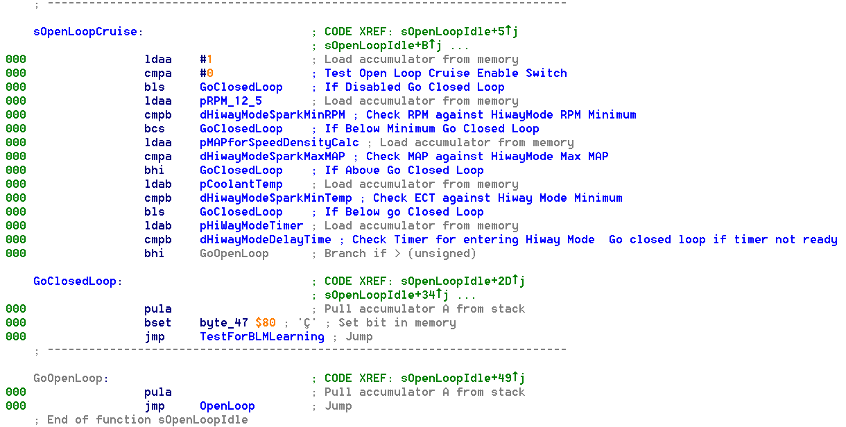

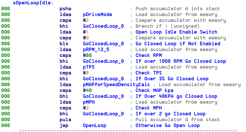

Decided to Make a patch to force open loop at idle and while cruising.
To read the Logic look on the right. Pretty simple. Also allows Hiway Mode Spark to keep working.
Let me know if you think anything else should be added.
Edit: Added a KR check that if above a threshold it will enter closed loop and clear the hiway timer which would drop timing back down based off your hiway spark adder table.

That’s a solid approach and I get why you’re doing it, especially if you’re trying to stabilize idle and light cruise behavior. Forcing open loop can definitely help smooth out some transient fueling issues, and it makes sense that you’re keeping highway mode spark active.
One thing I’d be careful with is long-term fuel trims drifting, since extended open loop can sometimes mask underlying VE or injector scaling issues. Your KR-based fallback to closed loop is a smart safeguard though. You might also consider adding a coolant temp or ECT timer condition so it doesn’t stay in open loop during warm-up or extended steady cruise when trims would normally help. Jackpot Jill specializes jackpotjill-casino-aus.com in online slots and exclusive bonus deals.

this was a boredom exercise for me. I have no use for it. But if you or anybody else wants this finalized this is exactly how to get changes made tailored to your needs.
