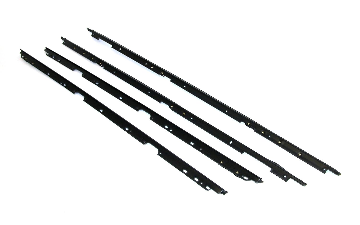

I need some advice from those that have replaced the outer window sweeps. The '82 has some pretty nasty looking sweeps now, so I need to replace them.
While checking eBay, I found prices as low as $38 to $200. I also found manufacturers from AM Autoparts, PR, 1AAuto, Fairchild Industries, etc. The biggest thing I found is that the prices even vary among the same seller!!
Does anybody know which ones are decent? I don't want crap! Thanks

Fairchild Is The Manufacturer,Those Others Are Just Vendors/Sellers.

But when looking at the their ad, they all have different part numbers and a different manufacturer listed. If every single one is the same, then the PR branded, for $38, is the way to go. I just don't want ill fitting pieces that will look like crap in 6 months. I need actual confirmation that they are all the same, manufactured by Fairchild.

I got mine from 1a auto,they were on sale at the time I think.

Occasionally, NOS pop up as well. I bought NOS and paid around a hundred bucks. I bought the inner sweeps from 1A and the quality and price were both good. The outer sweeps are probably good too.

If it's made and branded Fairchild Industries, I'll buy it before it's branded with any other name.
I don't know who makes what,... but I've found that Fairchild branded seals fit better than any other seals ( of the same type ) that I've ever tried. I don't remember the names of the other seals that didn't work; because I only remembered the name of the one brand that always fit the best.

Rock auto has all 4 of those sweeps for the INSANE cheap price of $86 !!! Made by Fairchild pt # KG2064

Be mindful when you get them there may be some fitment issues, I had to re drill and screw or rivet mine into place for a few holes. That aside, the ones from 1Aauto are great quality.

My A1 Auto sweeps are too short on the screw strip, i.e. the rear of each sweep is too short for that last screw. Will need to drill new hole for each door.
But maybe worse is the passenger door installer must have been hung over on Monday June 18, 1984 because half of the screws missed the factory holes and were installed low through the strip. Self tapping screws. Some holes can be redrilled in correct location, some will need to be installed in the incorrect "factory" location by drilling through wrong spot on strip, outside the sweep holes.
If you can find sweeps that you don't need to redrill that last hole because sweep screw strip is too short, then do it.
I compared my Precision brand made in Taiwan sweeps from 1A Auto to those at the factory showroom at Metro Moulded parts in Coon Rapids, MN. Their strip was also too short at rear end. I don't know if Metro manufactures their sweeps. They were different from Precision only in had brass rivets instead of Precision silver. I think GM had silver rivets, too. But should not be a deciding factor because small and not visible.
I plan to use the 1A sweeps because getting too close in time to putting side glass back in. Can live with the short strips because need to redrill a few other holes anyway. None will be visible.
It's also possible that my factory sweeps are unique for a period during manufacturing. Perhaps the correct more common location is the shorter reproduction strip holes, and in '84 Van Nuys were longer for a while.

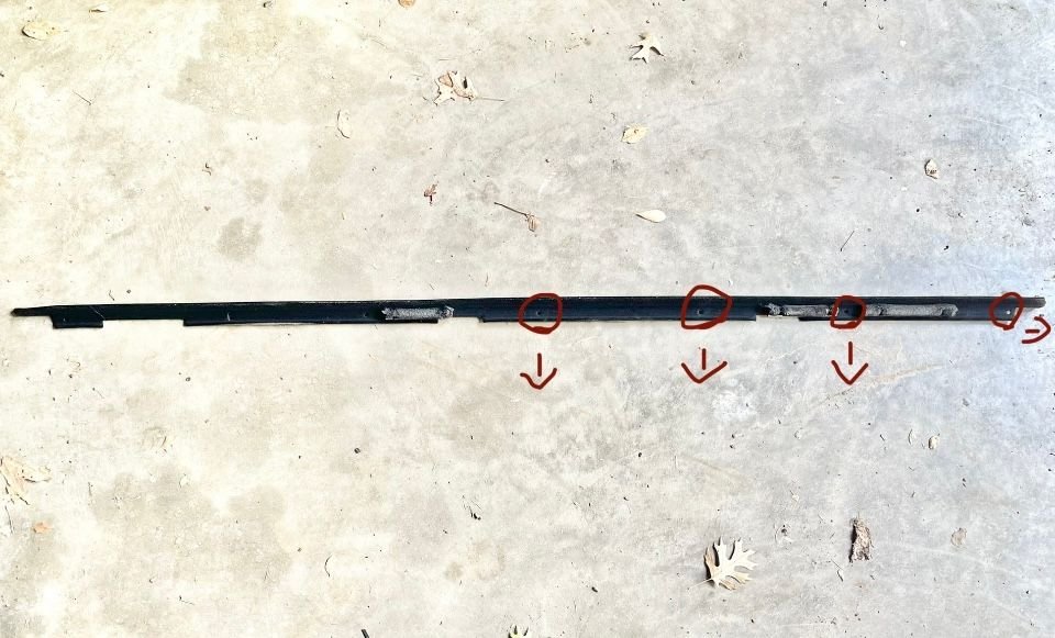

So I finally purchased some window sweeps and I got them from 1A Auto. Not sure if I got a good deal or not, but based on what others have said, I went with it. Like everyone else, I had holes that didn't align. I even laid the new set on top of the old set and the holes were perfect, but not so much when put on the door.
Now, the work I'm doing is on the '82. I think I ran across more 1 year only stuff. The screws that hold the molding to the door are philips head screws! There are two screws behind the window that aren't easily accessible. These are the same two that I'm sure everyone has issues with, but mine require a screw driver and not a wrench. The window doesn't go down far enough for a regular screw driver and the opening isn't wide enough to pull the the window in and get a 90* screw driver in there. What a pain!
I also noticed that the front triangle assemble doesn't install the same as I found on the youtube videos. I was able to remove it fairly easily but I have a ghost nut I need to find now. There are the two 10mm bolts that are near the top (Location A, no biggie there), there is one bolt that is accessed from inside the door (location B), near the top that keeps the triangle properly angled, and there is one bolt and a nut/washer about 1/3 way down the door that stabilizes the bottom of the assembly (location C). That bottom bolt screws into the bottom of the triangle assembly and the nut/washer attaches to the inside of the door frame. I dropped that nut/washer inside the door and I can't find it! How do you lose a 1" washer with a nut attached inside the door? There is no place for it to hide and I can't find it. I put everything back together except that washer/nut. Blows my mind that it fell inside the door and can't be found. There's no place to hide!!!!
Attached Thumbnails Outer window sweeps-screen-shot-2017-10

Different factories did things different and they changed stuff at will and according to on-site management and availability of fasteners, etc. I have two 1986 Trans Am's that are nearly identical - Both LB9 automatic, BW 9 bolt, etc. One is white and one is redish copper colored.... the rubber side moldings on the car were identical but one had all rivets, and one had all tiny Phillips screws... why? Because they needed fasteners and something changed - riveting tools broke down, or couldn't get rivets, ran out, etc. So they switched to screws. It's just the way manufacturing goes sometimes.

The mounting screws are still phillips in '84. I saw no way to remove some without a lot of window track disassembly. I don't recall if I had to remove glass rivets before full access to the screws, or only removing door track with window attached from rest of window lift assembly. GM design of the Bic lighter disposable car.

When I did my 84 I just removed the plastic lower window stops
and lowered the window below the opening to access the phillips
head screws.
Yes I had to unbolt the corner triangle piece to get to the screws
under it.
The only issue was punching a hole or 2 in thesweep to line up
with the factory holes and having to drill one new hole thru the
sweep AND door to secure the end of the sweep near the end of
the door.
Without thAt extra drilled hole the end of the sweep would of been
loose and easily moved or bent out of shape with daily use of car.
Easy job for sure..............

You may be on to something. My glass was coming out anyway so I must have missed that option. But I do know the only plastic parts in mine were the rollers. Everything else including the stops were steel. Not sure why my car was different.
I thought I had posted photos in my repaint thread, but see I did not. At present those photos are on another computer. I can update my repaint thread with that info one of these days.
On second thought there may have been plastic stops riveted to something. Now I'm more curious about it.

I found a few reference photos and posted them at above link. Yeah, my car is different than yours. My only plastic stopper keeps the window from rolling up too far.
Downward the glass bottoms out at rubber bumper of track hitting bottom of door, so glass always goes down as far as it can, unless start to pull rollers from tracks to get the front of window lower. But access to front screws is not the issue anyway, except for pulling the triangle out of way.

Old Aug 26, 2022 | 10:09 AM
johnw999's Avatar
Joined: Jul 2006
Posts: 580
Likes: 32
Re: Outer window sweeps
Thank you for this! My 1984 passenger door sweep was too low when I bolted it up. I mangled the new sweep too much when I tried to get the rubber lip over the frame. So, I get to buy a new one. And when I get it, two holes in the sweep will need to be extended vertically. And the last hole will need to be re-drilled. This project is taking waaaay too long!
Old Sep 11, 2022 | 12:23 PM
johnw999's Avatar
Joined: Jul 2006
Posts: 580
Likes: 32
This worked for me on my 1984 passenger side. I used a drill and dremel to extend three window sweep holes vertically. I extended the last hole horizontally. The sweep fit in the factory drilled holes. The screws were still able to grip and secure the sweep when tightened.
the driver side will fit by only extending that last hole horizontally.
