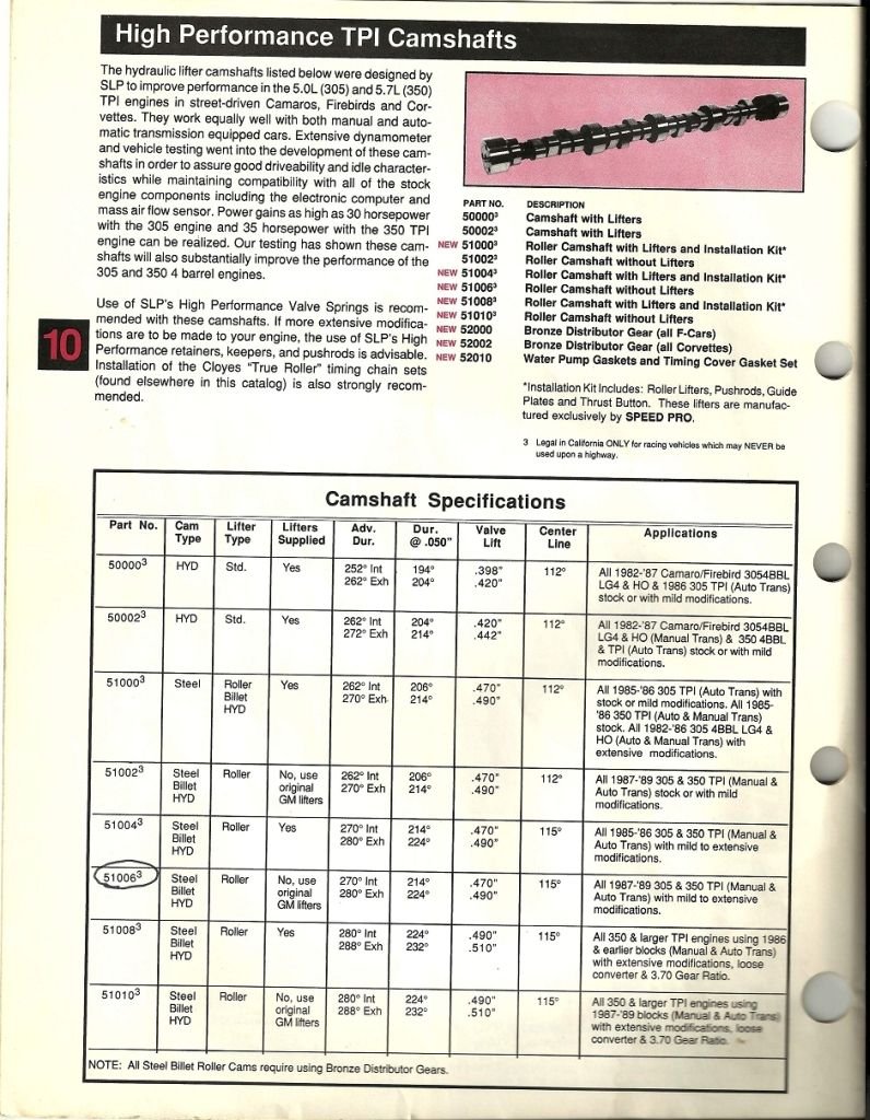

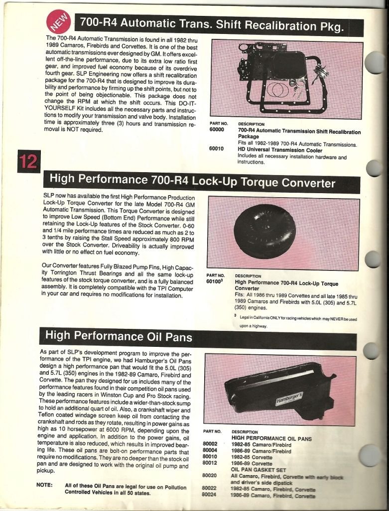

So in my quest to make my L98 more powerful, but still keep it "period correct" I came across this SLP catalog (which I'll post photos of below) from about '89 and have taken an interest in quite a few different parts that were listed. Obviously most of the aforementioned parts are no longer in production and tracking them down may prove to be a royal PITA, as I only have catalog part numbers to go by, which are proving to be not all that useful in my searches. Really the only part I think I've found is the "Cloyes True Roller Matched Timing Chain Set" in the ninth page, which I believe is this Cloyes 9-1100SP set. From what I can tell it's identical to what's pictured, but don't hold me to that. Is there a resource available somewhere to track down old aftermarket modifications, or better yet a place to find near-identical replicas? At the very least it would be extremely helpful to track down the actual part / model numbers to help with my searches. Anyways, everything I'm interested in at least trying to track down are as follows:
- SLP High-Performance L98 TPI Throttle Body (Cat. Part No. 22002, Page 3)
- Bosch 92mm Mass Airflow Sensor (Cat. Part No. 23000, Page 4)
- SLP High-Performance Camshaft (Cat. Part No. 51006, Page 8)
- SLP High-Performance Valve-Train Components (Cat. Part Nos. 53002, 53102, 53110, 53122, Page 9)
- Cloyes "True Roller" Matches Timing Chain Set (Cat. Part No. 53202, Page 9)
- SLP Lock-Up Torque Converter (Cat. Part No. 60100, Page 10)
- Hamburger's Oil Pan (Cat. Part No. 80004, Page 10)
...and here are the catalog pages. I'll include them all for anyone else who may be interested:
Page 1
Page 2
Page 3
Page 4
Page 5
Page 6

...and the remaining six pages:
Page 7
Page 8
Page 9
Page 10
Page 11
Page 12
