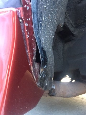

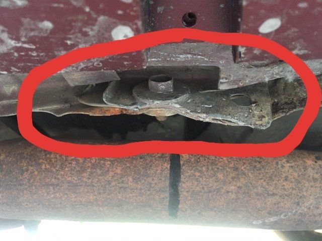

Dagwood,
I took some pics of the "fender bulge" today. Can you help me?
Passenger side - door on top/fender on bottom
Is this the plate?
Wheel well...
Reply 0

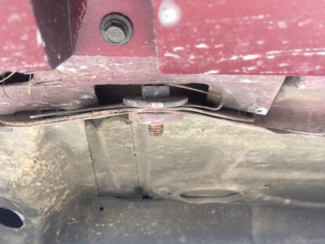

Feb 4, 2020 | 06:58 PM
  #59
Re: Original taillights?
Here is the drivers side -
Clip on this side looks good. Passenger side is broken.
Reply 0
Feb 4, 2020 | 07:08 PM
  #60
Ok, this bolt goes through the cars pinch weld. The pinch weld needs to be straight vertically, and the bolt needs to be straight horizontally. They (pinch welds) actually bend pretty easily. That bolt holds on the bottom of the fender. So if you get that straightened out, it will line up the fender. You can get a vice grip or something on that pinch weld, or bolt, pry on it and you can watch the fender suck back in.
Reply 0

  #64
Do you recognize the little bracket that is broken on the passenger side? Do you know what that is holding? Is that part of the ground effects?
I have the factory but it has issues. Maybe he can fix mine.
What do you think of the broken bracket under the passengers side by the pinch weld? Is that part of the ground effects? Do I need to be concerned?

  #68
I can't remember what that clip is for. I'd have to look under my IROC, but it's in storage 30 miles away lol.
Is it ahead or behind the bolt that I circled? And does the bolt go up instead of horizontally?
Reply 0
Feb 4, 2020 | 07:39 PM
  #69
Its in front of the bolt you circled. Its right after the wheel well you can see in black. The bolt in the clip goes vertical. The front side of it is what is broken.
Reply 0
Feb 4, 2020 | 07:51 PM
  #70
Quote: Its in front of the bolt you circled. Its right after the wheel well you can see in black. The bolt in the clip goes vertical. The front side of it is what is broken.
I'll have to look under mine when I get the chance. I would say it's nothing to be overly concerned about, though
