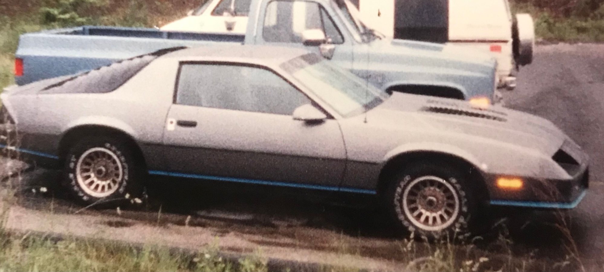

My old 86 berlinetta starship. My fav interior. Unfortunately I was 18 in 1987 and beat the **** out of it.
