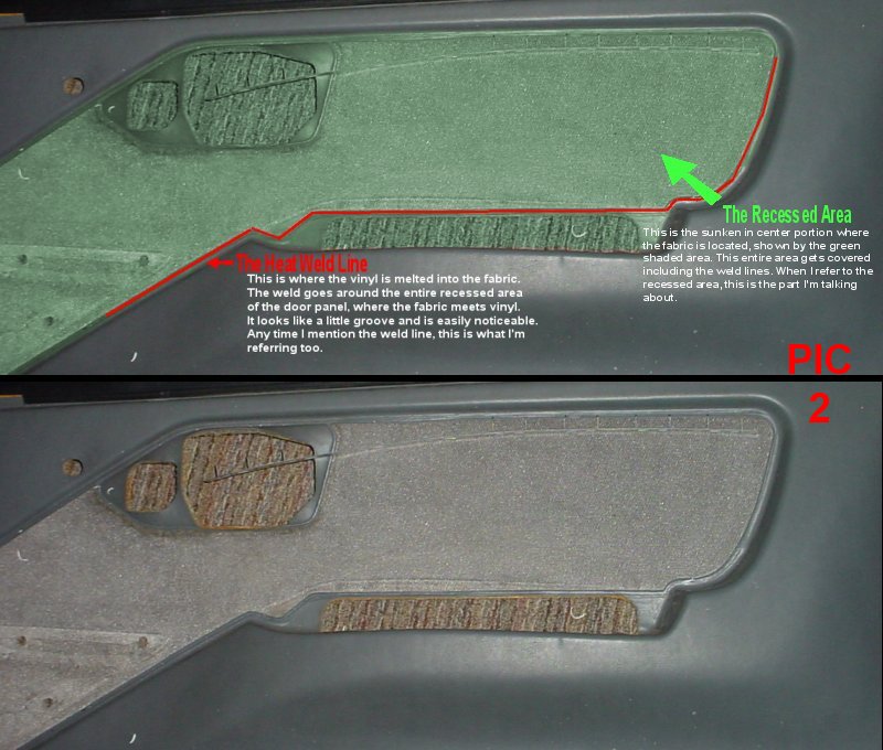

I didn’t have a lot of pics, but I dug up what I have. Hopefully this wont be to confusing, it would help if I had some pics of the spike strip application, but I did that in the middle of the night half asleep and forgot. I made up one pic as a reference with some color coded info on it, and another showing the materials I used. If I ever get around to doing another set, Ill try and make a better walkthrough about this. It was my intention this time around, but I got in too big of hurry and forgot to take pics for several steps.

Here is what I did, it seems a lot harder reading it that it actually is, but if you have no experience at all with fabrics and stuff like this, it might be rather tricky.
1. Step one is to remove all the attachment clip on the back of the door panel, so it will lay stable on a surface, and remove the lower door pockets if your doors have them. I had to make a special tool from a copper water line to get those nuts off for the door pockets, but you might have luck with the right size of pliers.
2. Now make a template for your new backing boards. Take a large piece of poster board or cardboard big enough to cover the entire fabric portion of the door panel. Lay it over the door panel and trace an outline of the fabric part onto the cardboard. It doesn’t have to be anything near perfect, since it will get trimmed later. Make sure when you trace the outline, to make it a little oversized so it can be trimmed to fit. I did this from the back side of the door panel and it was much easier for the deluxe door panels.
3. Once you have the shape of the fabric part traced onto the cardboard, cut it out and lay it into the recess where the fabric is on the door panel. Trim the edges of this piece little by little until it sets down perfectly into the recessed area of the door panel and covers the fabric portion completely. You want the cardboard panel to overlap the heat weld line where the vinyl meets the fabric so the panel butts up flush against the edges of the recess.
