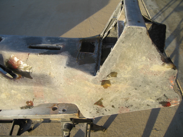

So i've got this idea in my head about making a custom console out of the stock one as a budget saving idea. I've already pulled the console out, i'm going to wrap it in fiberglass, paint it to match the car... while add a few cubby holes for wallet/phone, a cup holder, and a more useful armrest i can actually use. I'll keep you guys updated, but would love to see some pictures or hear some ideas bounced around.
Attached Thumbnails custom console start...-console-2.jpg   custom console start...-console-3.jpg

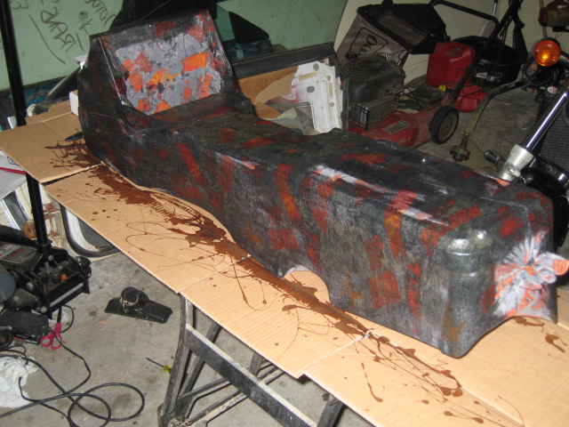

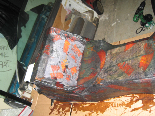

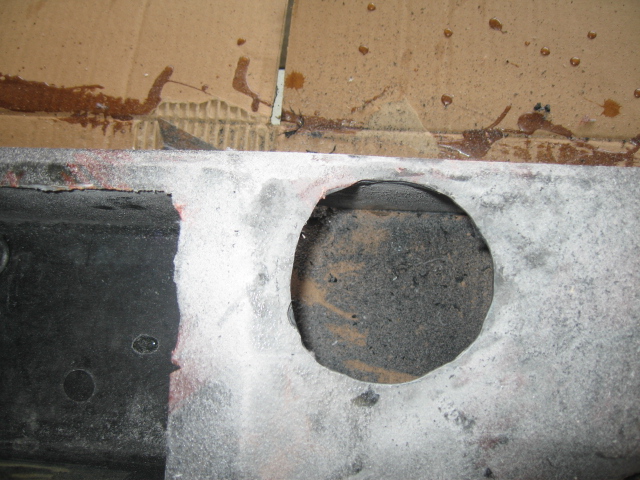

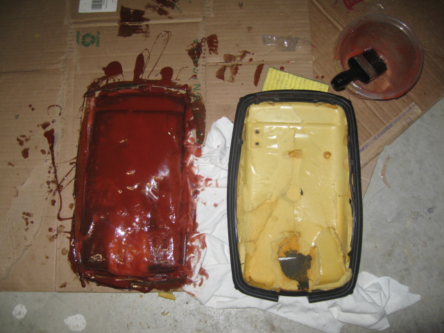

so todays progress: Yes, those are my "pirates of the Caribbean" sleeping pants. And yes, they stretched perfectly over the console. I pulled the second leg through the cd player/ac control hole....figure thats a good way to keep it there. I got the shape i was wanting just from doing that. I drilled 2 holes in the corners of the cut-in where the E-brake will be, tied that down so the e-brake will still function in that spot.
I'm going to start with one solid piece and get it the shape i want, then start cutting into it... adding everything afterwards.
This will be the general shape, I like how its already smoothed out the sides and some of the sharp edges.
Tomorrow starts the resin work..... so freakin' messy.
Attached Thumbnails custom console start...-console-004.jpg   custom console start...-console-008.jpg   custom console start...-console-006.jpg

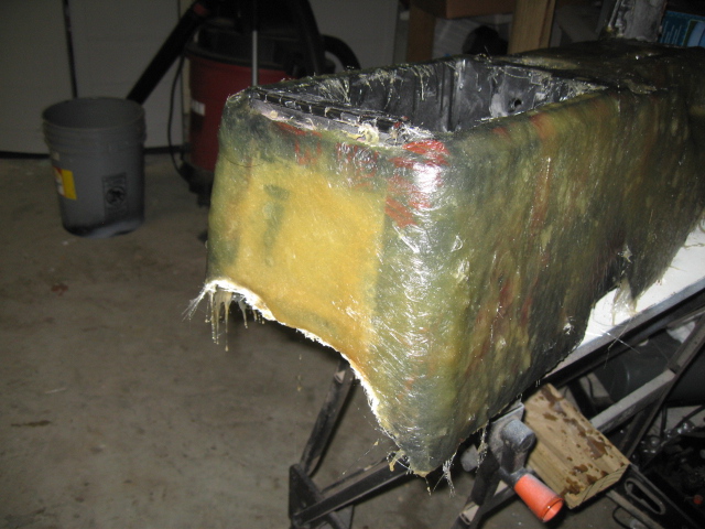

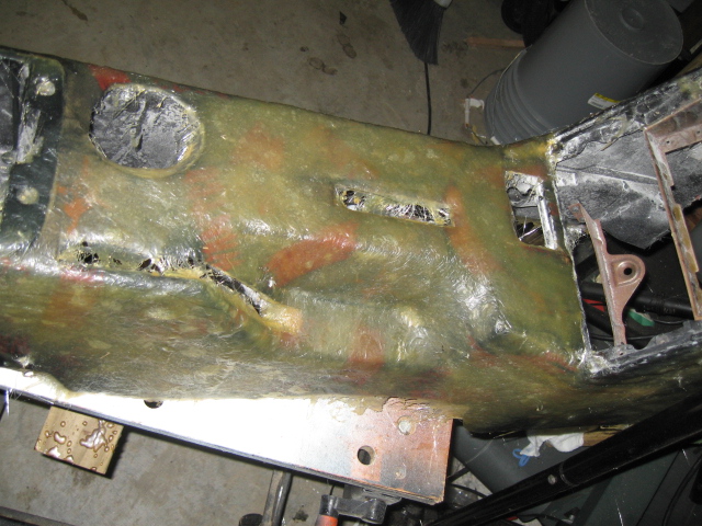

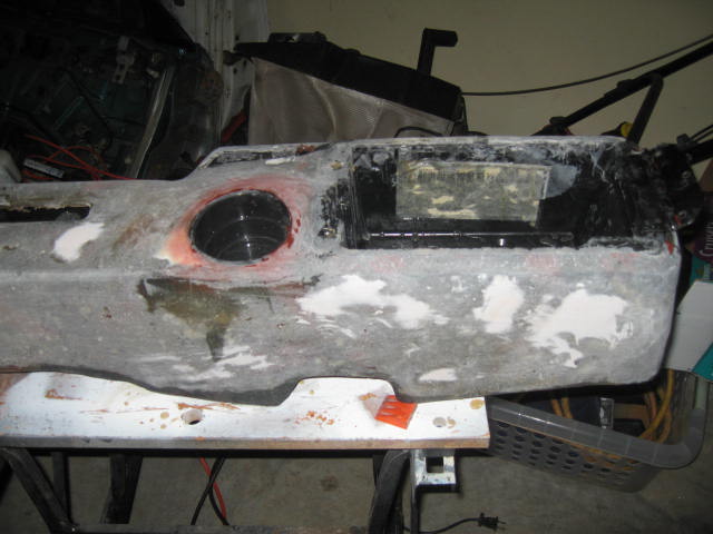

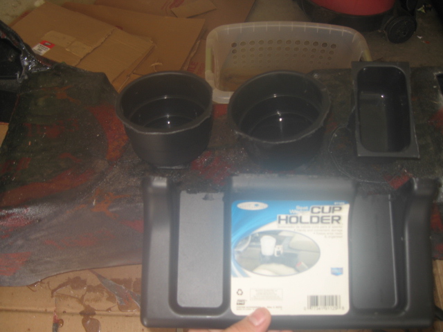

progress....... almost a quart of resin.
Molded 2 slots for a wallet and a phone, i dont like how they turned out. Any idea's on what i could use that is already shaped the size for a cell phone and one for a wallet? I'm thinking 3-4 inches deep, 1/4-1/2 inch wide....
would like some ideas....
Attached Thumbnails custom console start...-console-009.jpg   custom console start...-console-010.jpg   custom console start...-console-011.jpg

target usually sells cell phone holders and crap like that, check out the useless auto crap setion, there's bound to be something

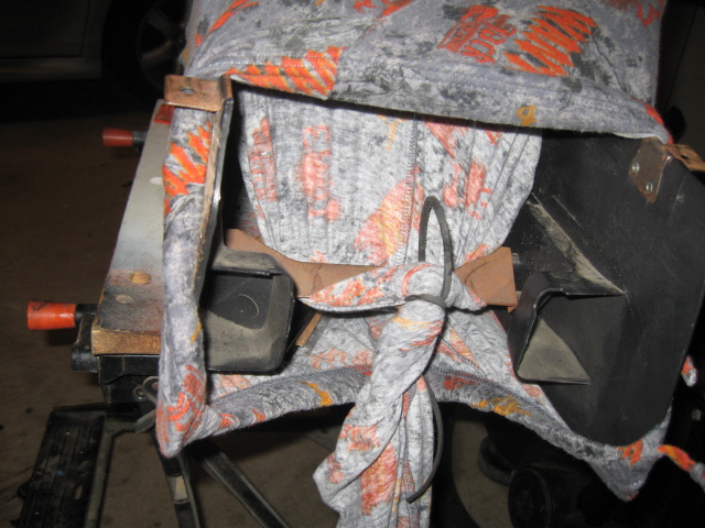

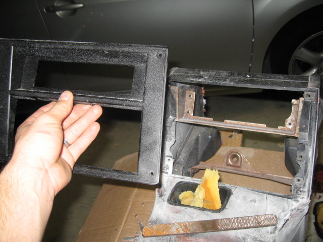

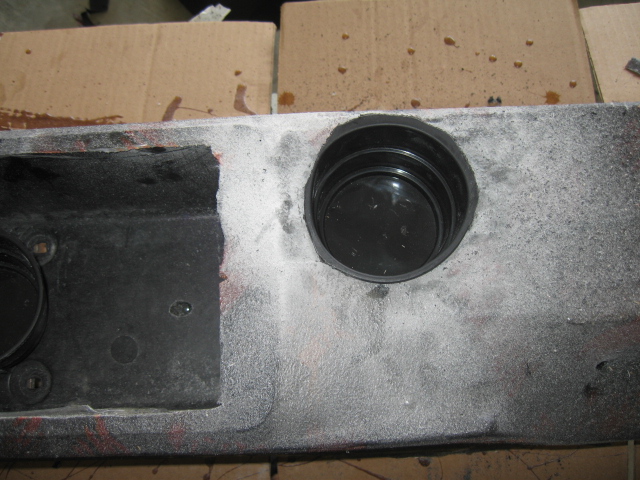

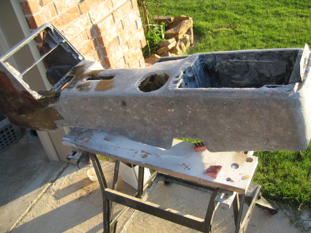

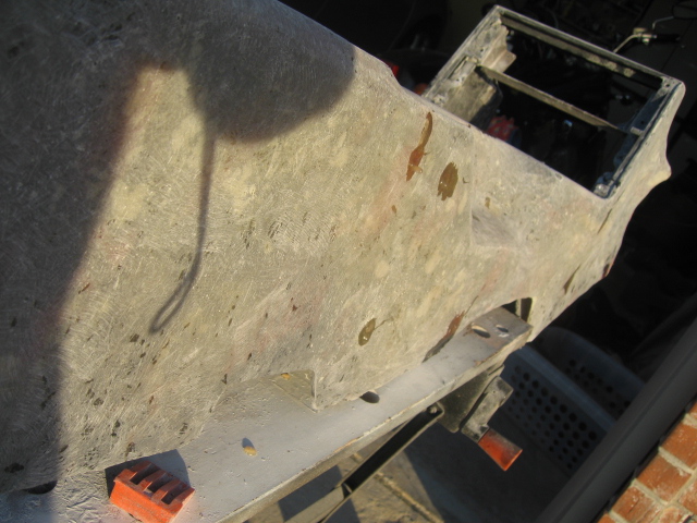

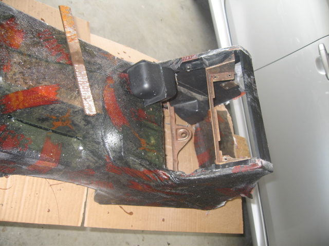

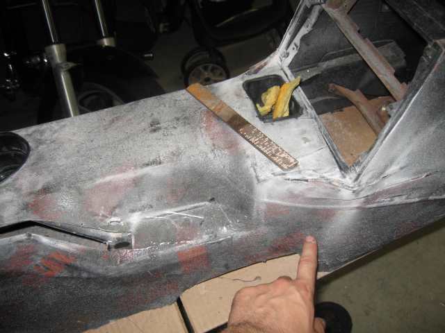

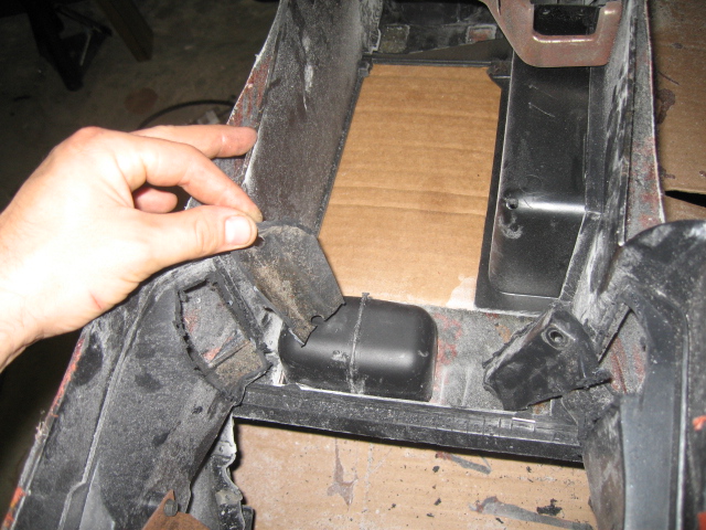

So starting this i had no idea that this many people would be that into the idea....its pretty awesome. I'm going to start being more detailed in the process now that i'm at the "too late to turn back" phase.
Today i cut holes for the cup holder and change tray, got them from oriellys for 4.99... it was a "wedge fit" cup holder with 2 cup spots and a change tray between them, cut the three of them seperate and cleaned them up, making the sides smooth so they would slide into a hole.
The first picture is the underside, i removed the old ashtray and shift cover, replacing the shifter cover with cardboard for rigidity.
Attached Thumbnails custom console start...-console-003.jpg   custom console start...-console-002.jpg   custom console start...-console-006.jpg

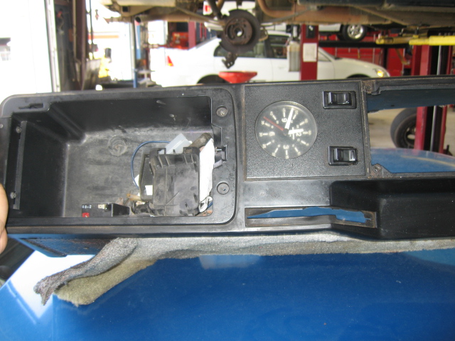

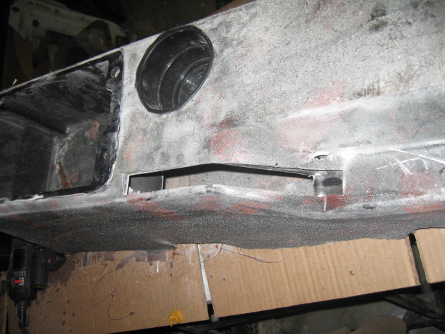

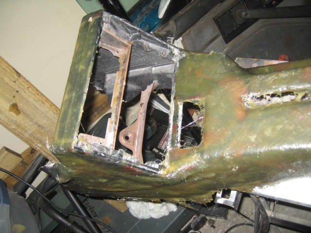

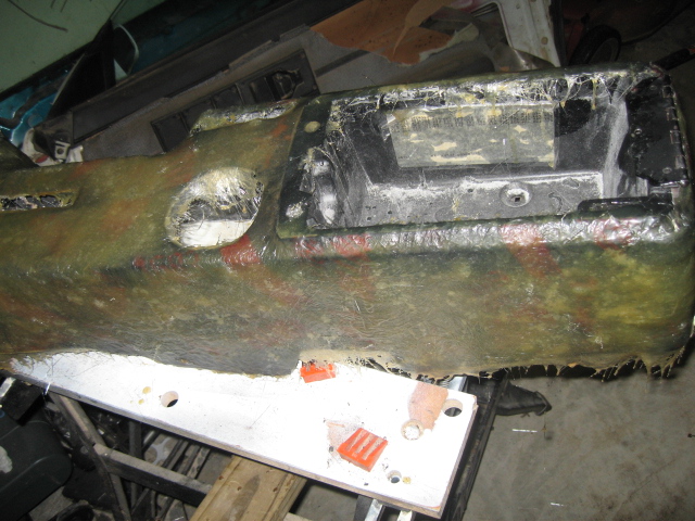

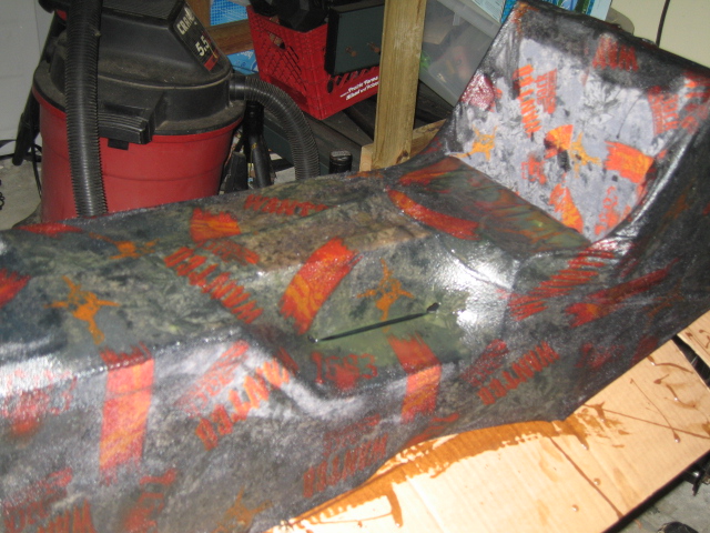

i haven't decided where to put the window switches, i'm thinking about bringing the walls of the console up about 2.5 inches....mounting them there somehow. We'll see.... thats all for today.
I'm happy with it so far....
the only think i'm not unsure about........ Cover it in a material or get it smooth enough for paint? opinions?
Attached Thumbnails custom console start...-console-009.jpg   custom console start...-console-012.jpg   custom console start...-console-008.jpg

Id say paint, OR you can buy that spray can truck bedliner stuff, to replicate the original texture. But I think painting would look cool

hmmm, black vinyl wrap!

so its been a few days, but finally got some time to do a little more. today i cut out the spot for the e-brake, finally figured out where i'm going to put the power window switches....its going to be in the a/c vent spots. I cut out the backside of the a/c slots already and cleaned up the front of the console where the cd/a/c cover needs to screw in. I made a fiberglass mold of the inside of the armrest cover, i'm going to use the stock armrest...i was going to make my own and raise the console box up about 2in, but it works, and i'd rather not get in over my head with this but just make it look good....
Minor progress, but it works for today.
Sunday is fiberglass day....I'm almost scared.
Monday i'm going to the junk yard to pull off a back bumper(dumbass that had my car before me not only built a crappy engine, but also rested the exhaust tips ON THE BUMPER, melting it), find some window switches i like, and finish tuning my car, put my new 4in cowl hood on that was delivered yesterday, and drive her home for the first time since i got the car
I'm just waiting for the funds to get a quick silver shifter before i finish the console, need to figure out where to cut for the shift lever....i dont know if it is in the same spot and moves the same amount as the stock one or not....
Can anyone tell me this???? I'm getting the "quick silver" ratchet shifter and just need to know how the shift lever(rod, pole, shaft, stick, whatever) matches up with the stock one...if it is the same i can wing it and just finish the console before i buy it.........
Attached Thumbnails custom console start...-console-014.jpg   custom console start...-console-016.jpg   custom console start...-console-018.jpg

More pictures.
Side note: havent worked on it much this week b/c i'm tired from work....something pretty cool happened. Tune in to "Man V Food" on the travel channel the wed. before thanksgiving to see my families business!!!!
We have a hot sauce at the Mean Pig BBQ that is just killer hot, called the "shut up juice," and they came out to film a show. It was very cool....
Don't know if you guys care, but its pretty exciting for us!
Attached Thumbnails custom console start...-console-015.jpg   custom console start...-console-013.jpg
Just as an FYI you can buy cup holders at any marine store (like West Marine or ebay). The ones you have now look jagged! Go spend $5 and it will really improve the look of what you are trying to acomplish.

todays progress
So I put 2 layers of fiberglass on the console....it turned out pretty good....still have not cut it in, so it looks rough. After the first layer, i cleaned up the edges, cut off the overhang in the cup holder and change tray slot, cleaned up the spot where the a/c cd cover will fit, and got rid of as many high spots as i could. I didn't take pictures of the process b/c its extremely nasty, sticky, and hard to work with. Lets just say i lost plenty of arm hair in the process and it wasn't worth the trouble.
I know it looks rough, but thats an unfinished project for you.
ps, got my car going today, it officially has 6 miles after the rebuild and running like a champ.
Attached Thumbnails custom console start...-console-030.jpg   custom console start...-console-031.jpg   custom console start...-console-032.jpg

I'm going to grind down the area lower than the rest of the console where the cup holder is going to be inserted(the width of the lip that you see as 'jagged')....they just look jagged till i goop it with resin and sand it to be flush....

I spent three hours this morning working on the console. I sanded it with 30grit paper using the assistance of a air compressor. I don't recommend doing this project without one!!!! It cut out hours of work.
I like the overall shape. Not done, still have to hand sand, use body filler, and sand again, then paint.
I've decided not to put power windows back in the car, the door i have to replace has the manual setup already, and i'm getting one for the drivers... Less to deal with, and most of my cars have been manual so i'm used to it. Thats one less hole i would have had to deal with in the console.
I'm leaving the wiring under the console just in case i chose to put it back in later.
What do you guys think???
Has the result so far got anyone interested in trying it?
Attached Thumbnails custom console start...-console-034.jpg   custom console start...-console-035.jpg   custom console start...-console-036.jpg

I'm going with the bedliner idea, I think it'd be easier for touch ups and much easier to deal with than vinyl or another material wrap. I've already started making a new lid for the box, i'm using the existing bracket, but taking the hard black plastic top off, replacing the foam, and wrapping it using the back to an old leather jacket i was given. I'm also making a shifter boot and e-brake boot out of it.
I added some body filler last night, trimmed the backside that fit against the dash so it'd fit in....and got it set in just to see how its looking so far. I really like it, its much cleaner. I'll take more pix tonight after i sand the body filler.

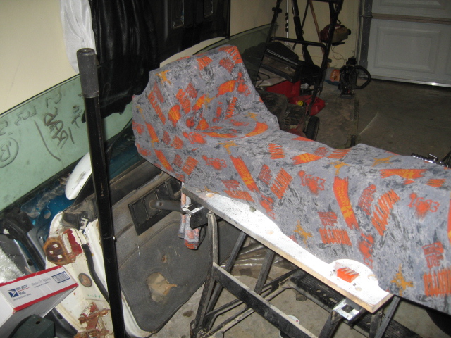

So the latest update: lots of freakin' sanding. holy crap, lots of freakin' sanding.
I got the cupholder and change tray fiberglassed in, got it smoothed out, washed, and now its time for paint.
Got the shift boot and e brake boot made, more pix of that later. Making the console lid this weekend.
Attached Thumbnails custom console start...-console-038.jpg   custom console start...-console-039.jpg   custom console start...-console-040.jpg
