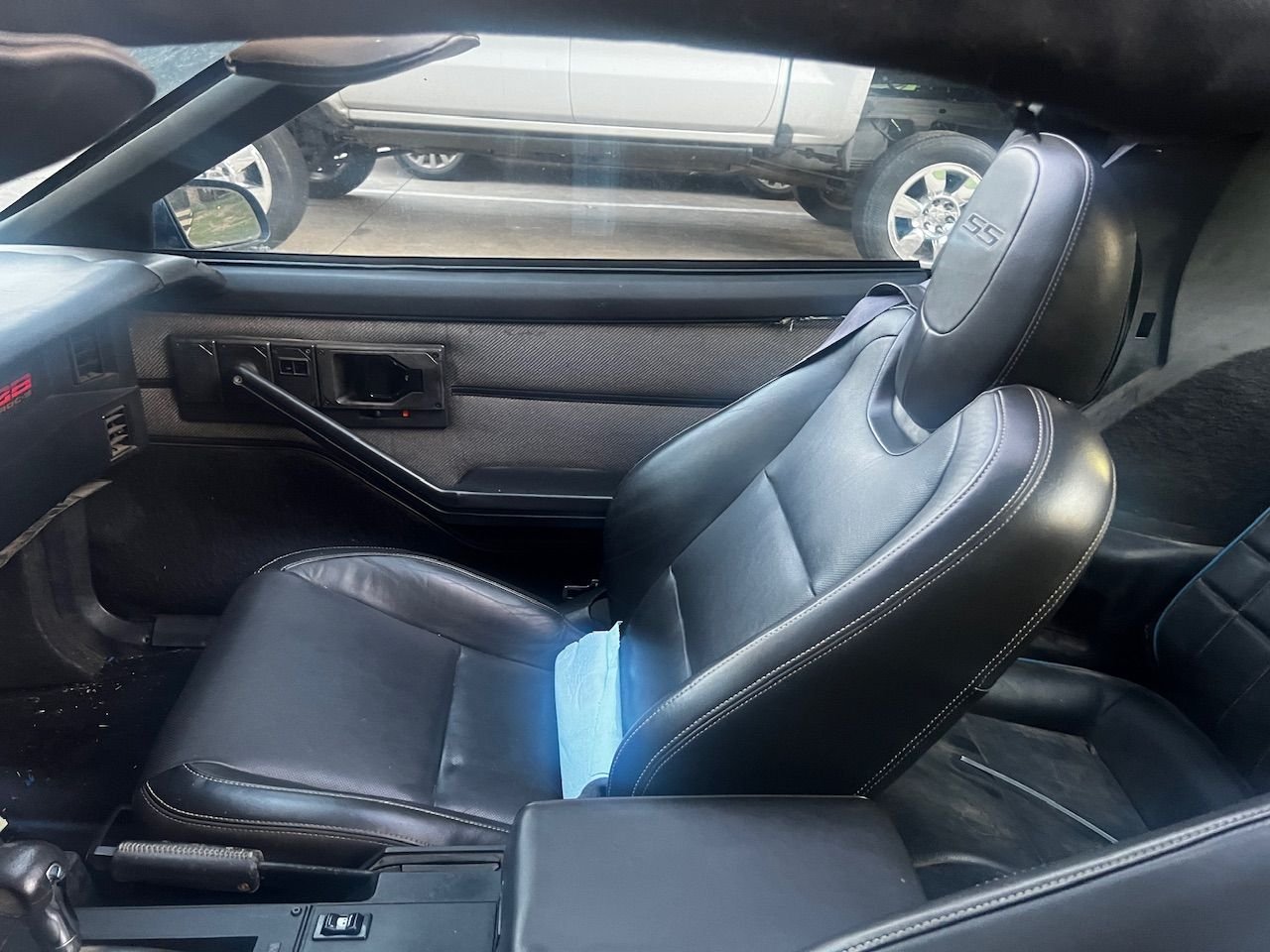

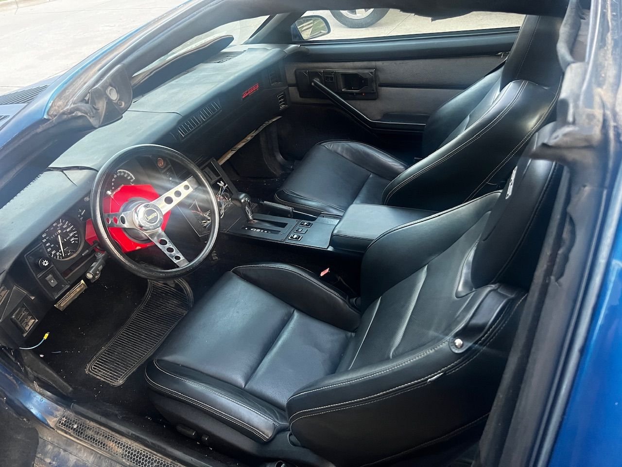

Just bought a nice set of SS seats leather for 500$ (pretty nice seats for a 2013 Camaro), almost bought the dash but I think 🤔 I want the 2018 dash, door panels and center console if I actually do the upgrade.
Old Jul 24, 2021 | 08:46 PM
  #68
89-irocz's Avatar
Joined: Nov 2020
Posts: 10
From: Dallas Tx
Car: 1989 Camaro iroc z
Engine: 5.7 but not the original
Transmission: Not sure
Axle/Gears: Not sure
Re: 5th Gen seats into a 3rd Gen Camaro
So I picked up these nice leather SS seat for 500$, pretty nice for a 2013. Waiting to get car back from shop (installing a new gas tank) ready to have these installed
Yea here is a pic of one of my seats, they are basically the same though so you just reproduce for the other side. I welded my brackets to the frames (front is 1/8" flat stock that runs and connects both front legs and rear L brackets are 3/16" steel). I had to trim off the OE mounting brackets on the seat rails but this allows me to literally go as low as possible. I also utilize the front inside OEM hole on the track to mount on the OE stud on the floor board then making brackets is pretty easy.
Originally Posted by maks10
Is there any confirmation the rear seats fit without too many issues?
Haven’t had any issues with mine, but haven’t really drove it since it’s getting a cammed 5.3 swapped with 4L60e, and 2002 z28 rearend with 4.10s
both my babies 😂
