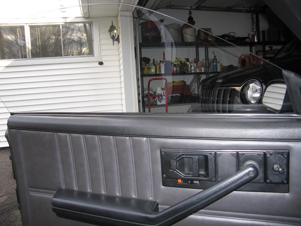

I am in the process of restoring the interior of my 91 Z28 vert to showroom new and have come up with a question.
With the black plastic top piece of the door panels, is it supposed to bend or is that some type of heat warp.
I have noticed almost everyone's is tearing out of the cardboard of the door panel and becoming loose at the rear of the piece. That lead to me assume they are supposed to be flat and are becoming heat warped.
BUT, just now I was over in the appearance and detailing forum and saw this picture of a members beautiful car with what appears to be an immaculate interior and his is bent too.
Straight or bent, what is correct?

Went Out Today To Start The Car And Let It Run For A Bit,I Checked Both My Left And Right Door Panels,I See No Bend/Curve.

Can't really tell on the drivers side - but your pass side clearly has bend in it...... it sits much higher in the back than it does in the front.
Put a straight-edge (that extends past the trim at each end) on the top - and then again on the side - of those upper trims panels then take the some more pics and post them up.

ok, had some time to look at this some more. Im interested in these issues as I've started making fiberglass interior parts to replace these horrible plastic parts in our cars. I might try and make some of these trim parts, but they will be a challenge.
I was right and wrong on some things.
difficult to get pics that illustrates this but ill try.
First, yes, they are supposed to be straight by design, however also yes, they are all warped from the factory.
I removed the window felts, which are straight BTW, and experimented with clamping it to a jig and heating with a heatgun to get it to go straight. This has worked well for me before in straightening similar warped plastic parts such as the door sills.
In this case, I couldn't get the plastic to reform straight, just kept going back to bent shape as soon as released from the jig. this tells me it took that shape during the manufacturing process, not warping with age or sun.
If you examine the back side of the cap, you can see the tabs that attach the cap to the window channel were added after the main part was molded. You can see where these tabs were attached by either some sort of hot welding process or molded in a second stage to the first. This is what caused the warping. They pulled it from the female side of the mold before the plastic had stabilized, hence they all warped.
They were mostly straightened out when attached firmly to the flat, straight door card. it takes quite a bit force to straighten it, so they immediately started pulling on the card to resume their warped shape. this is why some new ones look straight, some show some curving, and finally completely banana when the card totally lets go.
i was incorrect about one aspect of the shape, there is supposed to be a curved "ramp" on the top edge of the cap where it mates to the dash. it is supposed to be dead straight after that to the trailing edge.the bottom edge of the cap along the card is also supposed to be straight, not curved.
If you get one of these in your hands and straighten it, this all becomes very clear. you can even see that the warps match up with the hot weld? spots on the underside. if you leave it in its natural state and look a from different angles you can clearly see they would not have made the mold in that shape. besides the fact that curves wouldn't fit on straight lines, you can see the shape would have been unnecessarily complex for a mold.
I think i will try and make some fiberglass replacements at some point, but this part will be a challenge to mold so won't be soon.
the important points to take from this are:
1)don't bother buying new caps to replace banana ones, they are all like that new
2)when restoring door panels its important to make sure the mounting holes at top are not distorted and the cap is firmly secured by them in its designed strait position.
prob best to replace the card with something more durable that will do a better job holding the cap straight.

some pics that show it can be straightened with force:
