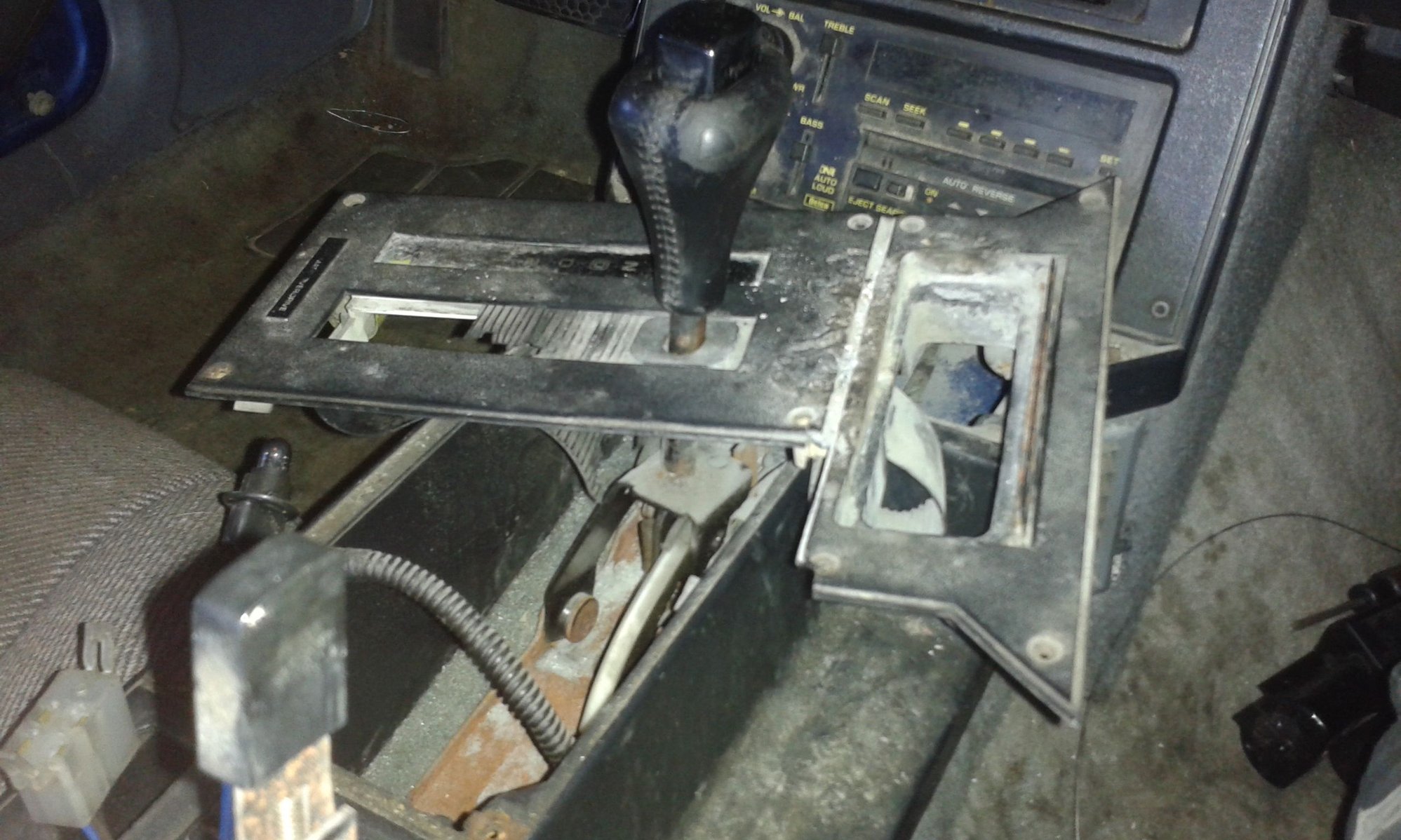

Whats the easiest way to remove this plate without breaking anything?

Take the **** off the shifter. I'm not sure how the leather **** come off, someone will chime in.

On the front of the shifter, toward the bottom. you'll see a metal pin, take a small screwdriver and pull it out. Once it's out, the shifter **** will come right off.
Once you have it off, you can pull the plate right off.

Yep, the little clip is the keeper.

Yeap that did the trick. Thanks
