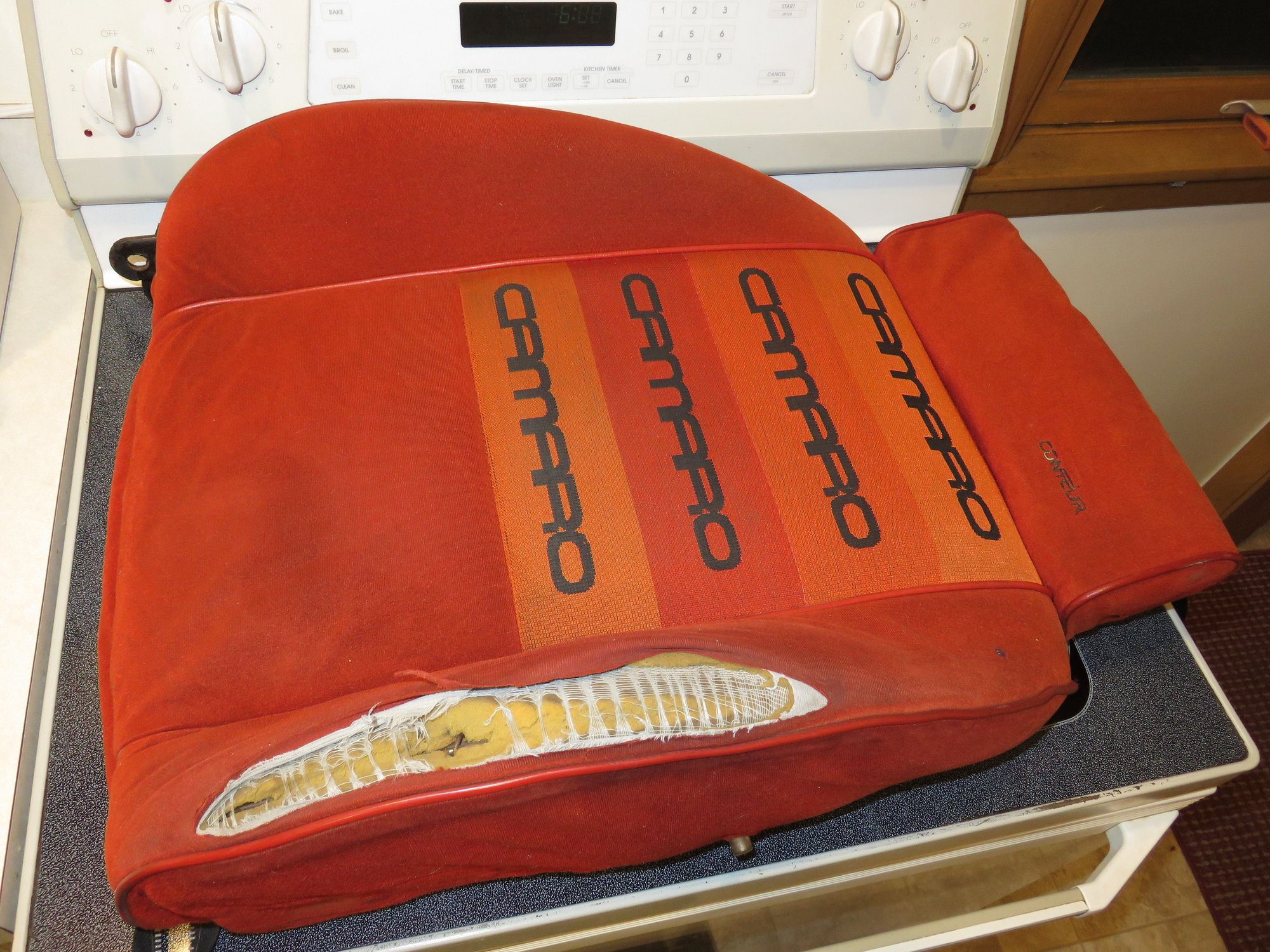

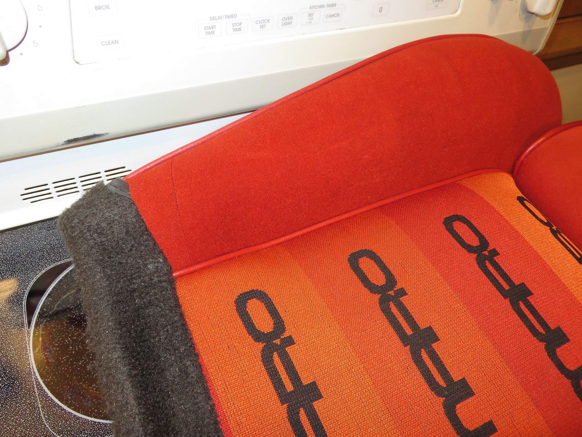

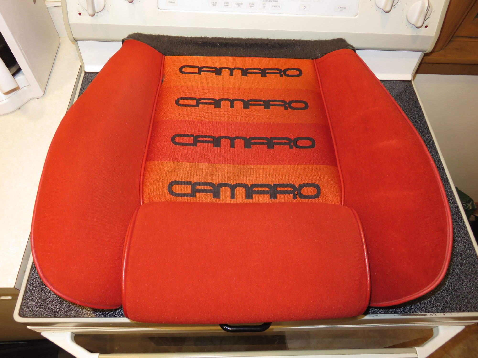

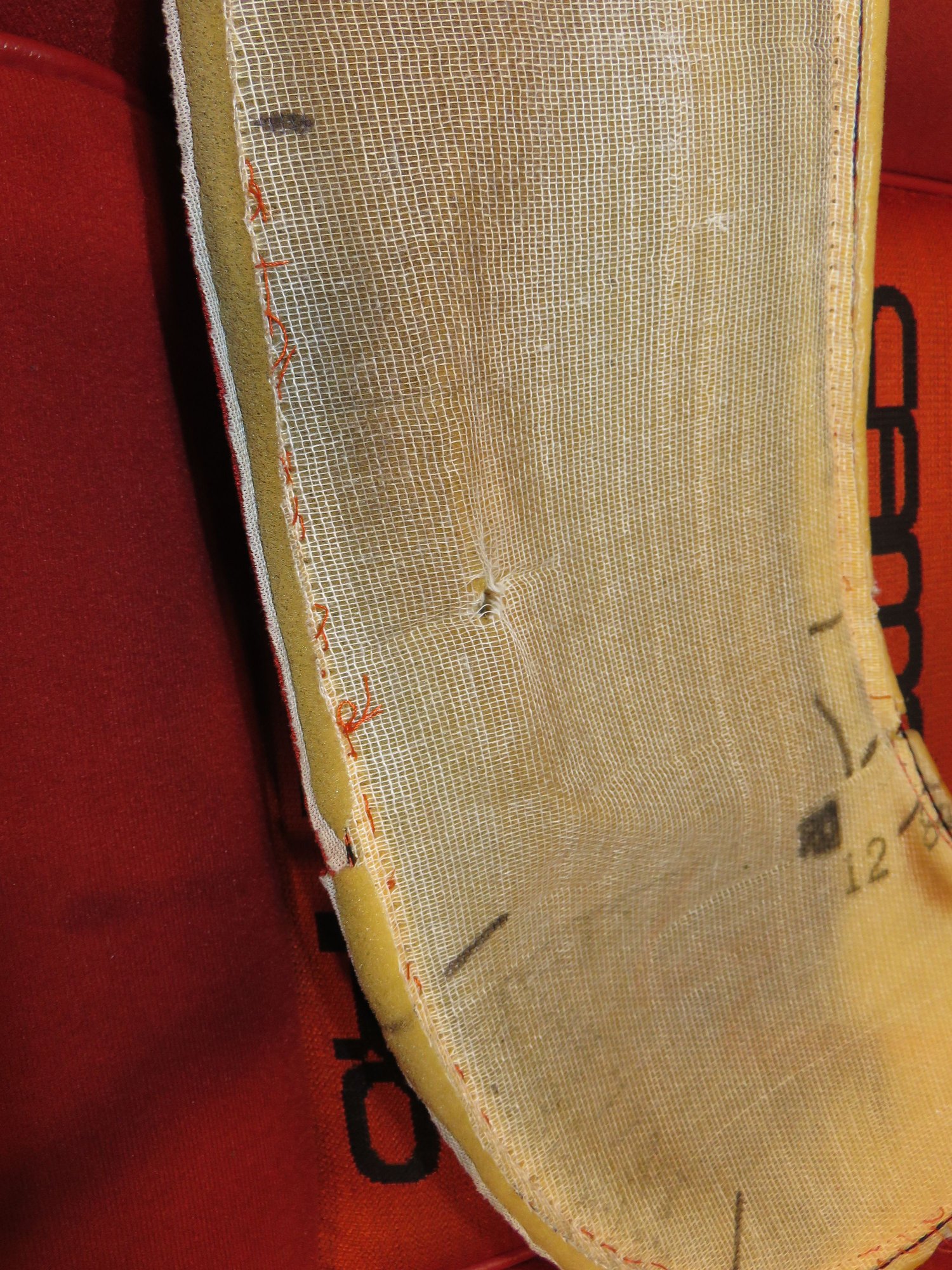

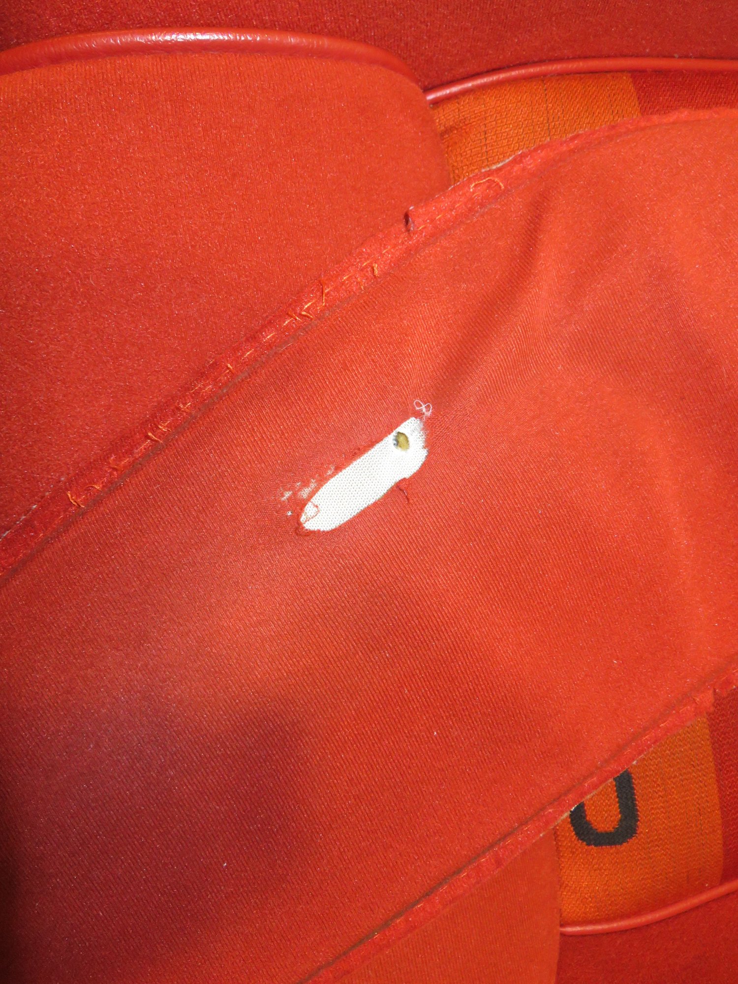

Recently had the driver's bolster fabric replaced with donor fabric from back side of a salvage yard seat.
Repaired bolster.
Repaired bolster. Needed to splice donor fabric.

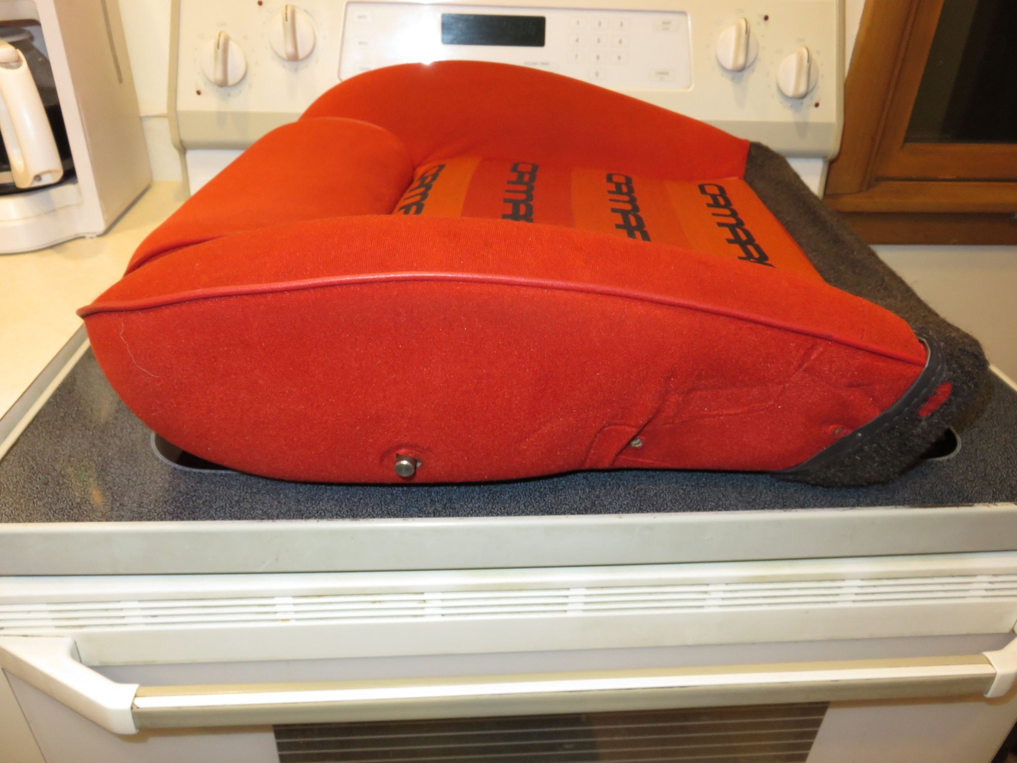

Repaired bolster.
Repaired seat.

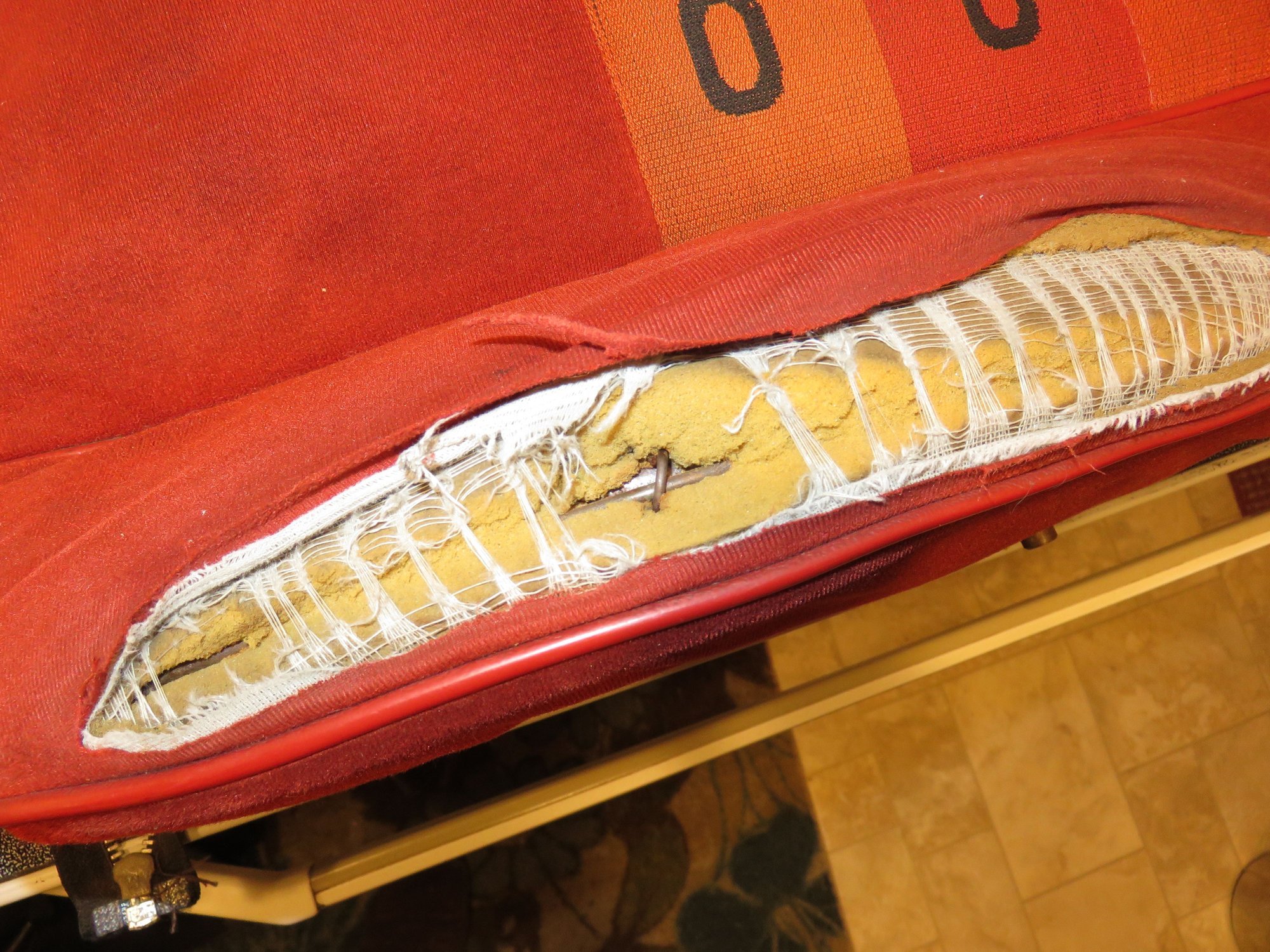

Original bolster.
Original bolster.

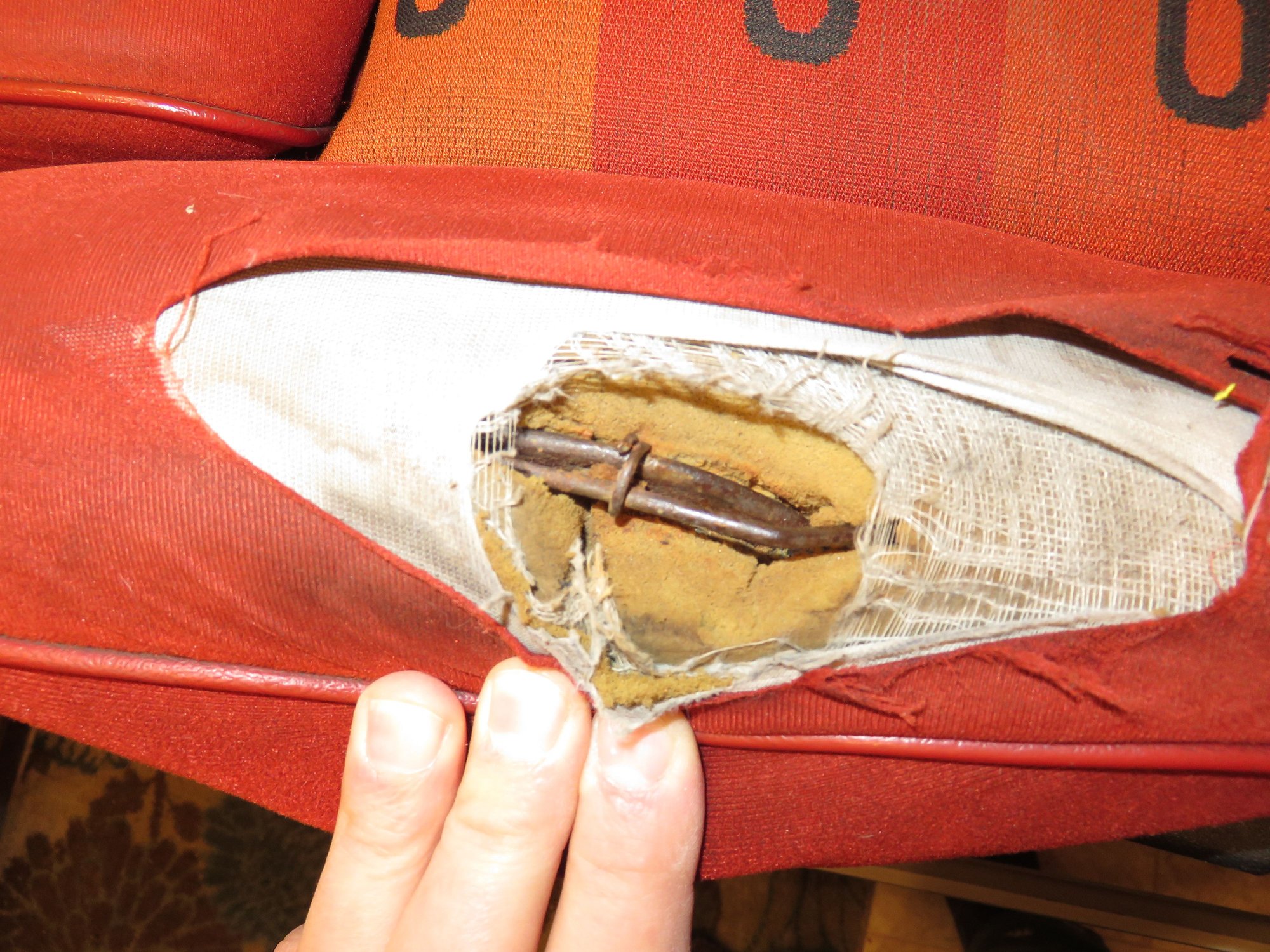

Original bolster at hog ring contact.
Original bolster at hog ring contact. Orange fabric was worn thin and hole was enlarging on a weekly basis in 2015.

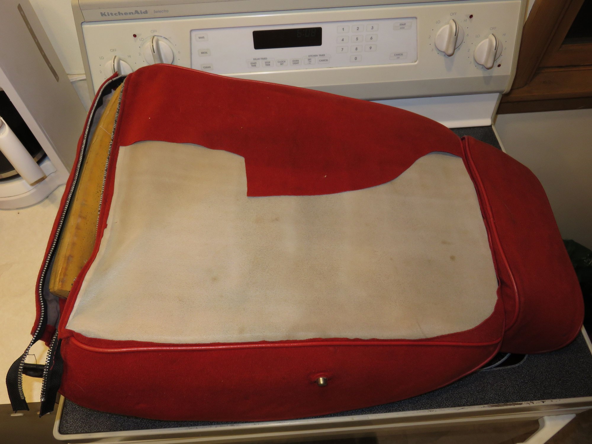

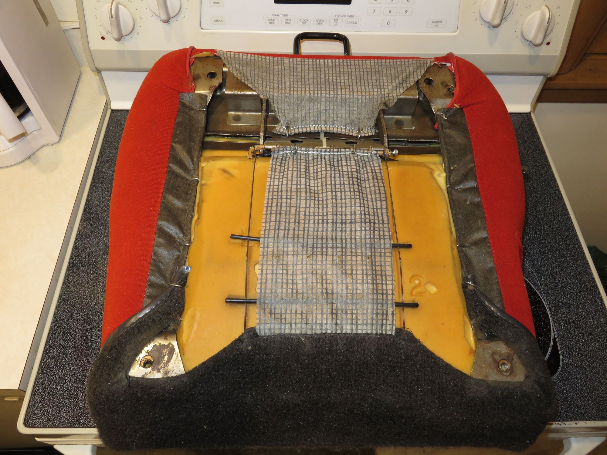

Donor fabric.
Donor seat back.
Donor seat back factory hog ring.
Donor seat base.
Donor seat base factory hog ring.

Nice job! The CORRECT bolster fabric for these seats is impossible to find from the aftermarket. I've checked dozens of sources.

Nice repair. Notice the date code on the back of the original bolster..pretty cool.
