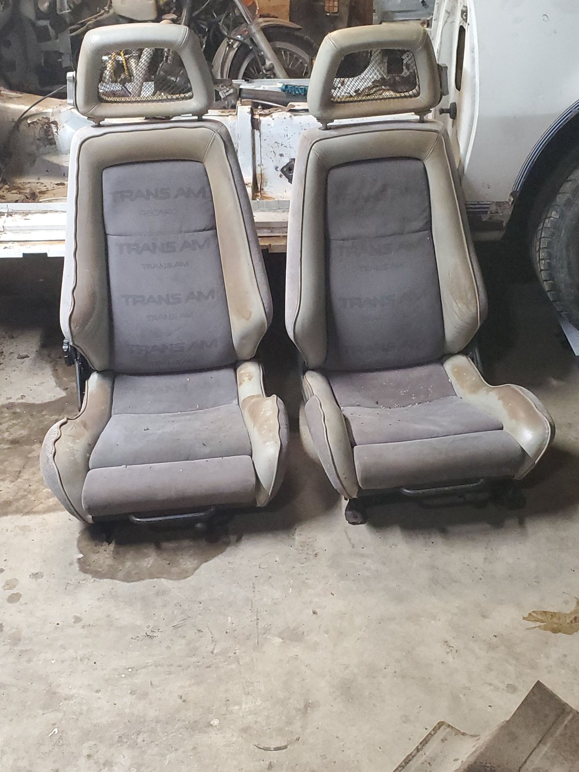

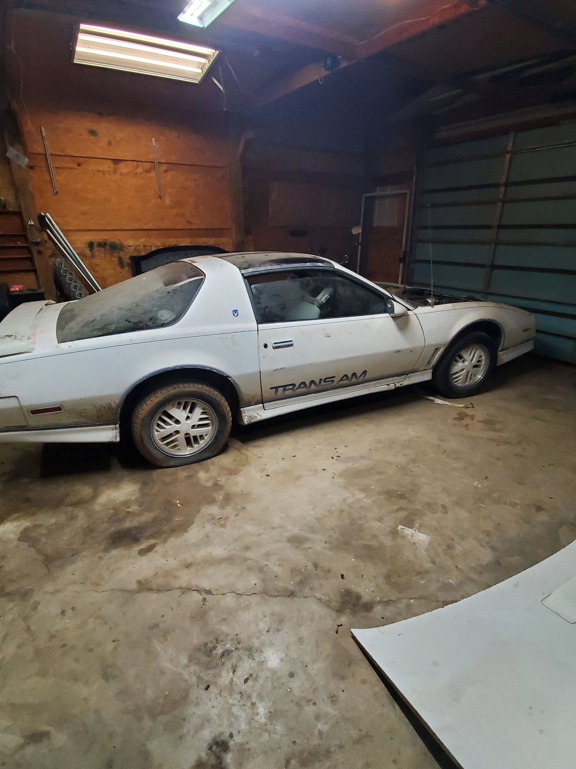

84 trans am 15th anniversary seats
In the process of a full restoration of a 84 15th anniversary trans am. I'm having a hard time finding fabric for the front seats' and was hoping someone here would happen to have the fabric or know where I can get it.

I'm pretty sure that was discontinued LONG ago. Might get the proper grey then have a vinyl masking cut for the print. Then you can stick the mask on the new fabric and shoot it with SEM dye and peel the mask off. Effectively reproducing the original look.

SMS auto fabrics might have some old stock. I think they buy up pretty much all factory old stock leftovers. Brace yourself for the price though.
