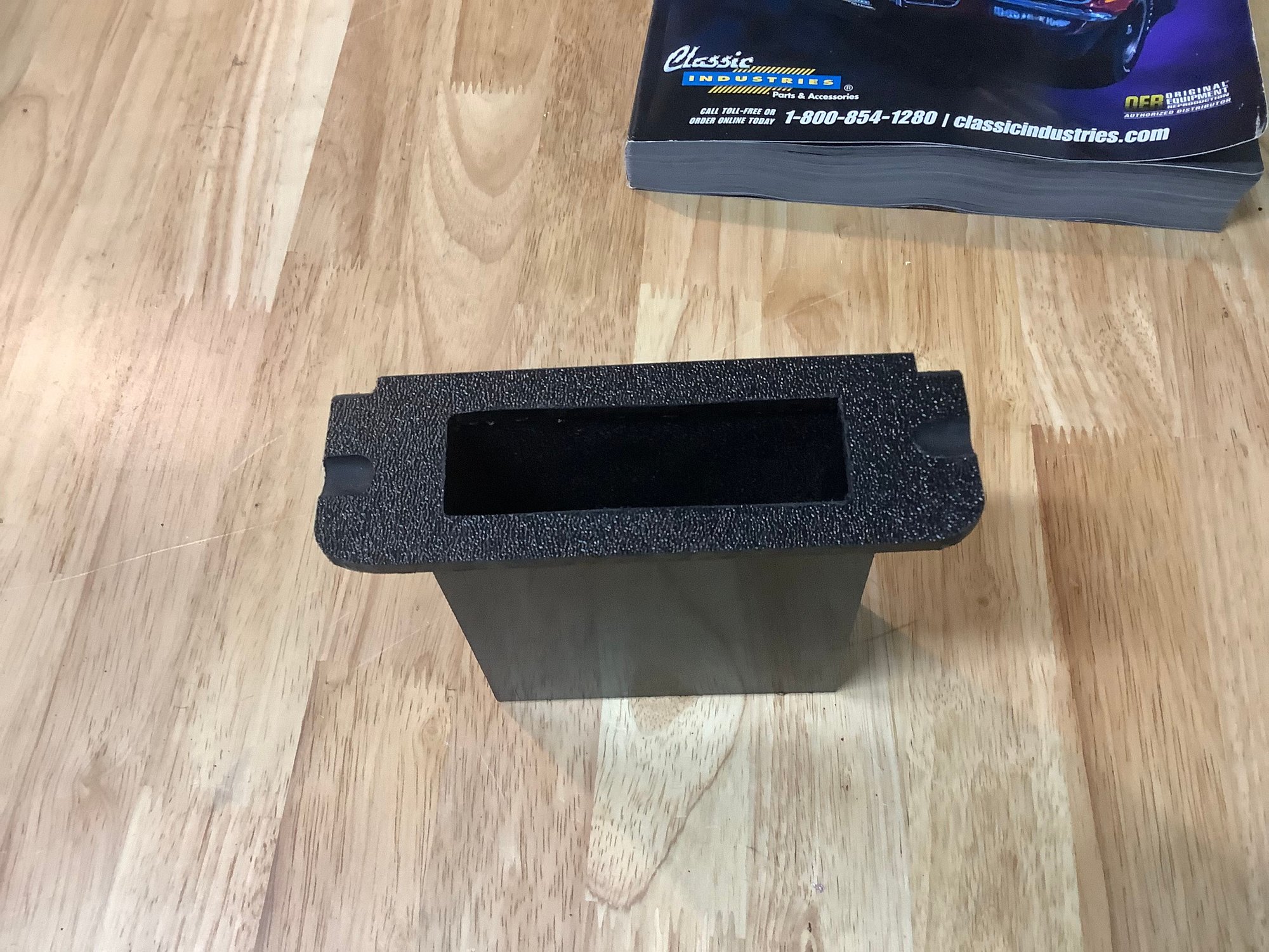

I solved my problem of no great place to keep my phone while driving by repurposing the console ash tray.
The final product

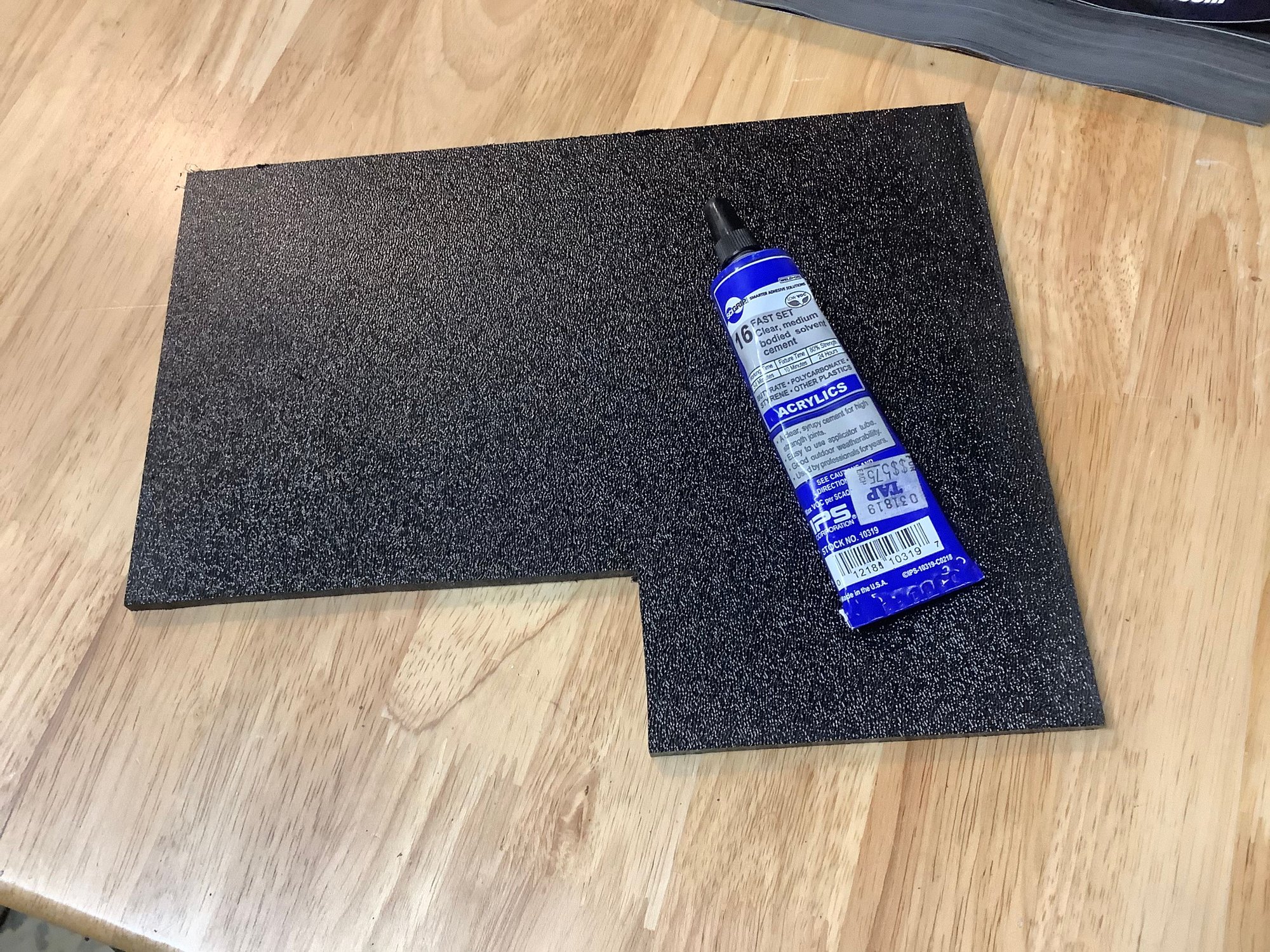

The material, 3/16th textured acrylic sheet and acrylic glue. I used my table saw and jig saw for the cuts and then filed the edges smooth

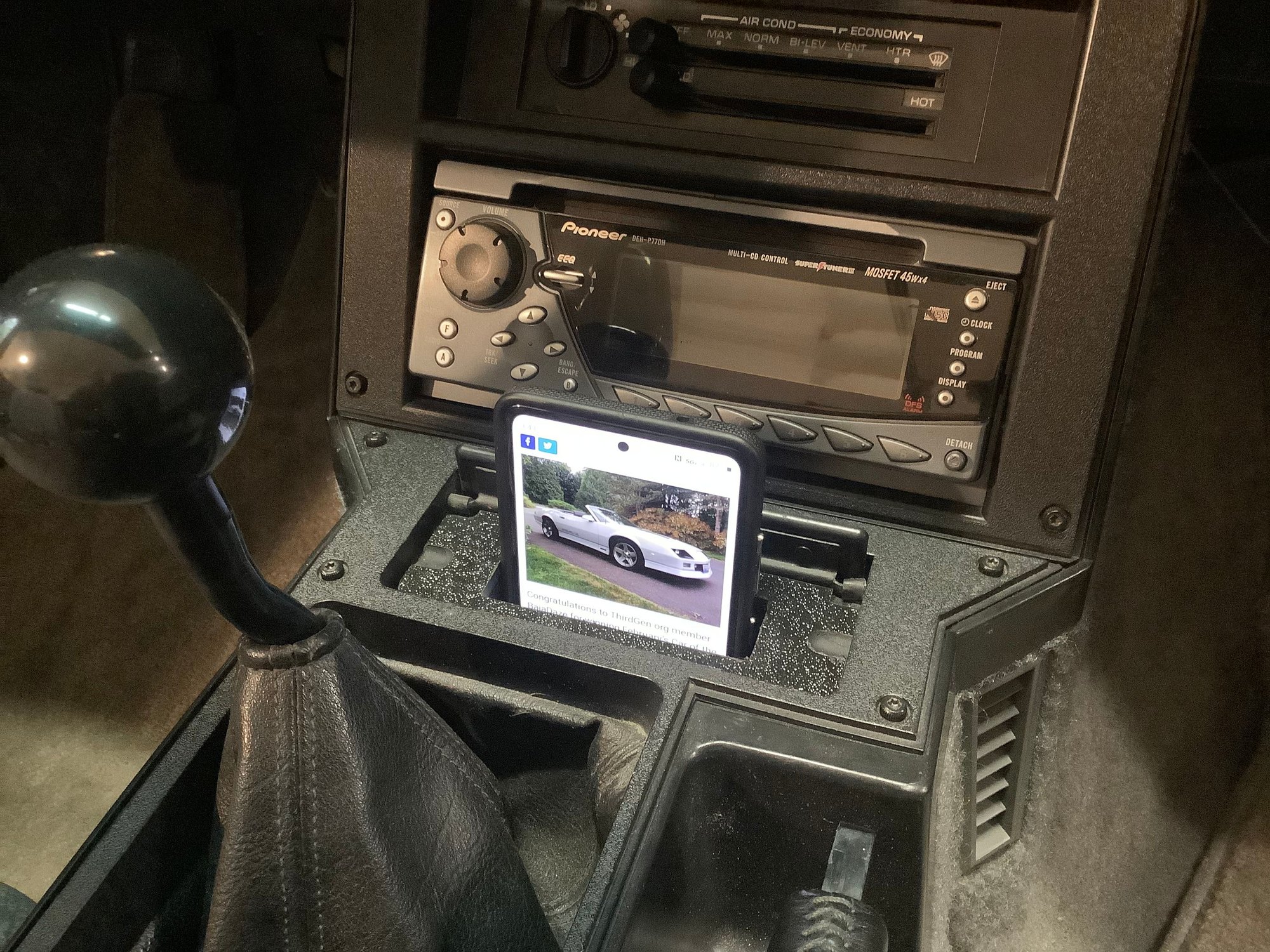

In use, what an awesome car in the pic😀

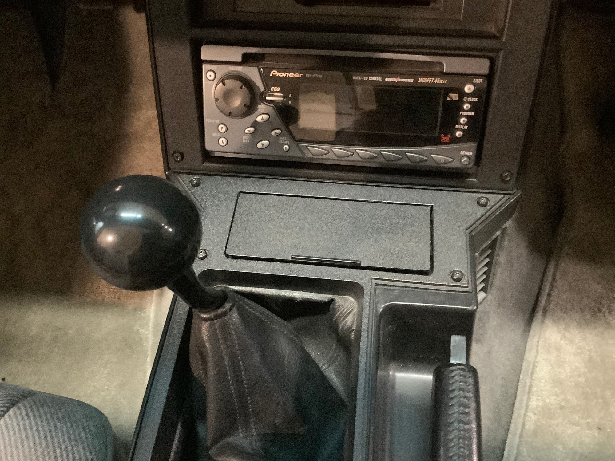

With the stock lid closed
