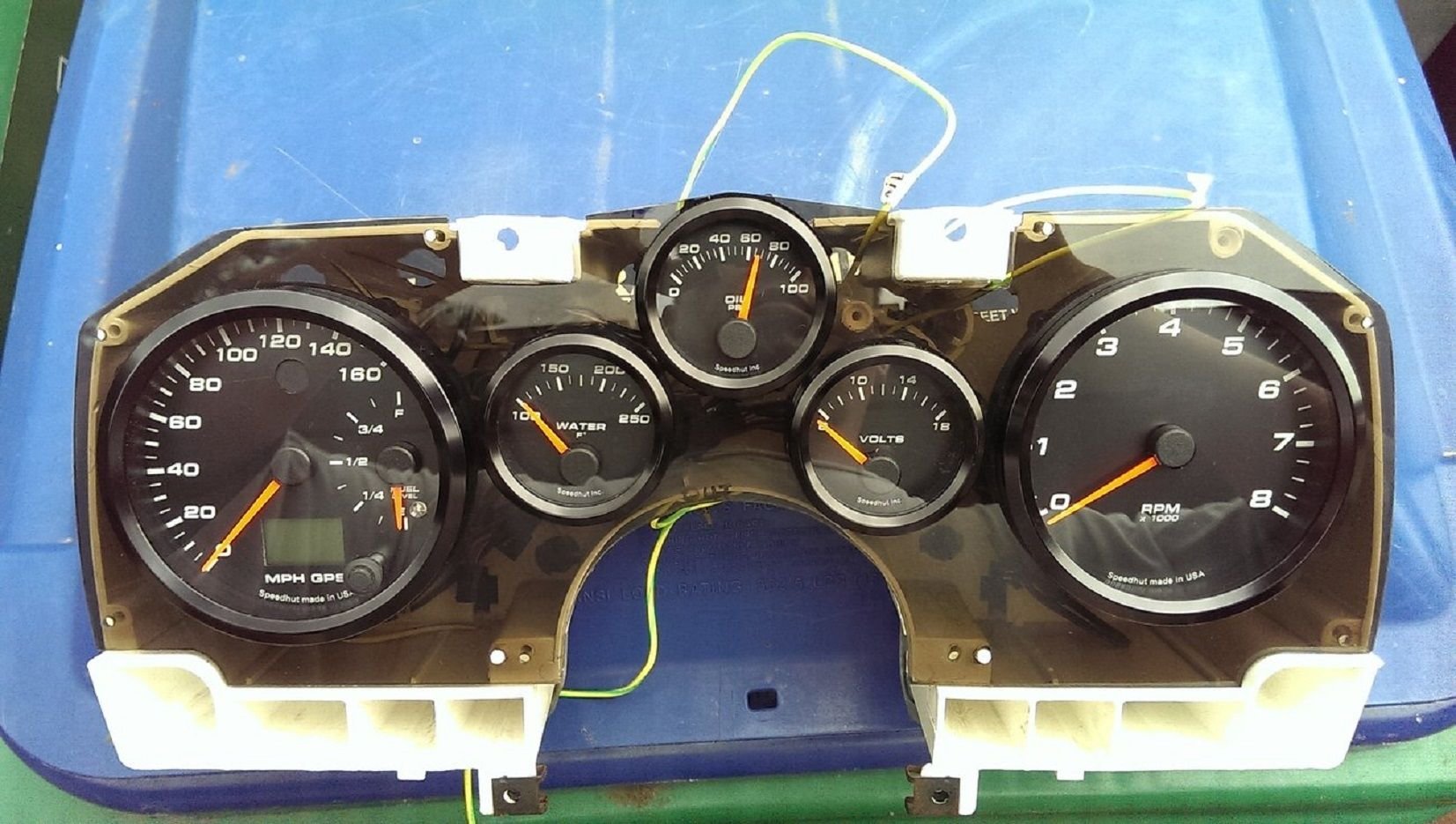

I too have the speedhut gauges in my car. I absolutely love them and they were super simple to install. All running on their own sensors . Photos in signature link.

Originally Posted by DoyleP
Wow how beautiful. I love those gauges. How did you mount them to the original dash? Is that perhaps Sheetmetal they are mounted to and cut to fit the dash? I am hoping to find something that just replaces the original gauges but that does not seem to be the case.
Not sure if you're asking me, but they're mounted to the OE cluster. I cut some plexiglass to fit the cluster and squeezed the gauges in. Its a snug fit, but all the speedhut harness's are in there too. The bezel was hand cut from a ABS sheet from ebay. I think its called mo-hair or sommit. The insert piece on the horseshoe is made from the same sheet.

Re: Digital Gauges Upgrade
speedhut will fit in the factory gauge housing

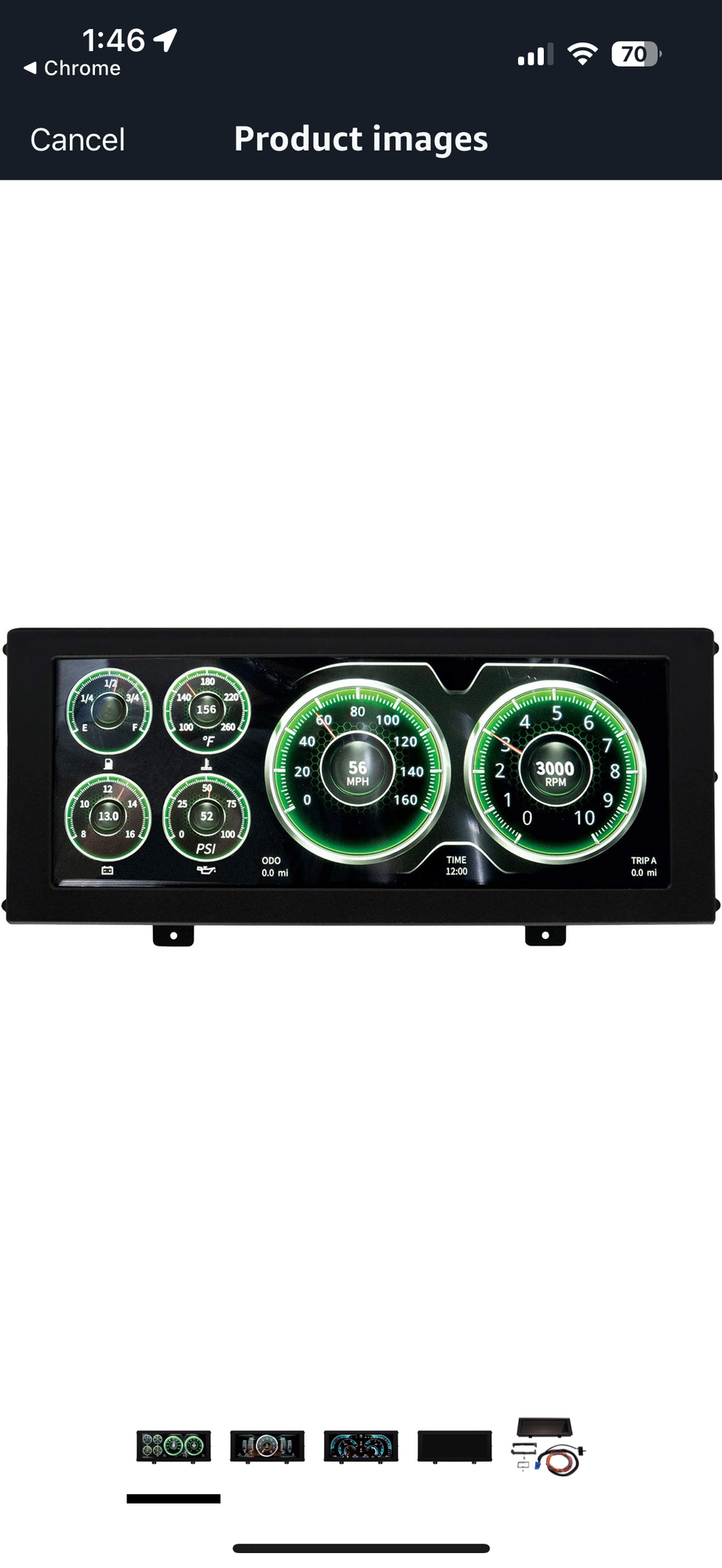

Old Feb 11, 2025 | 01:01 PM
89IROC/2A's Avatar
Joined: Jan 2025
Posts: 3
From: Louisville KY
Car: 2015 Silverado. 1989 Camaro IROC
Engine: 6.2 LT1
Transmission: 8Speed
Axle/Gears: Third gen factory
Re: STAND ALONE ONE GAUGE 1989 Camaro LT1 Swap
see if anyone has attempted this..
I am looking into getting one of these stand alone “one gauge” universal digital gauge clusters for my 89 Iroc. Any ideas? Does anyone know of an easier way? I want the newer digital version with informative options and customization options. Mostly I haven’t seen it done before so I thought it would be cool.. maybe there’s a reason why it hasn’t been done lol
Old Feb 11, 2025 | 03:01 PM
battmann's Avatar
Joined: Jul 2006
Posts: 1,290
Likes: 526
From: Rochester NY
Engine: LG4 / turbo LQ4
Transmission: 700R4 / 4L80E
i definitely like the look of that universal cluster but i assume it won't fit our cars very well. our gauges have the steering column "hump" in the middle. i don't think there'd be enough room to mount it above the steering column so a large panel gauge display like this would need to be mounted off-center - which would look odd. those displays are more for like old trucks that have a lot of dash space.
