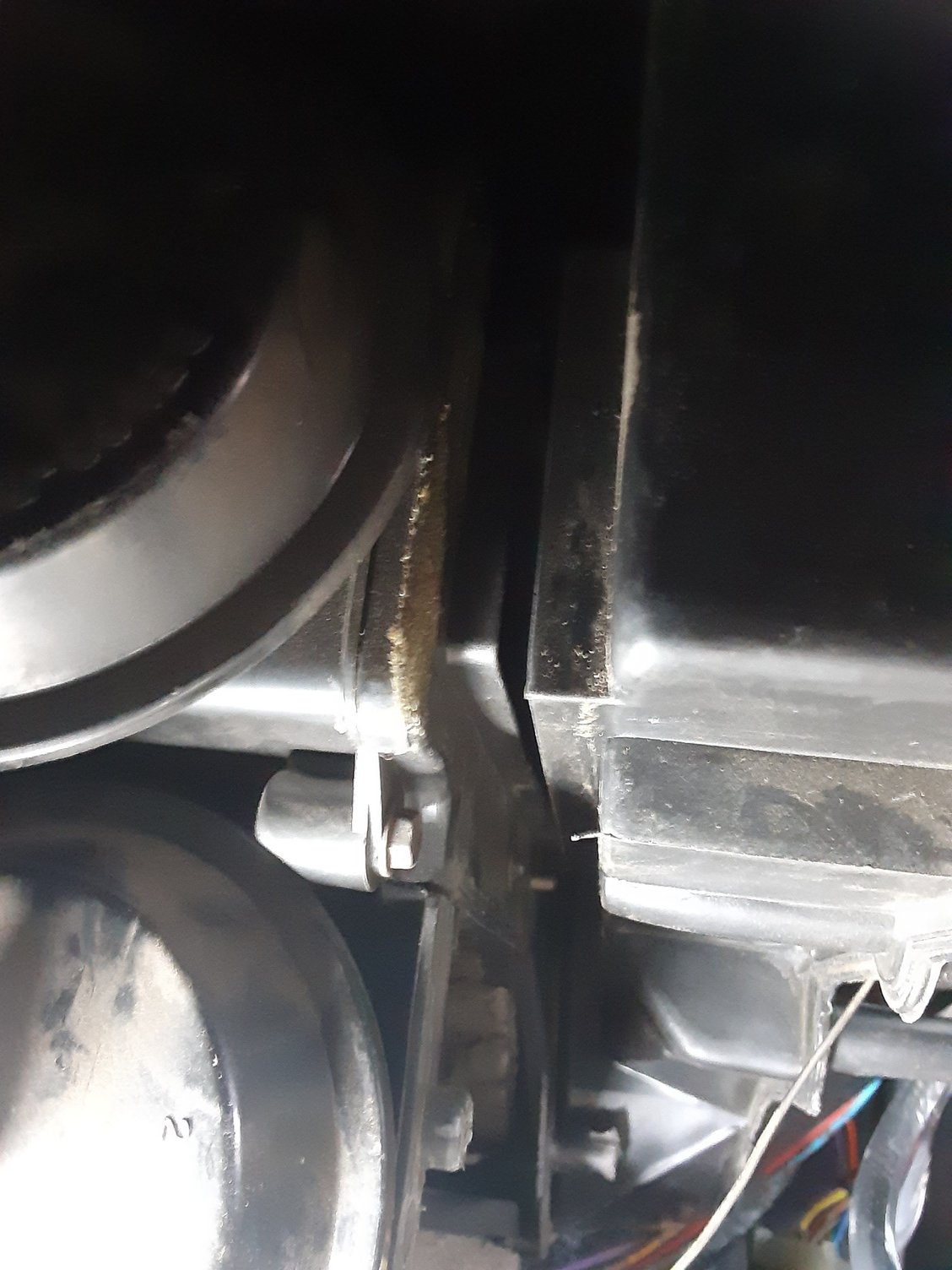

drivers side   left to right heater box attached to fire wall  heater box attached to dash
drivers side  looking up see rubber membrane stopping movement of dash side heater box toward firewall

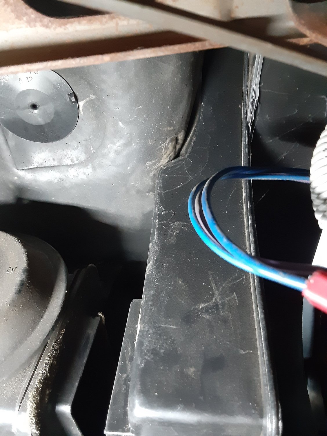

passenger side split

Pictures and an explanation as to whats happening. the heater box is split. the heater box has been worked on before i bought it. the rear section is attached to the firewall the front section is attached to the dash ( 2 screws under cruise control plate) . So far i pulled the console, dash top and several of the heat tubes. i still see no way to get them together. Drivers side is the side giving me trouble as the split is worse . Looking up there is a rubber membrane that will not allow the top to move toward the firewall. I see no way the Dash will move far enough to close up the gap.
All right now i will ask any ideas such as was the heater box shimmed away from the firewall ect. anything is possible since the car was worked on before.

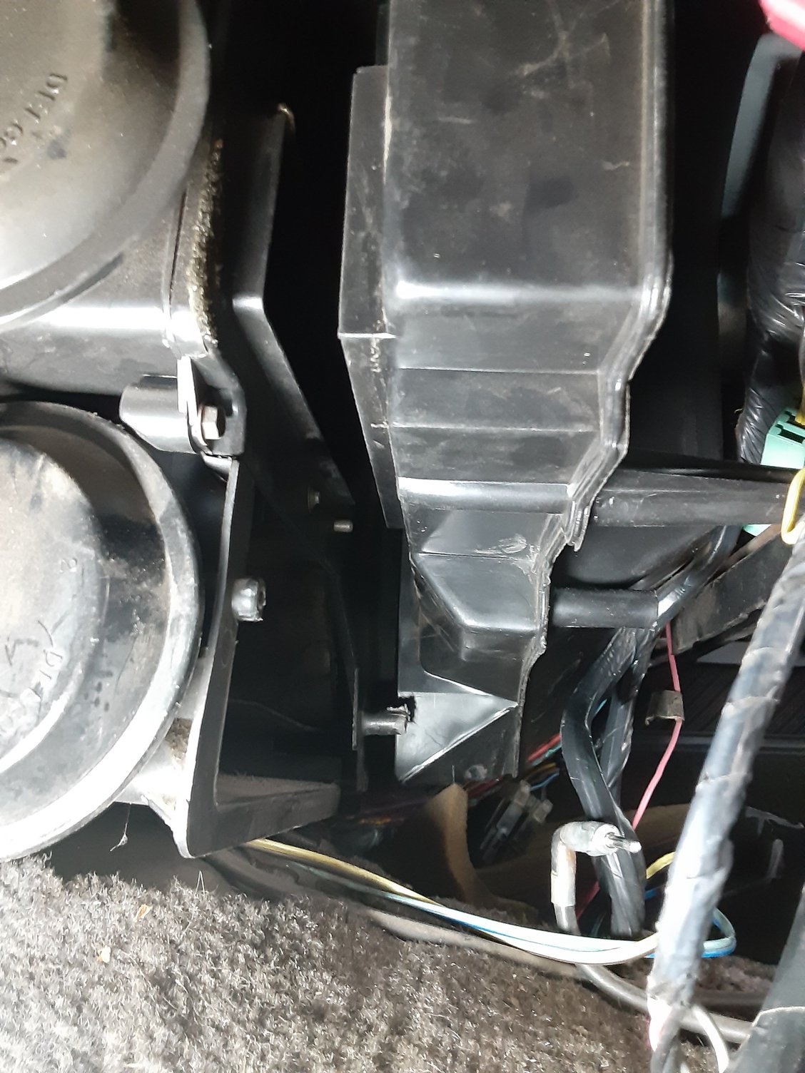

I
closer than before but not there yet

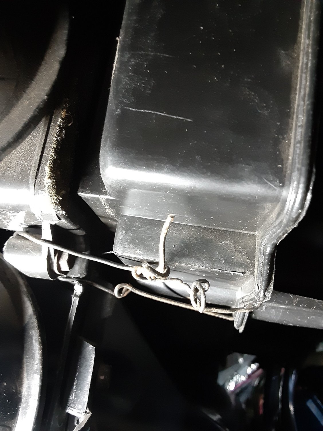

Mechanics wire for a tight fit.
found my notes on 84 camaro when i bought it 15 years ago. No comments on heater box so i am assuming that it has been split all this time. Using heat, movement and a little force i got the box to the point of the first new picture. Problem is what i think is sound dampening has gotten hard and sagged. Applying heat and a little dry lube, over time it made it so i could move the two halves together. Problem is the rubber still has a habit of splitting the box in two. Third picture shows my temporary fix, mechanics wire holding it together. In a year or 15 I thing my wire can be cut and it will stay together.
