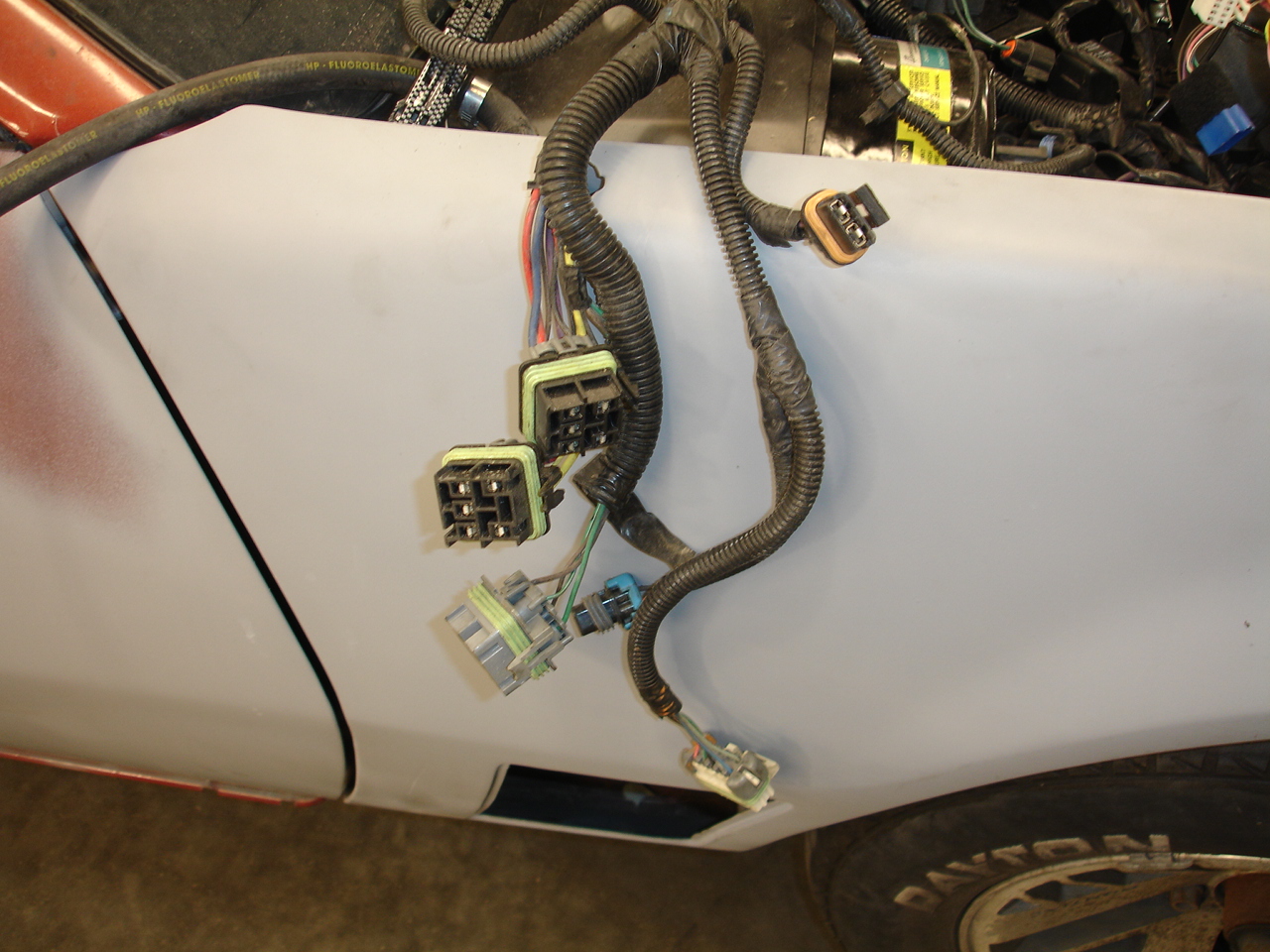

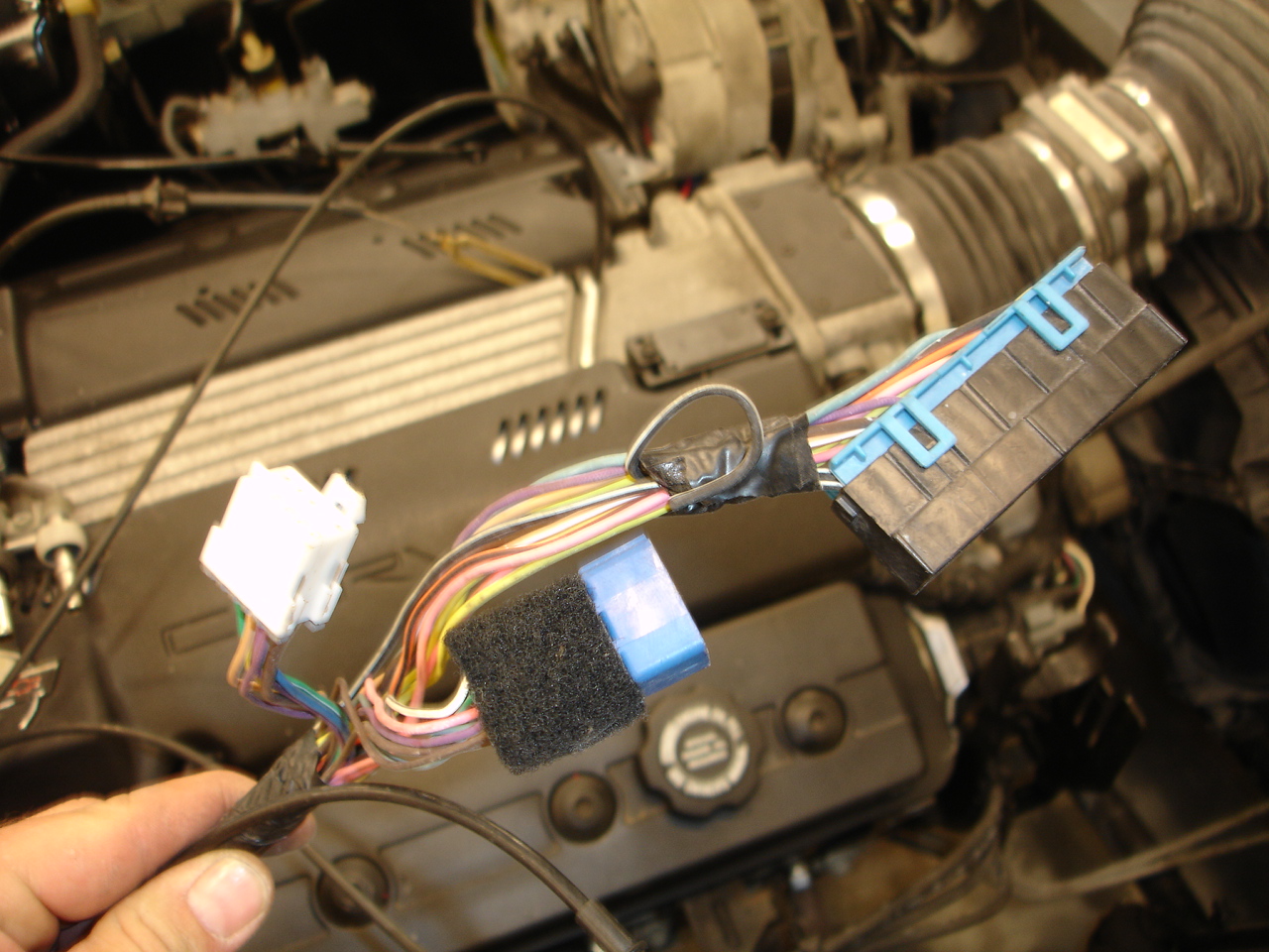

Attached below are pictures of the wiring harness I'm using. Most all the info I'm reading concerns the f-body wiring harness. The corvette harness is different. Could you all tell me from my pics which are the plugs I need to be looking at? From the pictures I've looked at on shbox.com, i think I know which one is the c220 and c230. Thanks for the input.

That's a good question, it looks like the corvette harness is totally different than the F-body harness. The white and blue in the third picture is the C220 and C230, and I believe that the one in the first picture with the tan weatherpack on it is the C100 that goes to the PCM.
