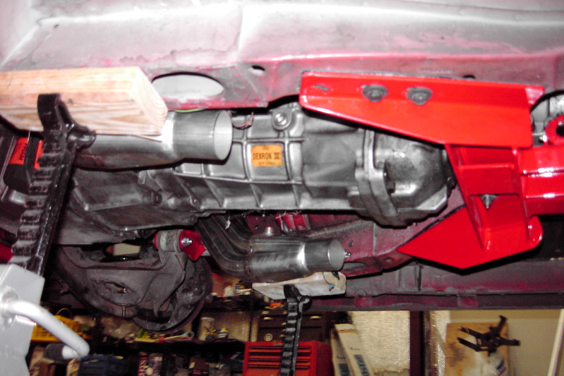

I'm running the Spohn T-56 adjustable Tq Arm.
As you can see, the place that did my exhaust had to cut it all to hell to get enough clearance for my 3.5 inch Y-pipe
