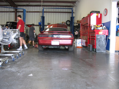

The car's been at ARD now for 13 days. I went by on Friday to see how they were progressing (they've got alot of cars going through there!). They were finishing up the suspension and exhaust. I got to stick around for them to try and start it...seems like my fuel pump isn't working. My fuel gauge isn't working either, so I'm wondering if there's something wrong with the fuel pump canister wiring (they put power direct to the harness in the rear and the pump never started). Next up on the list is a new pump :-/ . Also, my custom VSS setup off the rear end had to be taken off as the new UMI torque arm was in the way. They believe they can use the input from the 700r4, and I'm hoping they can - but everything I've read points to EFILive not going low enough to accurately use that vss signal. We'll see....I'm not sure what to do if they can't use it...
So far - ARD has been good to deal with. I wish they had gotten to the car sooner than they did, but I'm not on a tight schedule and just feel like a kid at Christmas. The work they had dont on the exhuast was top notch, and I don't believe I've seen others use this routing before - it's just sick! Here are the pics of exhuast, and the new height with all of the suspension work
Jay at ARD said this is the way he ran the exhaust on his LS1 swapped IROC.
Here you can see the stock-like clearance (with an automatic!) and the cat. I hope to get this to pass the sniffer test...not sure yet what I'm going to tell the guy inspecting it though.
The exhuast consists of stock 01 manifolds, 2.5" pipes to a 2.5" to 3" flowmaster Y-Pipe. This goes into the cat and then over the rear axle to my old Hooker SuperComp muffler. We finished it off with some Hooker Dual Angle Cut tips w/intercoolers (or whatever they're called)
Here you can see the new height with the springs/suspension. I'm liking it
New fuel pump should arrive on Tuesday, and I hope to hear some good news shortly thereafter. I've been impressed thus far with the quality of work done by ARD, and their knowledge of the LSx platform and the thirdgen in particular. They were kind enough to let my father and I hang out half a day on Friday just watching them work on the car!
