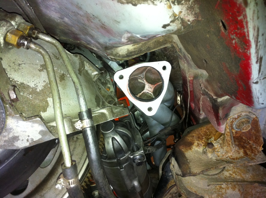

Well, it seems i will be opening one side up to the 3 inched it can actually go as the 2.5 is a choke point and can e bigger, the other side will be altered with a flange, but here is some pics:
They did go in like they were made for the car, i dont have any pics of the EGR parts chopped and welded up, didnt think it was needed, but here you can see how far you can go on the driver side to open it to a 3 inch inlet with a grinder:

Here is the pass header ground out with the carbide bit:
Then swapped the flange on the driver side:
Should flow allot better i think.

Looks good dude, Any below the car pics and closer to the header pics? BTW.... LMFAO at that 30 Foot radiator hose.
I will take some pics from the underside today for you. The hose is what it is till i get he odler water pump, the one in the pic has a outlet angle i cannot change like the older one my 89 has.

Undercar pics AND VIDEO:
