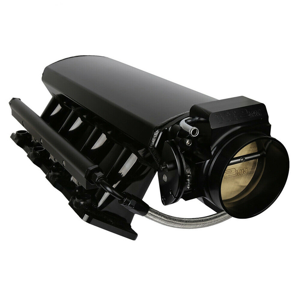

I bought a 102mm throttle body and intake combo off ebay to help it breathe a bit better, not sure how good they are, but at a 1/4 of the price of a fast intake I'll take my chances.

Also the intake while good quality had a few high spots in the intake tunnels, so I just had to deburr the weld spots and smooth them out a bit, but a quick hit with the dremel fixed that up.

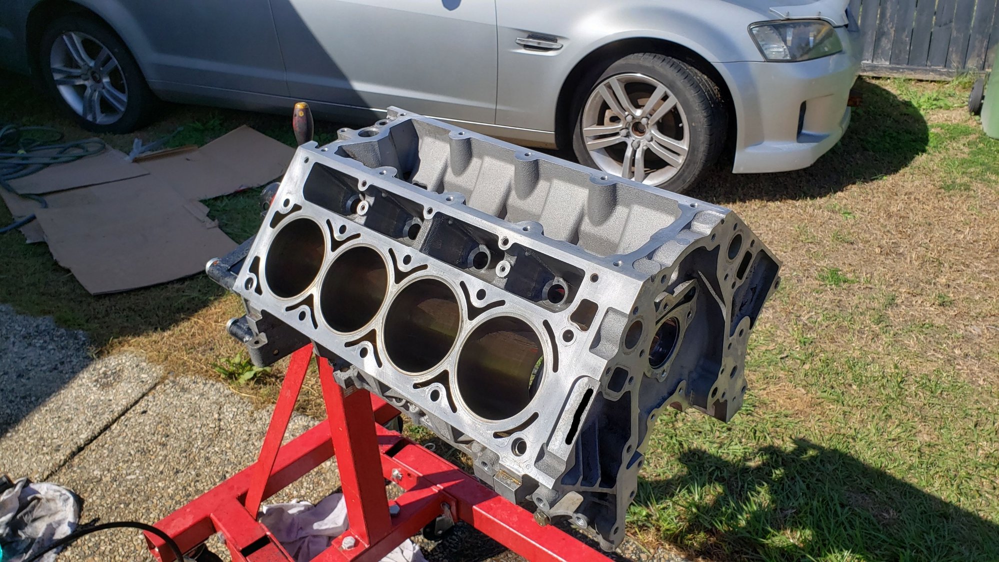

So motor has been stripped down and everything cleaned.
Pistons and bores all looked good, bearings could have kept going but will replace them all out anyway, not much sludge or deposits and crank is in good condition as well.
I have the cylinder a quick flex hone to take off the gloss, but was a little too gentle and need to have a another go to finish it off. First time using a flex hone and was worried the surface wasn't smooth but since found it needs to be a bit rough to seat the rings. Its a 240grit flex hone so should be good after another pass.
Everything else should be ready to assemble, but for now the hold up is the heads.
