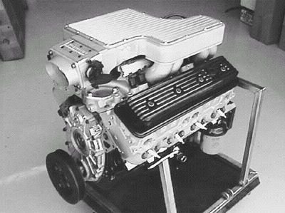

Lingenfelter Accel lt1 superram base rare or not ?
Is this a rare piece ?
if so what should it fetch. Moderators please move if not in right section.

LT1 wouldn’t have distributor provision. Nice piece though

As far as I know lpe took the 74197 as a blank casting .
drilled the lt1 bolt pattern and blocked the side egr and used a thermostat housing block off plate.
the distributor hole could be used to get rid of opti or a expansion plug could be used in its place.
thats why there is a distributor hole.

Yep its rare not sure of its value though.. Yes the tpi and lt1 base starts life off from the same casting.
