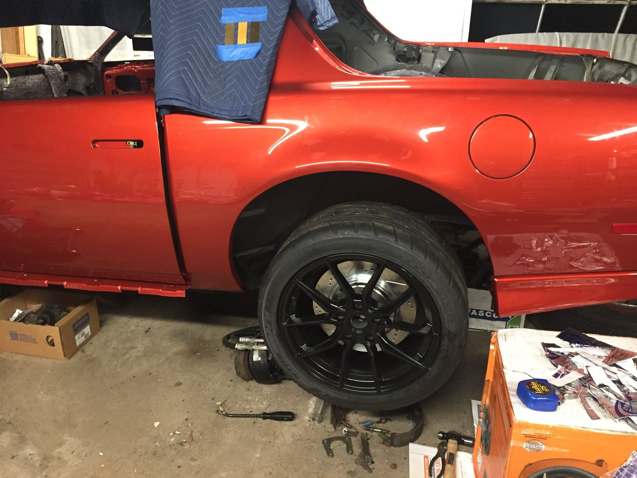

I was able to fit the car on the rotisserie by making custom mounts and removing one of my exhaust fans, it literally came down to an inch. Really happy I was able to make this work as it will make things much easier. I was also able to get the fuel tank mounted so that I could appropriately place my fuel tank access panel. I got that fitted and just need to weld that in.

That’s tight! Never really u see stood the fuel access door. How often are people changing pumps? I’ve had maybe the original pump die on one of these cars ever but generally I upgrade them and don’t have to touch them ever again. If you really need more fuel than a single 455 or 525 your prob better with an external and a dumped tank anyways.

Its more about dealing with leaks at the pump and wiring that I want to have access to. I'm running a 5th Gen ZL1 pump and Holley HydraMat so its going to need custom wiring for the pump and fuel sender. I really have no intentions of ever replacing the pump but if the HydraMat needs adjustment etc. I don't want to have to drop the tank.

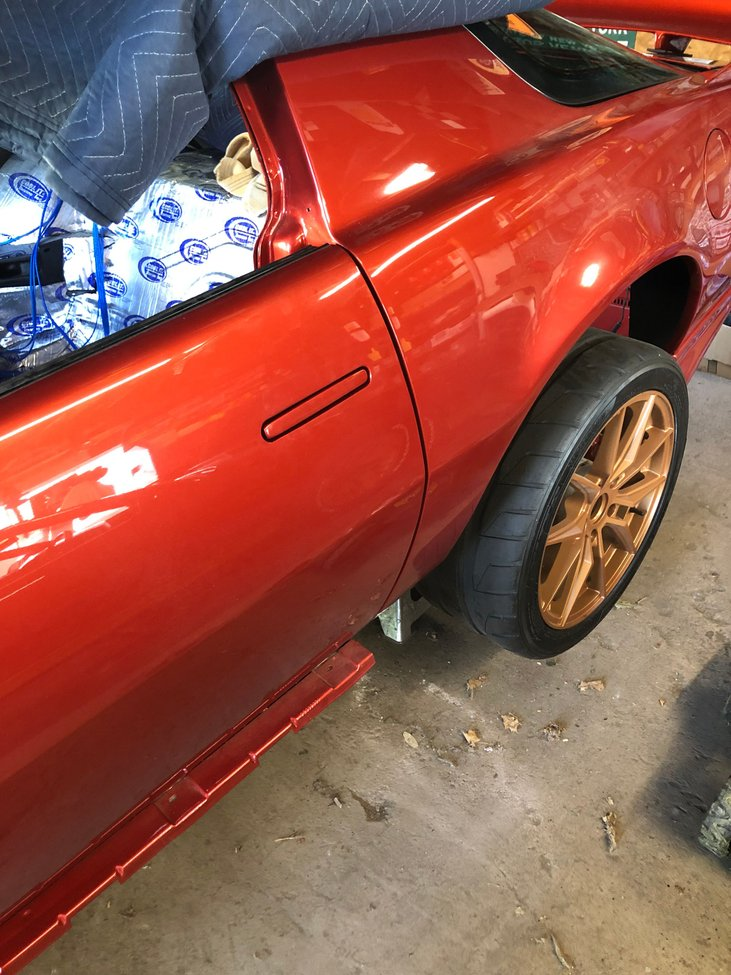

I severely underestimated the damage on the passenger rocker that occurred when it was stolen. Unfortunately I do not have a picture, but the rocker was smashed in so high it pulled the the pinch weld up and I could not get the SFC to seat flush with the pinch weld. I tried a stud welder, vice grip slide hammer and made a custom puller all which failed miserably. Then I decided to buy a pinch weld puller and secure a hook into the concreate floor and use the hydraulics on rotisserie to pull it out. This worked like a charm but I could not believe how difficult it was.
I also got the passenger SFC welded up. These DSE SFC's fit great so far and I love that they tie into the pinch weld and look factory. If your car is stripped down I highly recommend them. I can't say I'd suggested them on a fully assembled car, it would be a hell of a lot of work. I sprayed the mated sides with weld through primer for corrosion protection and will be putting internal frame coating inside the SFC's. Here is the completed passenger side, my welds are solid but not ascetically pleasing IMO.

I was able to wrap up the passenger side SFC which went much easier. Overall I am happy with the results. It will be nice to have a solid jacking point the length of the car.
I also trimmed the center console bracket for the T56 and welded in a support. I used 3rd Gen Guys shifter cut template but it is designed for a stock k-member with Holley mounts. I am going UMI so I just traced the template, located the center and drilled it out as a starting point. I will wait until I have the trans mounted to ensure it is centered before I remove the whole area.
Up next door handle fab...

If I were to do these again I would gut the door. Glass, tracks, motors, everything. When you have the C tab for the latch release welded in, I would suggest trimming the forward tab to clear the glass as it comes down. I scratched my windows before I realized they were hitting that tab. You will use the rear tab for the rod and reuse the plastic clip from the original handles. Feel free to PM me if you have any questions.
Thanks @soloc4 . We spoke on FB about gutting the doors and I think that is the way to go. I am about to start the door disassembly (only one, so I have a reference). I need to figure out the C tab location if it is car dependent or standardized to the handles. To be honest I have not looked into it yet. I will probably reach out on FB as it is easier to send pics. Thanks for the suggestions!

when i installed the kindigit handles, we installed them backwards - you push on the rear and the front of the handle opens out to use. my memory is kinda foggy cause i did this like 9 years ago, but i believe this provided some additional room for the bracket and aligned the rod better above the door hinge.

Subframes look good and your welds are more than fine. I did old school thru floors that i got off jegs (can't remember the brand) but they were designed to bolt to the trans mount. I moved them outwards closer to the rockers before I knotched the stock subframes for dual 3" exhaust. I then fabbed up what looks like rock sliders that tied those into the rocker area for additional strength. Yours look alot better but this was 20 years ago.
Door handles are interesting, I you and Battman are the only times I've ever seen these. I did the S10 handles on a set or doors like 8 years ago and eventually sold the doors and went back to stock. I don't mind the stock handles... they are functional.
