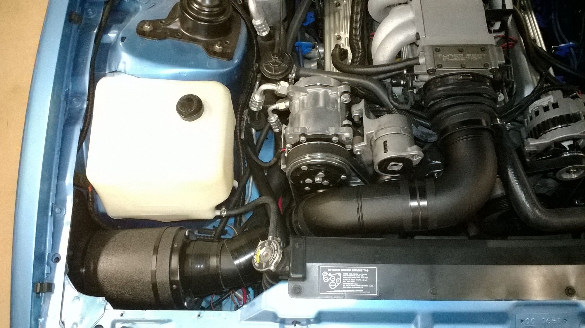

FWIW, this is what I did. Pulls air from the fender...

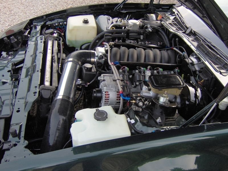

It's pretty easy to make... just 2 45's & 1 90-degree elbow & a straight section of pipe.
Put the stock style MAF in the pipe where convenient with 2 more couplers or if you are into tuning, a 4" system with the cartridge type MAF as shown.
Drill a hole through the battery box & mount the filter underneath it.

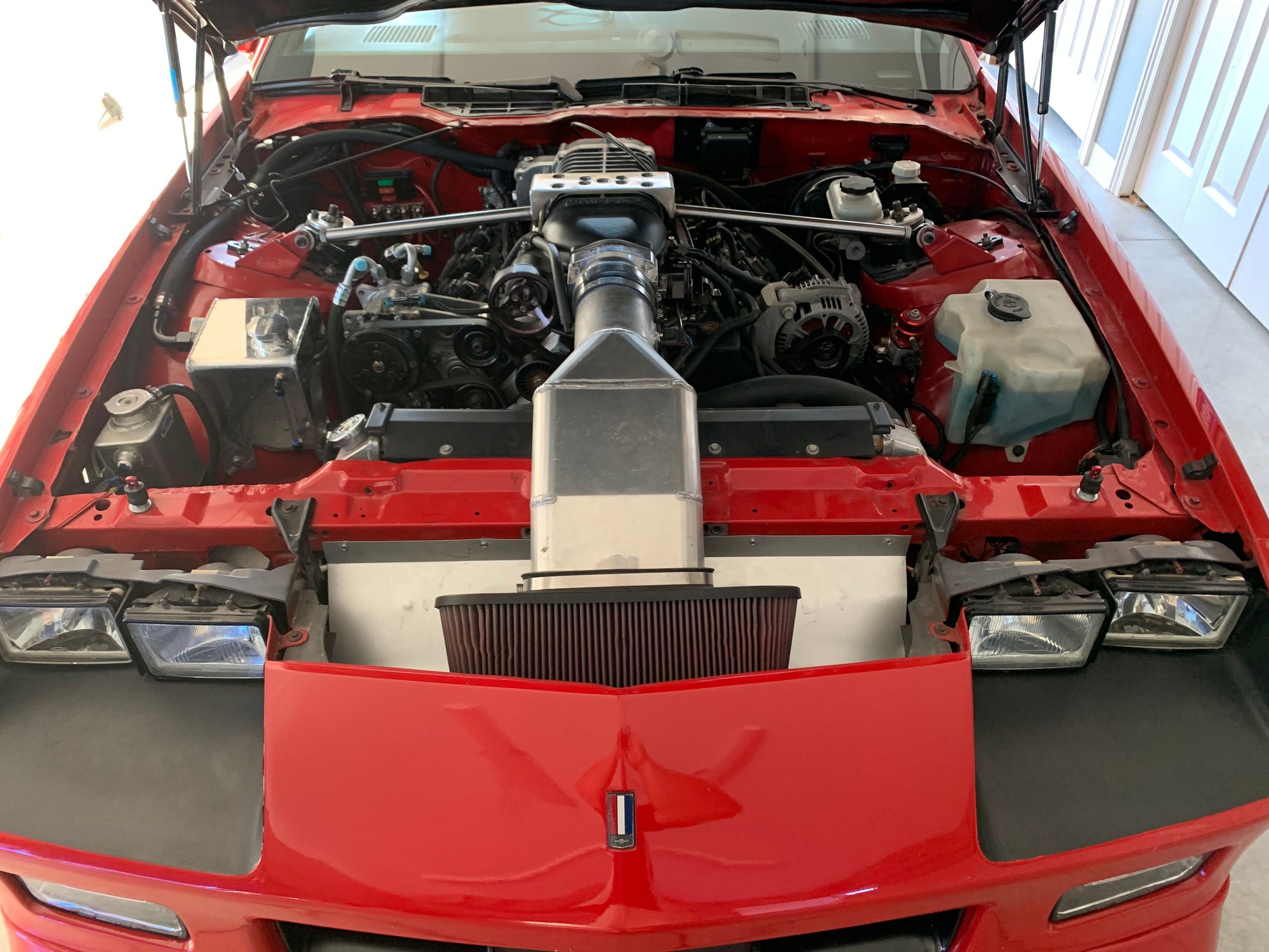

QWK what you have is basically what I had on the LS6 it just went the other direction. Still had the massive cone.
Unfortunately I cant run my air filter under the drivers side battery box because that is where I have my power steering cooler mounted. I may just end up trying to get something built like the the shield DSE car.

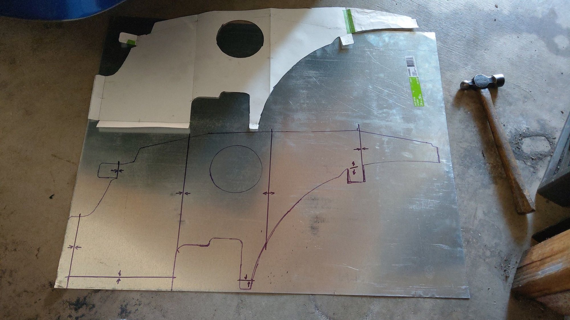

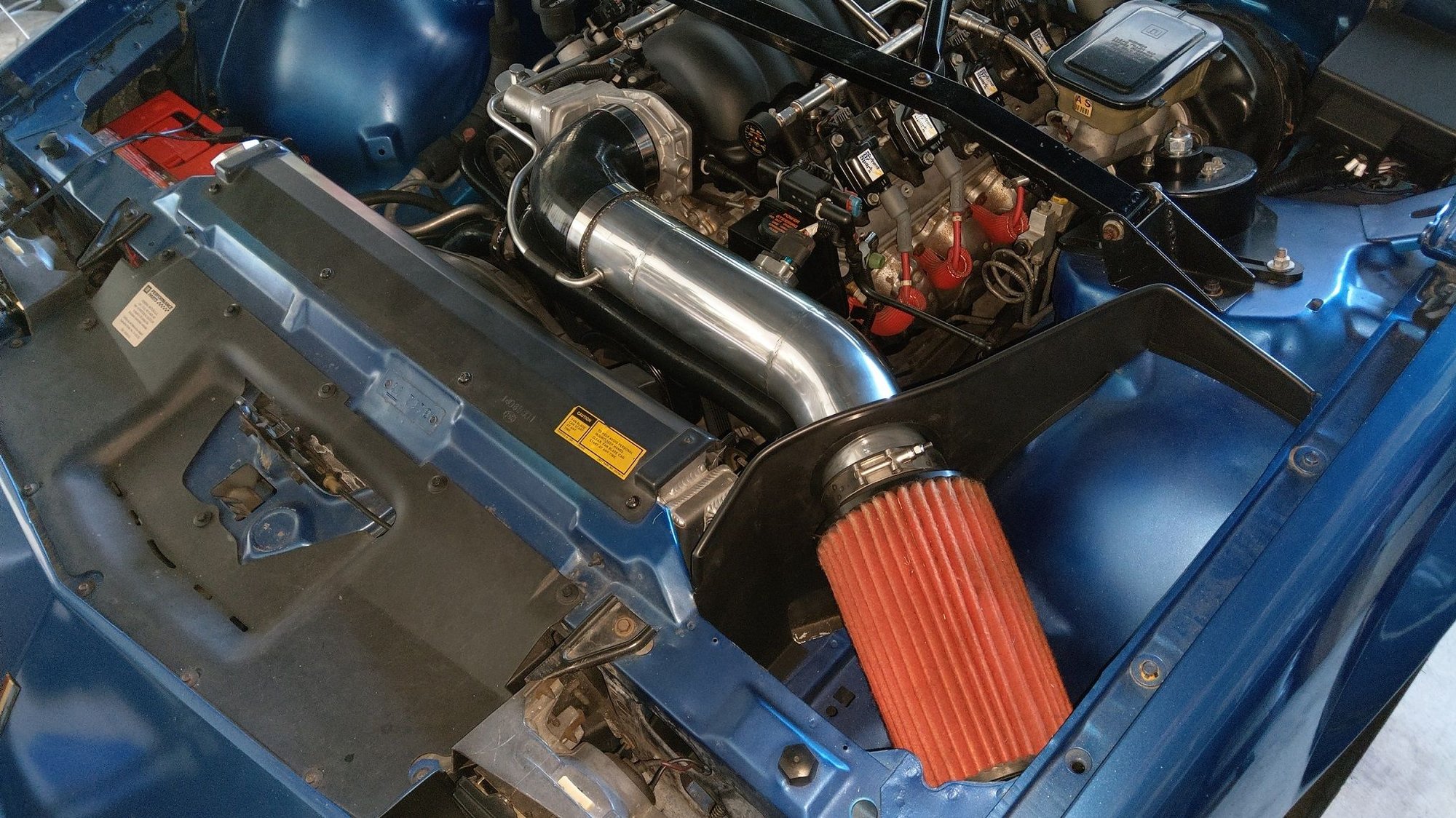

I made a shield from 18 gauge (i think) sheet metal. Tubing, clamps and elbow from silicone intakes. Cut/welded the tubing, 4" all the way.
That filter was replaced with a K&N later on.
