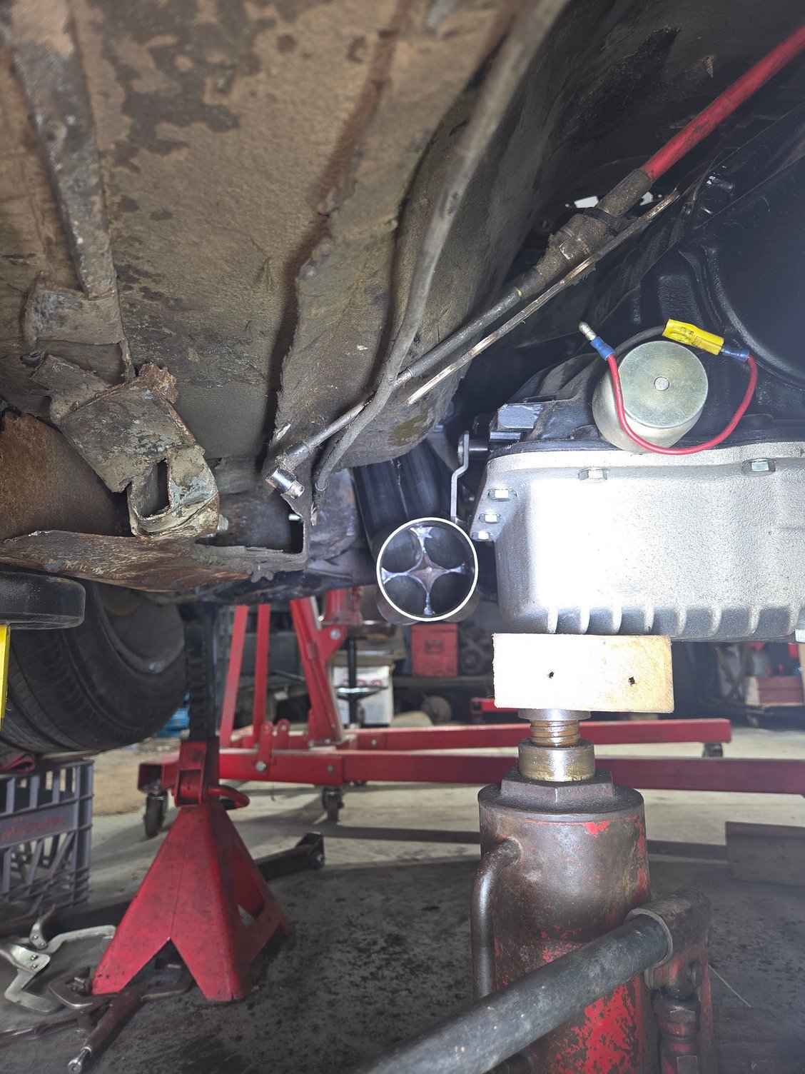

I got the Speed engineering ones, right side fit great, left side not so much. Header hits the oil cooler housing near the oil filter, I know I can get a block off plate or whack the tube with a hammer so that's an issue I can fix.
The main problem is the O2 bung on the collector is too close to the shift arm of the trans. It very nearly hits the arm which would prevent the shifter from going into park. Anyone else have this issue?
There is room for the collector to be shifted at least 1.5" over away from the trans which would solve both problems.
Contacted SE, they advised me of the block off plate and suggested a different shift linkage. Not really too helpful. The collector is still too close to the trans pan, heat would be a concern there, right?
