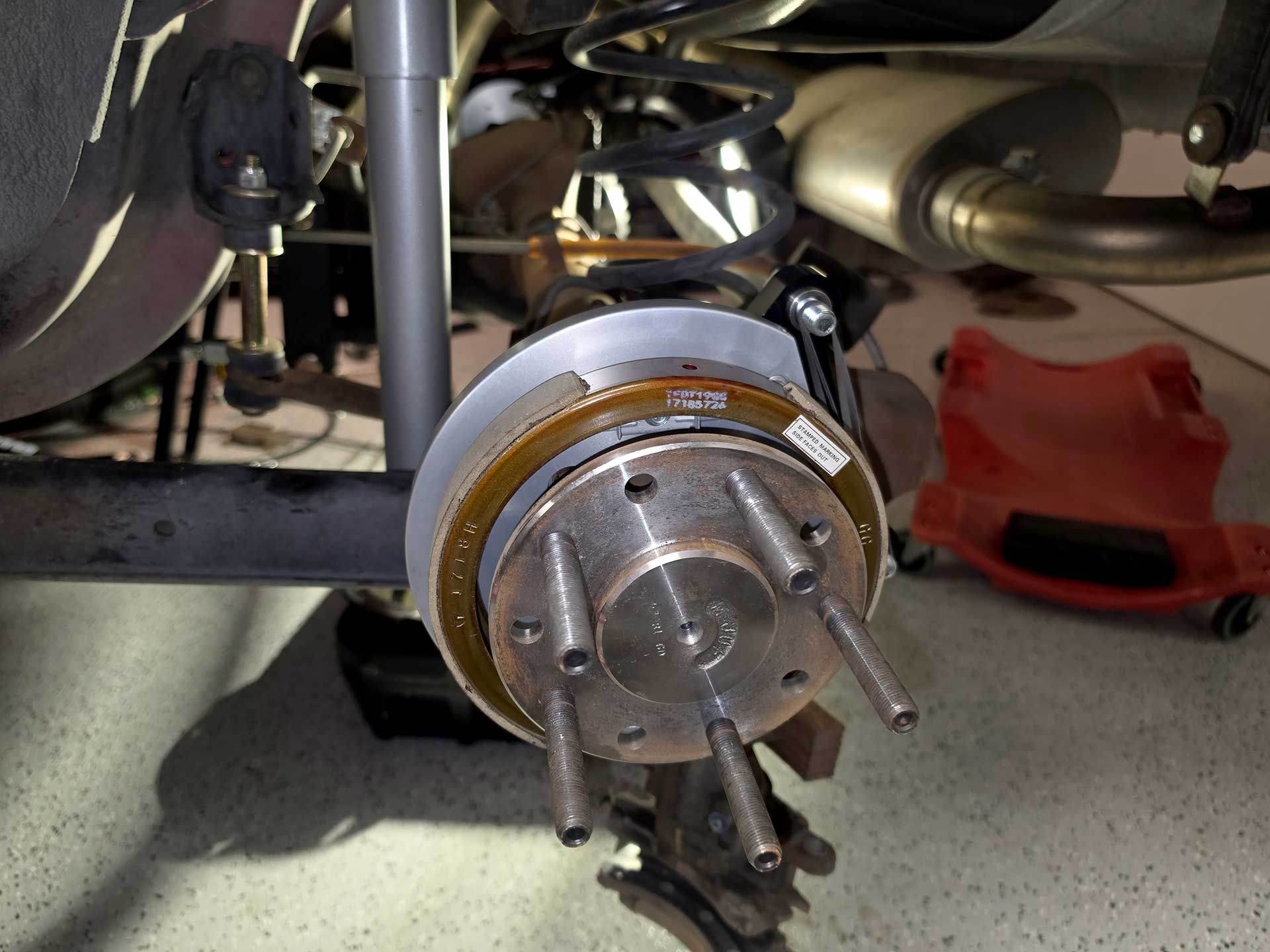

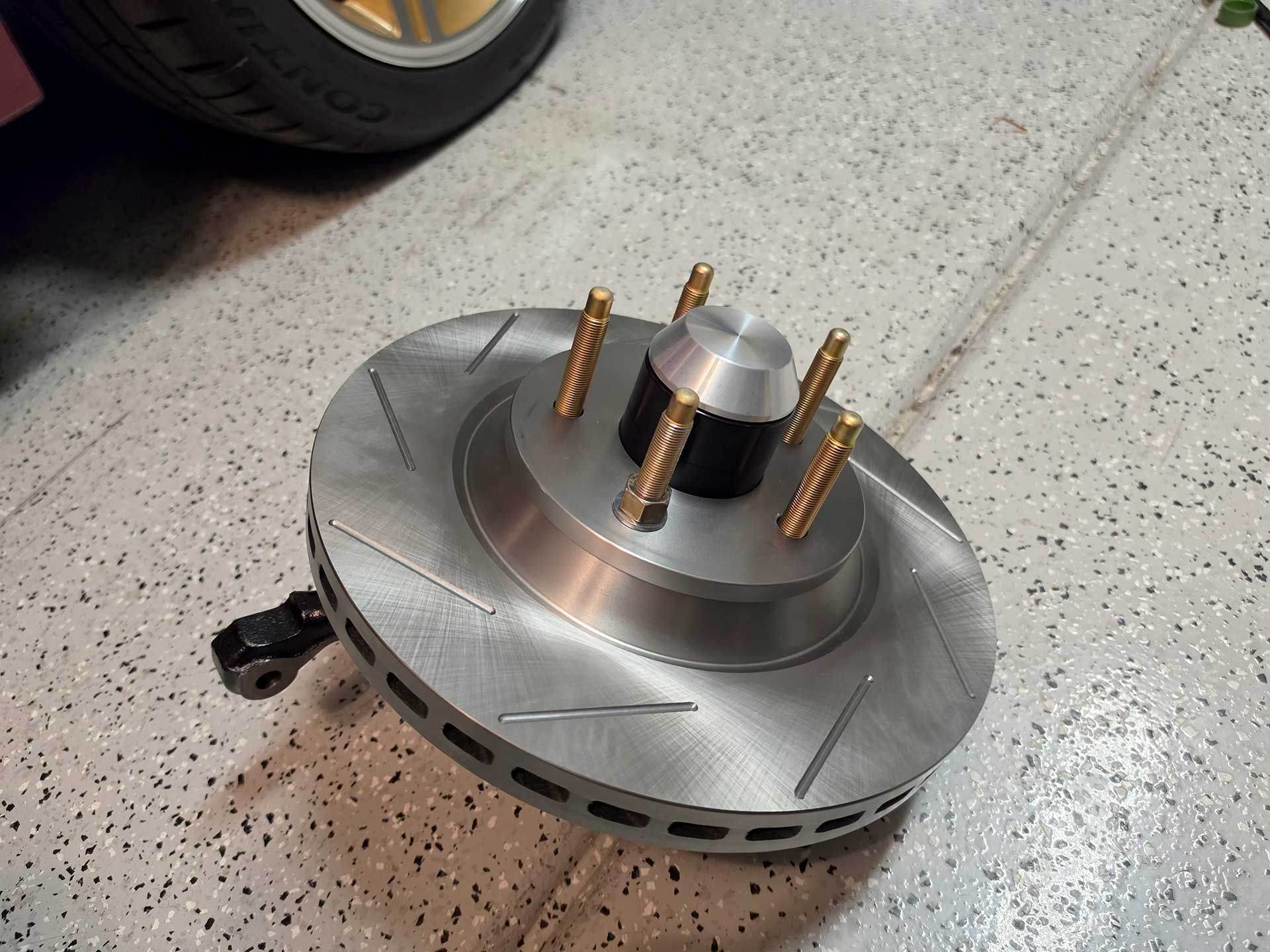

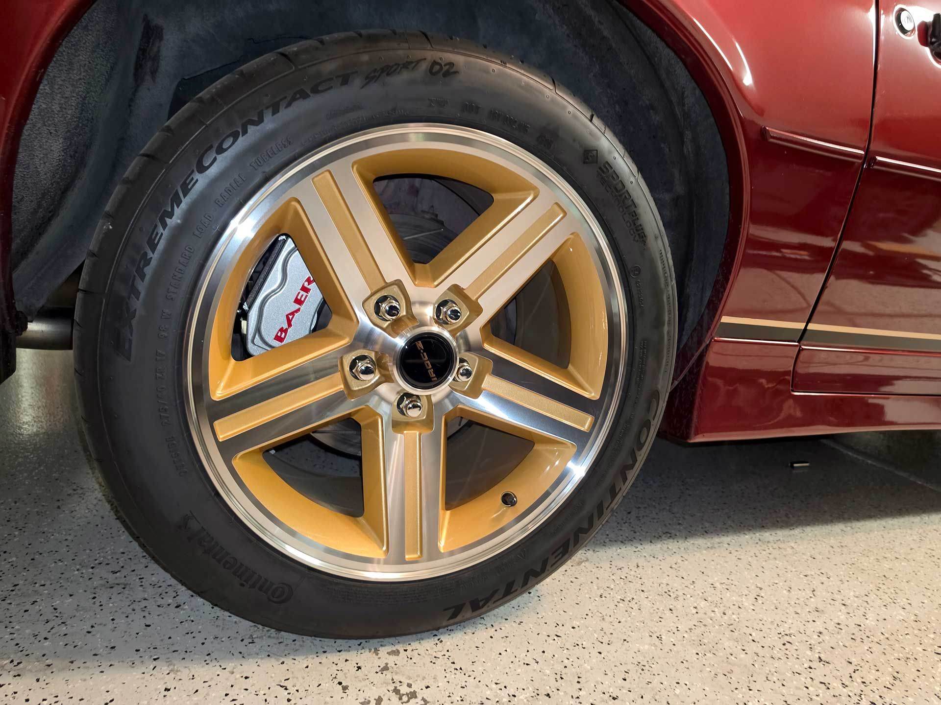

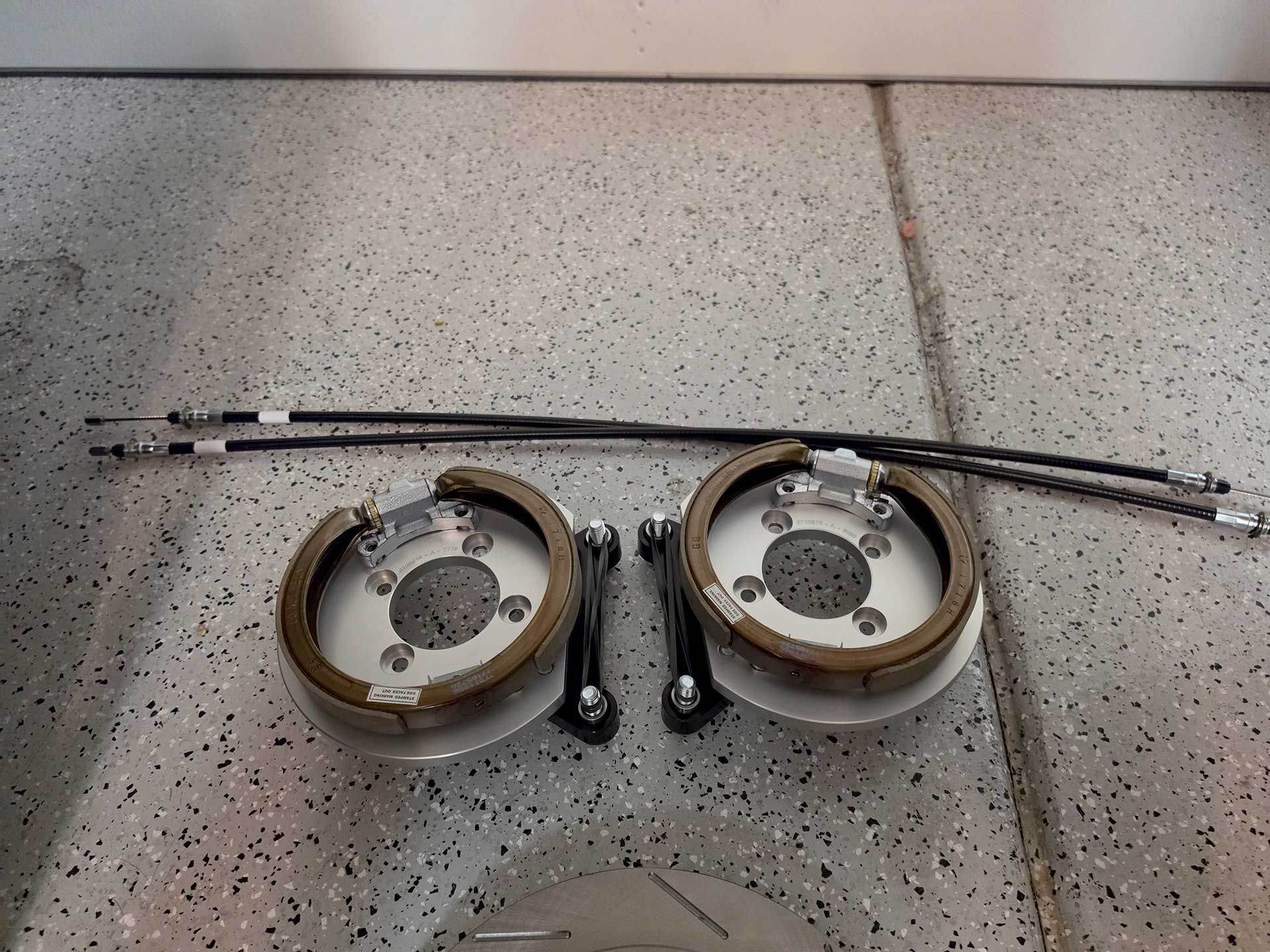

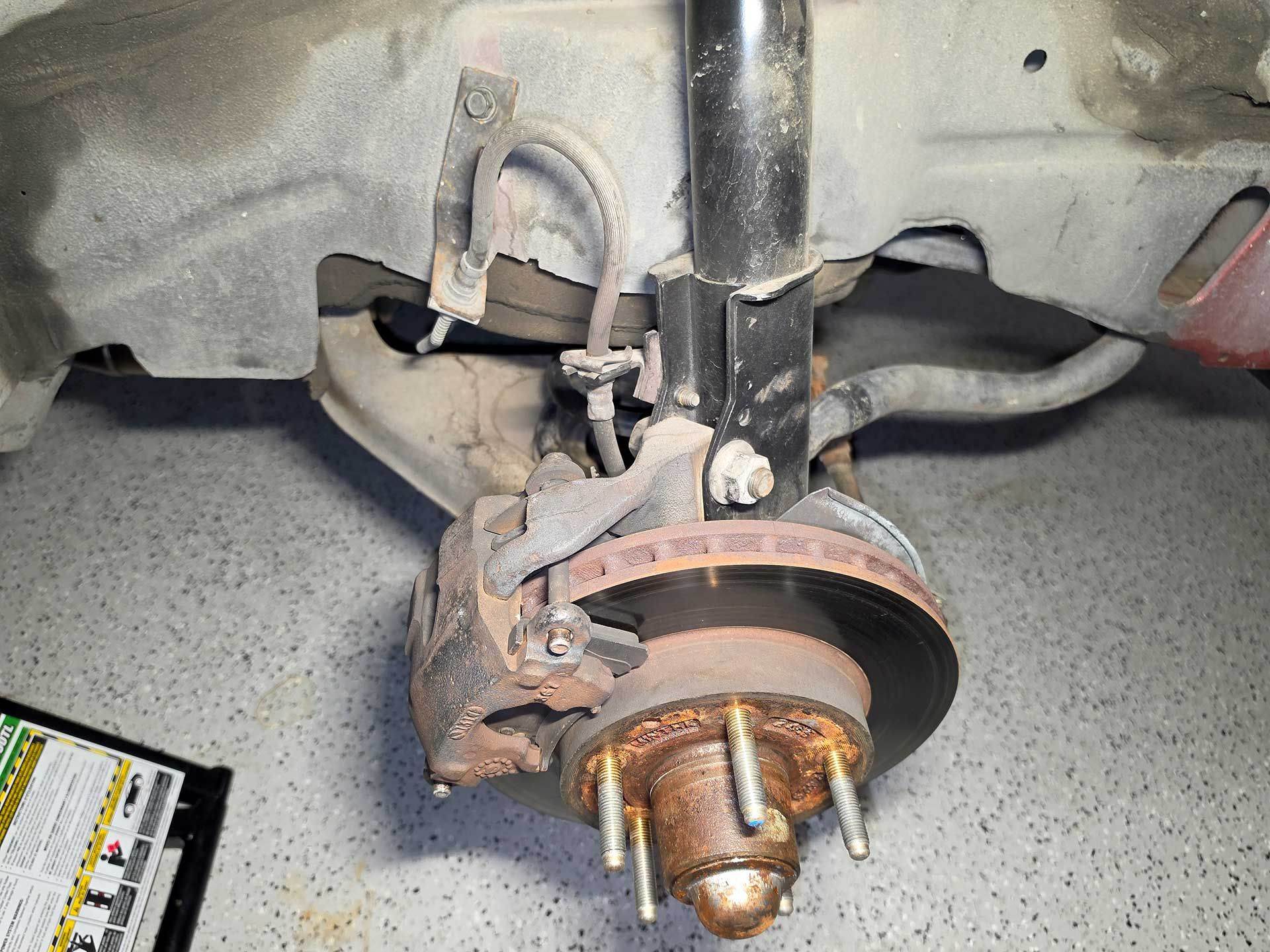

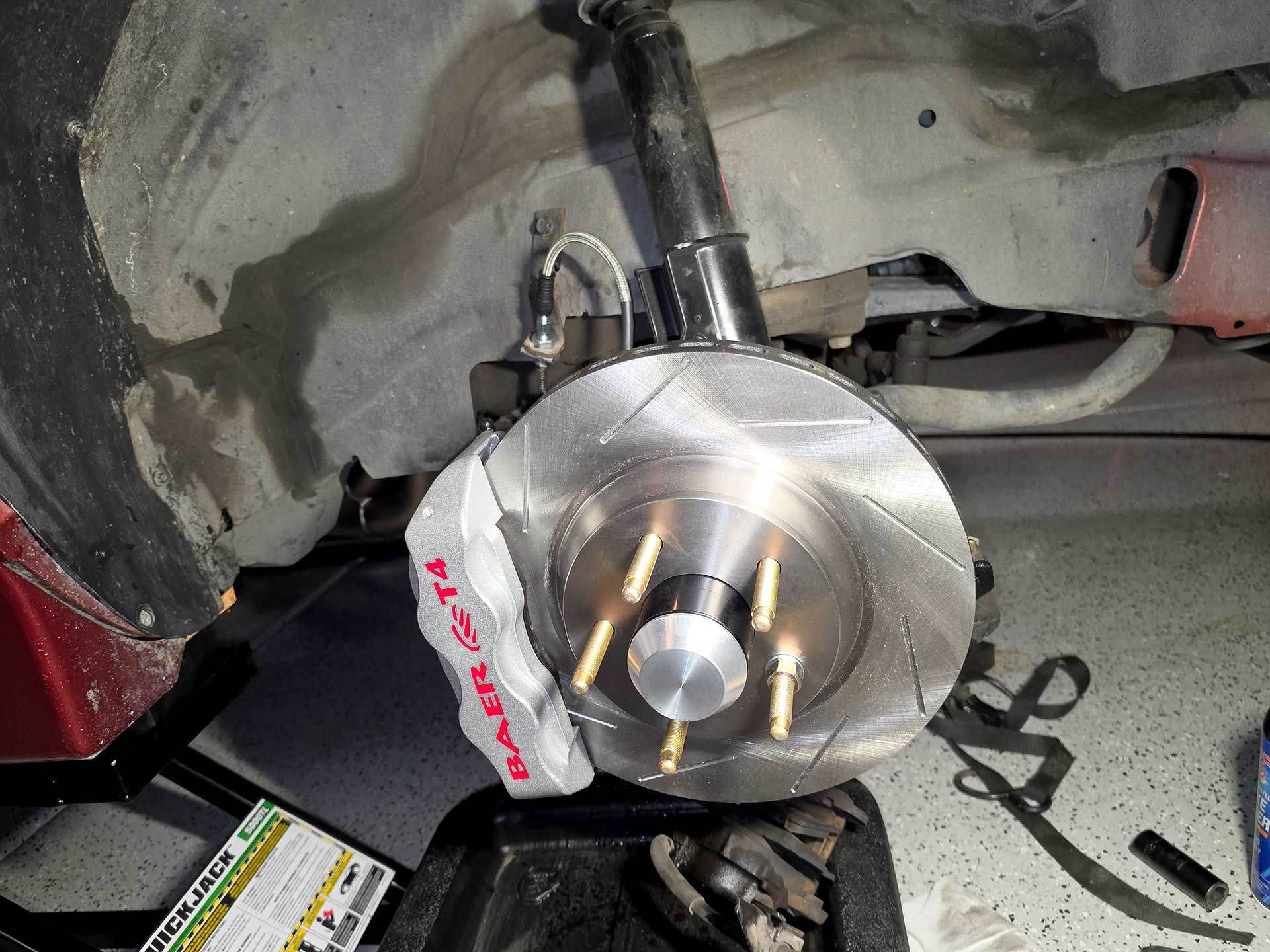

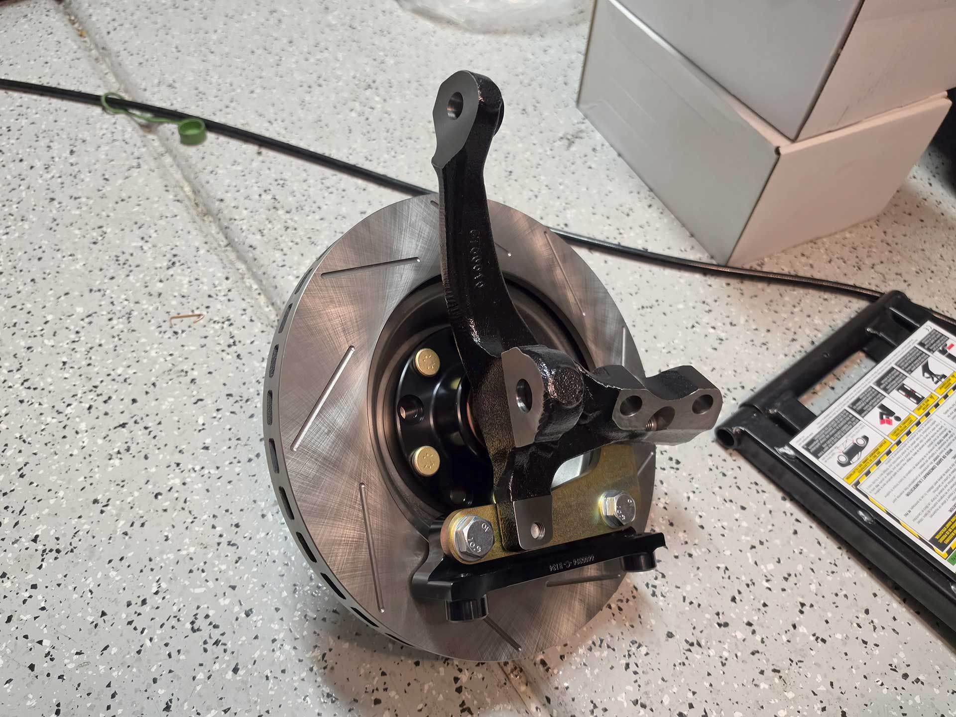

So I finally addressed the brakes, they were still stock from what I could tell and they were absolutely terrible! The car accelerated probably 3 times as fast as it could stop, I am pretty sure they were factory pads or some cheap auto parts store pads but the part number was worn off so I couldn't really tell. Either way literally one hard stop was all that was required to make them fade and smell. LOL
Baer Brakes has a million different options for setups on these cars and their kits are probably the most complete I've ever seen. It literally included everything necessary to do the swap minus fluids, they even include little rubber caps to use on the brake line when you disconnect it so it doesn't **** everywhere. I chose their 13" Track4 Front Brake Kit so it has some actual modern stopping power and it fits under the 17" replicas that I have. For the rears I picked their 12" SS4 kit so I could still fit 16" rear wheels with drag radials on them for drag duty. It's really cool too that you can print out the templates for the brakes to test fit in the wheels that you have to make sure it will all clear. I can't say enough about how impressed I am with their kits, and no I didn't get any kick backs for saying this!
The front's came mostly assembled on spindles and I just had to remove the old assembly and put this one in it's place and bolt up the calipers, doesn't get much easier than that. The rears are more of a pain in the *** due to the caliper/ebrake brackets that have to be swapped so I got to pull the rear cover and get to the c-clips to remove the axles. Then it's just unbolt the old and bolt in the new brackets and now they work and look like the 4th gen f-body's rear e-brake setup. They include new e-brake cables and everything to make the conversion. While I had it apart it was a good opportunity to throw on the T/A diff cover sitting here as well, every little bit helps with a 10 bolt!
Here is just a dump of the pictures I took when I was putting everything on...
