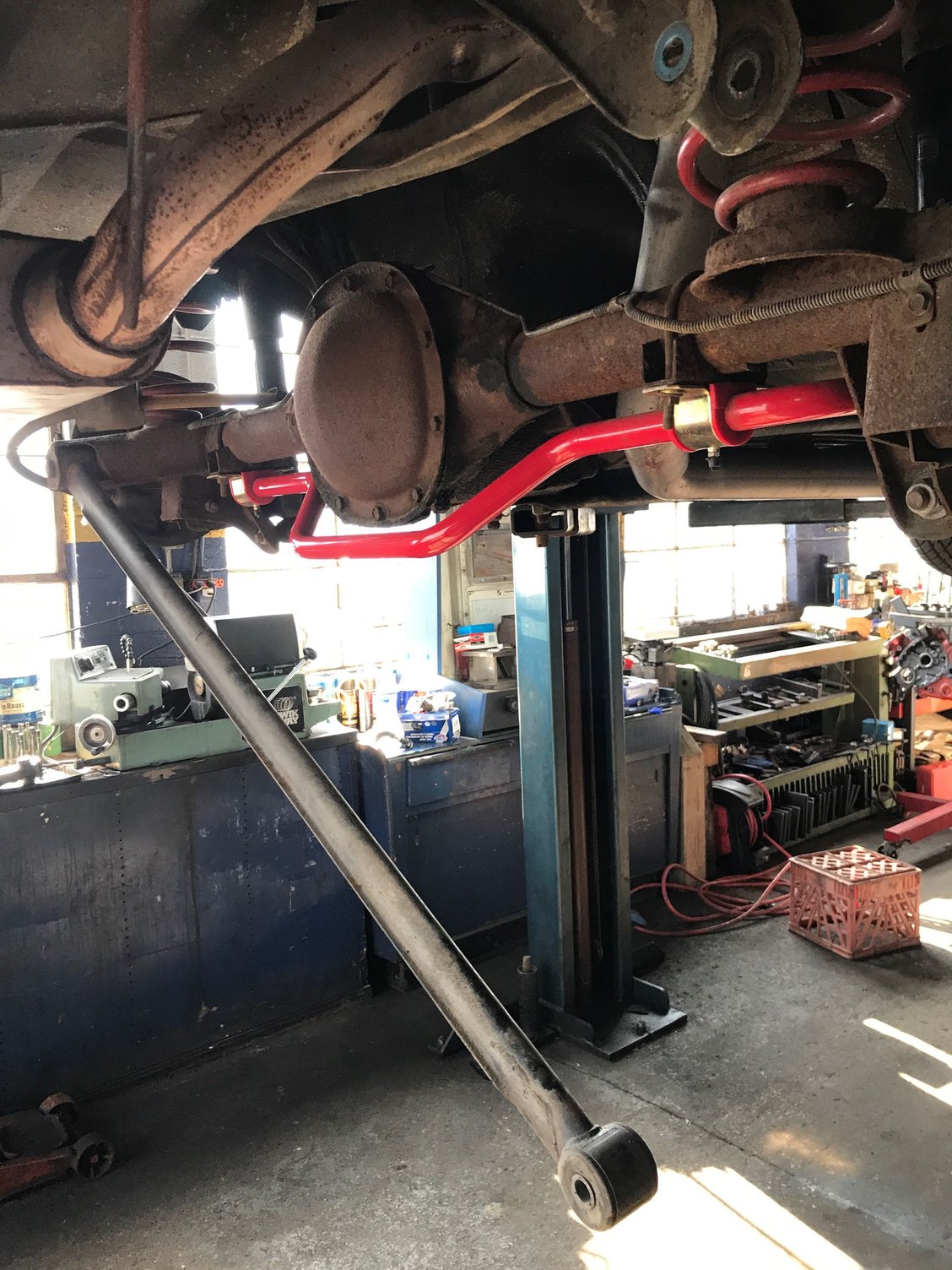

Starting from the earliest changes were the suspension changes. I don’t have any pictures of the steering brace but adding that in also made a huge difference in the front end. Eibach sportline springs were already in the car.
Just by adding the thicker sway bars the handling changed drastically.
Pre-modified rear.

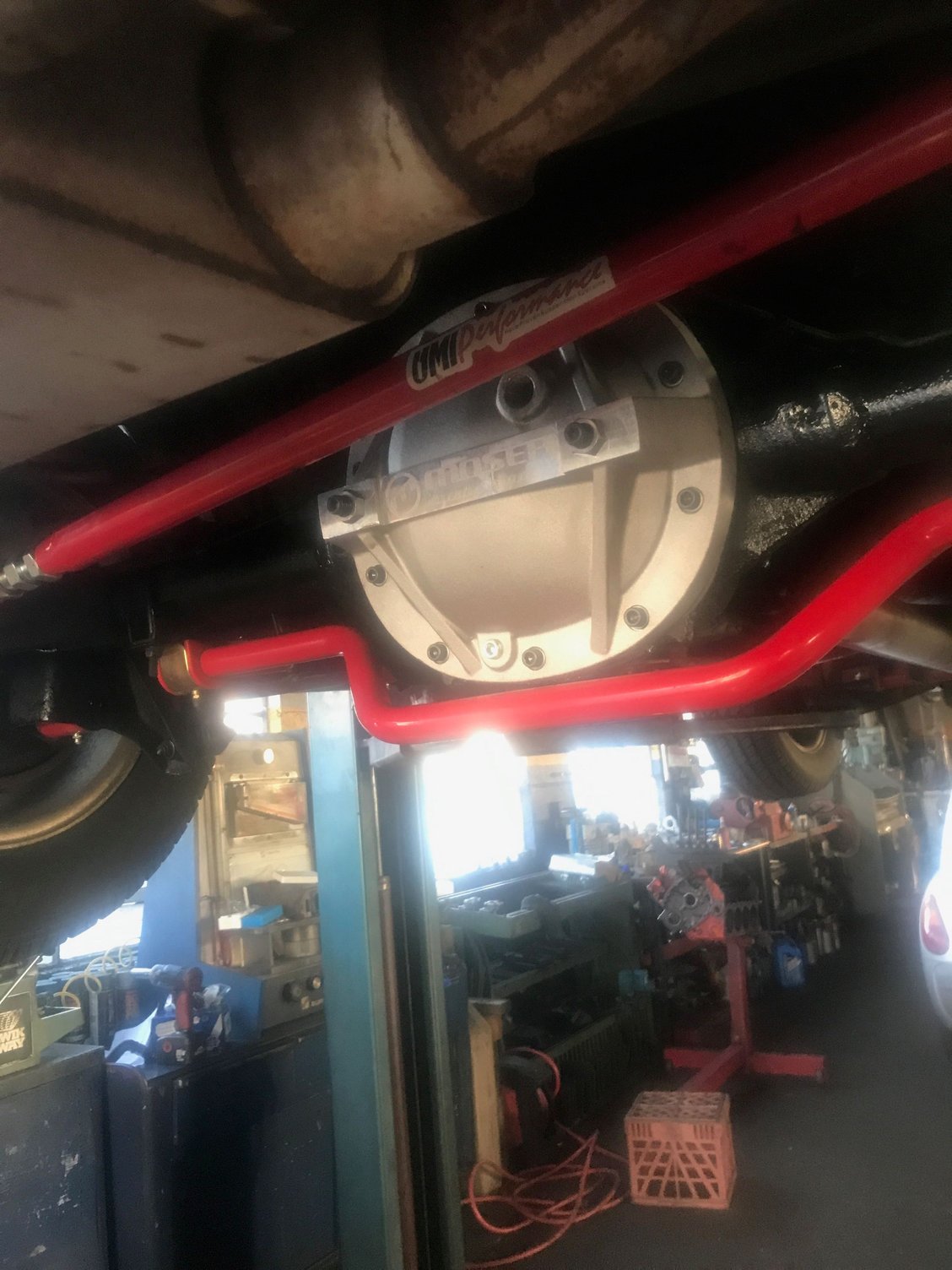

Later I decided I didn’t want to swing a new rear end in so I did what I could to the 10 bolt. Welded tubes, Yukon positrac unit, moser 28 spline axles and Richmond 3.73 gears. More to come on that.
Lower control arms.

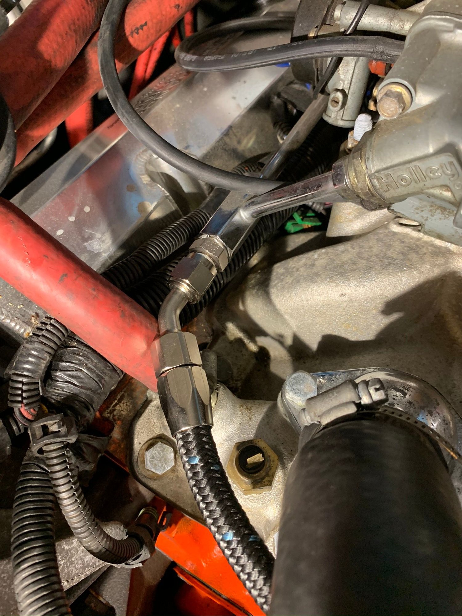

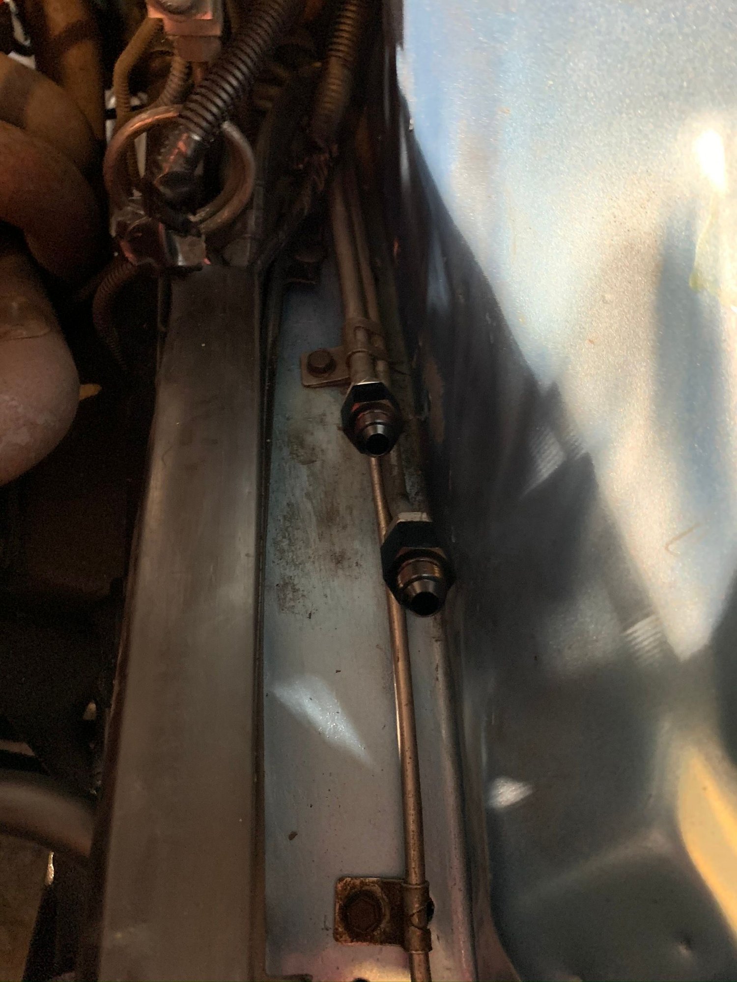

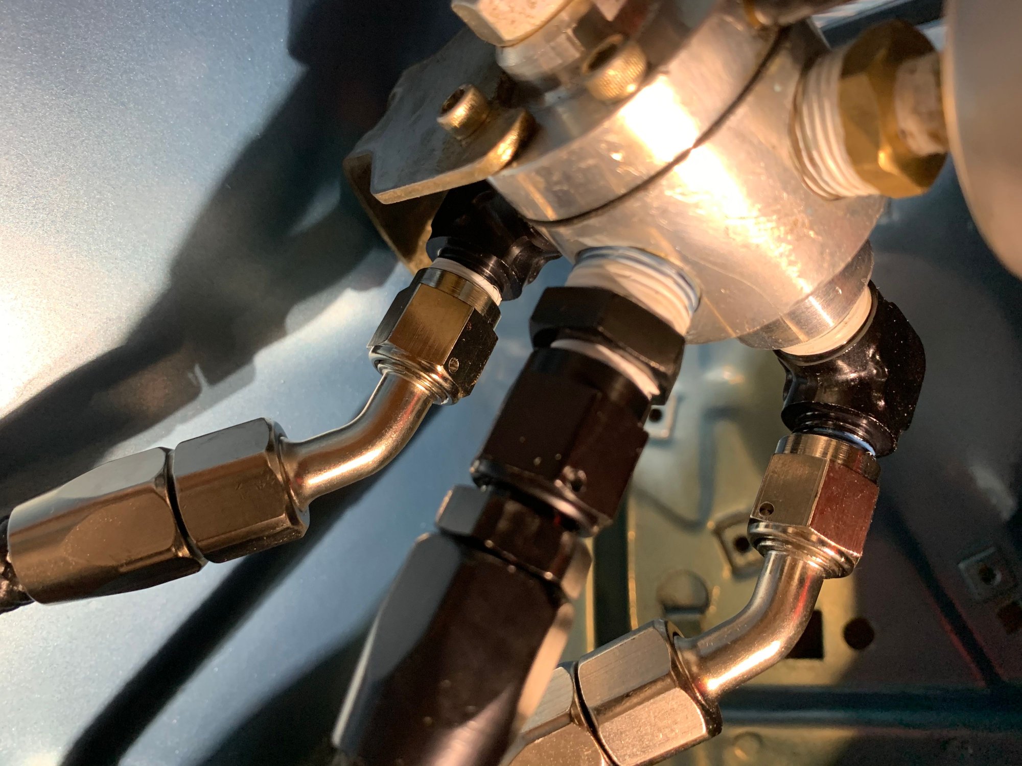

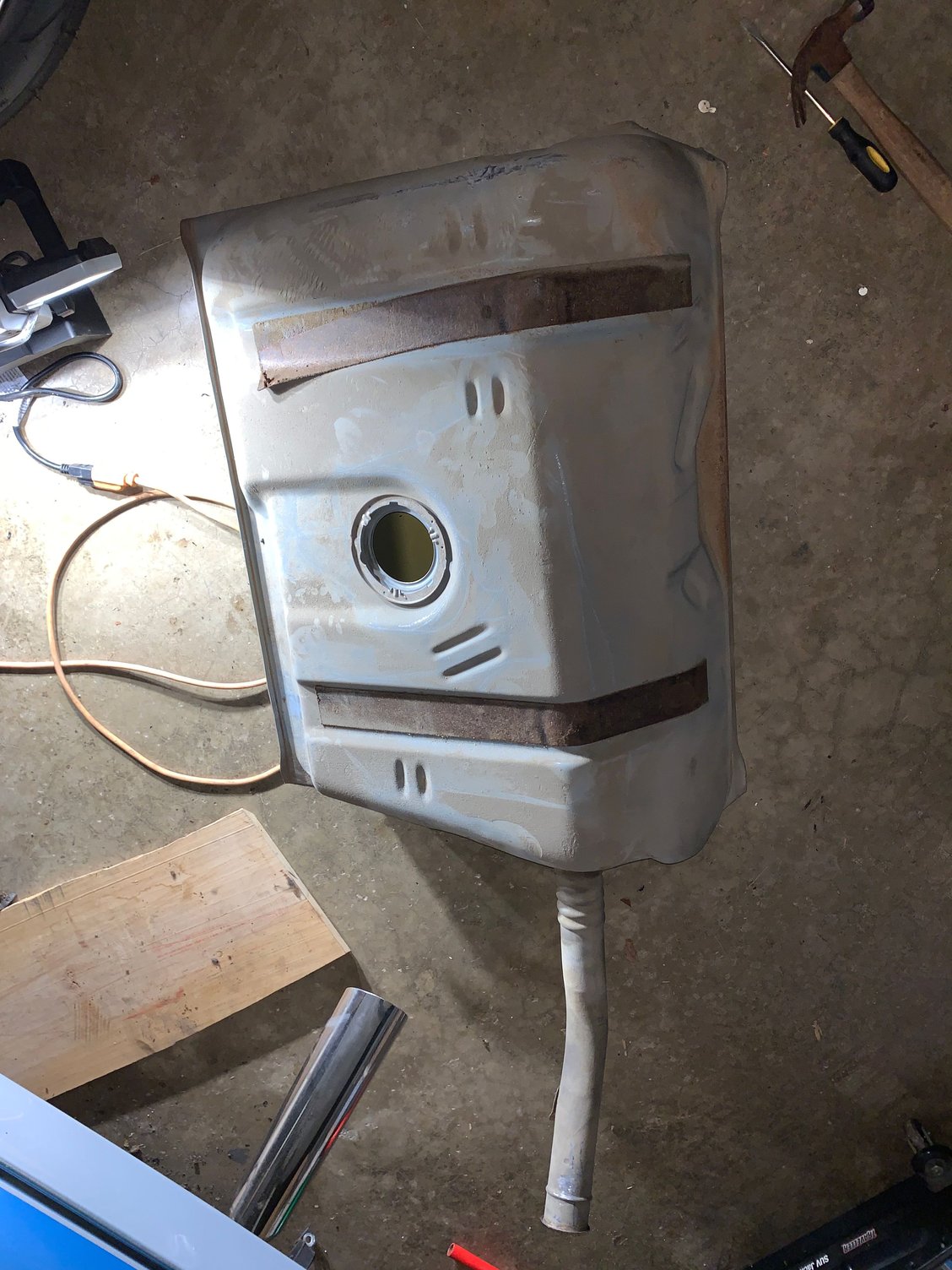

FUEL PUMP:

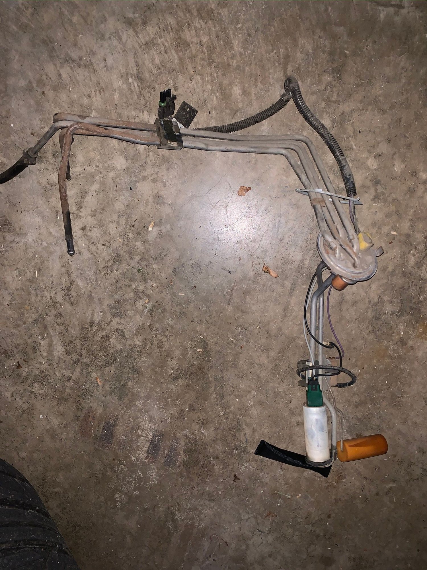

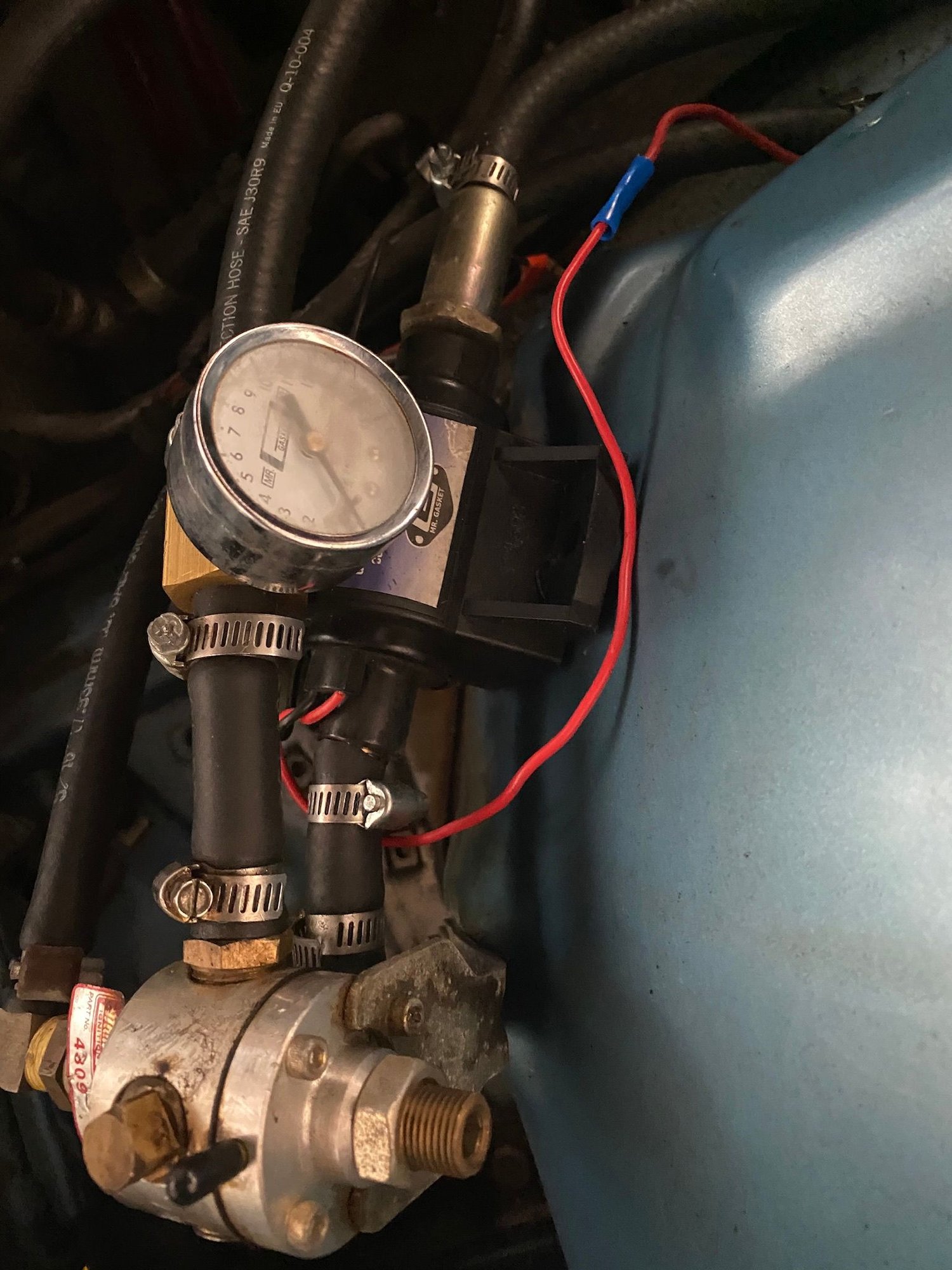

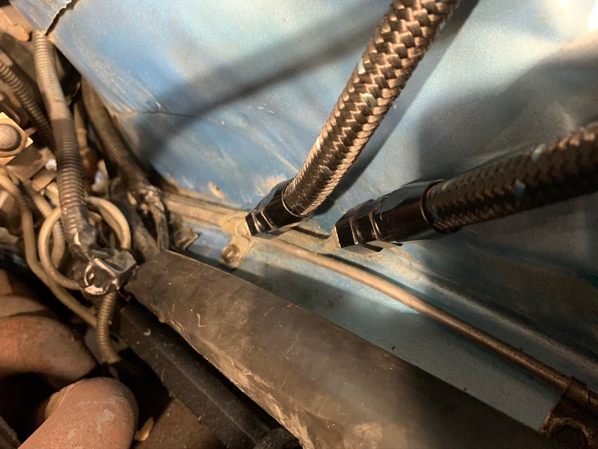

One of the most annoying things a third gen owner can go through is having to replace a fuel pump. For the short time of limping it home and not tearing into the car I put a cheap autozone inline pump on it and ran it. Finally had to do the proper switch and install the Walbro 255 fuel pump and new sending unit. Also upgraded some of the fuel lines to braided and added some AN fittings.
Not safe lol what I had to do to get it home
Old fuel pump and sending unit
Cleaned the tank before putting it back in

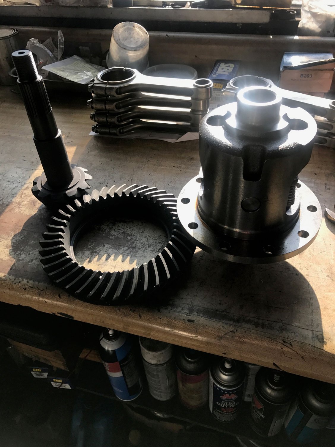

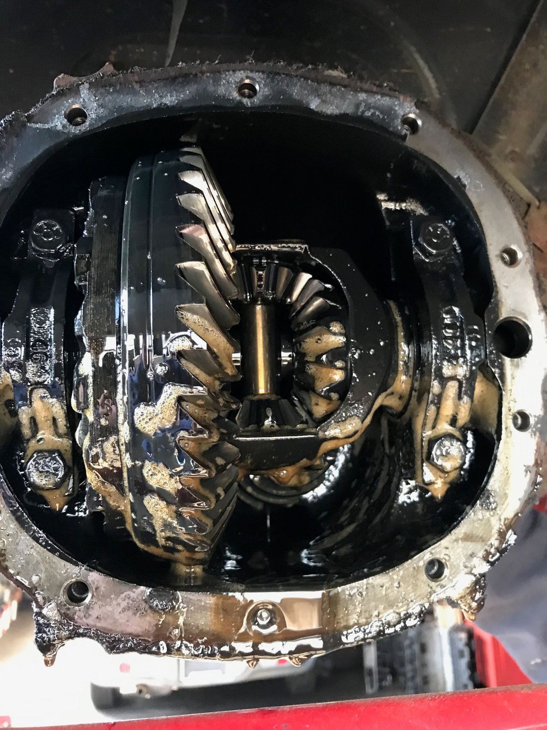

REAR END:
I know opinions vary greatly here as well. I don’t get to drive the car much and spending another 3-5k on a better rear didn’t work.

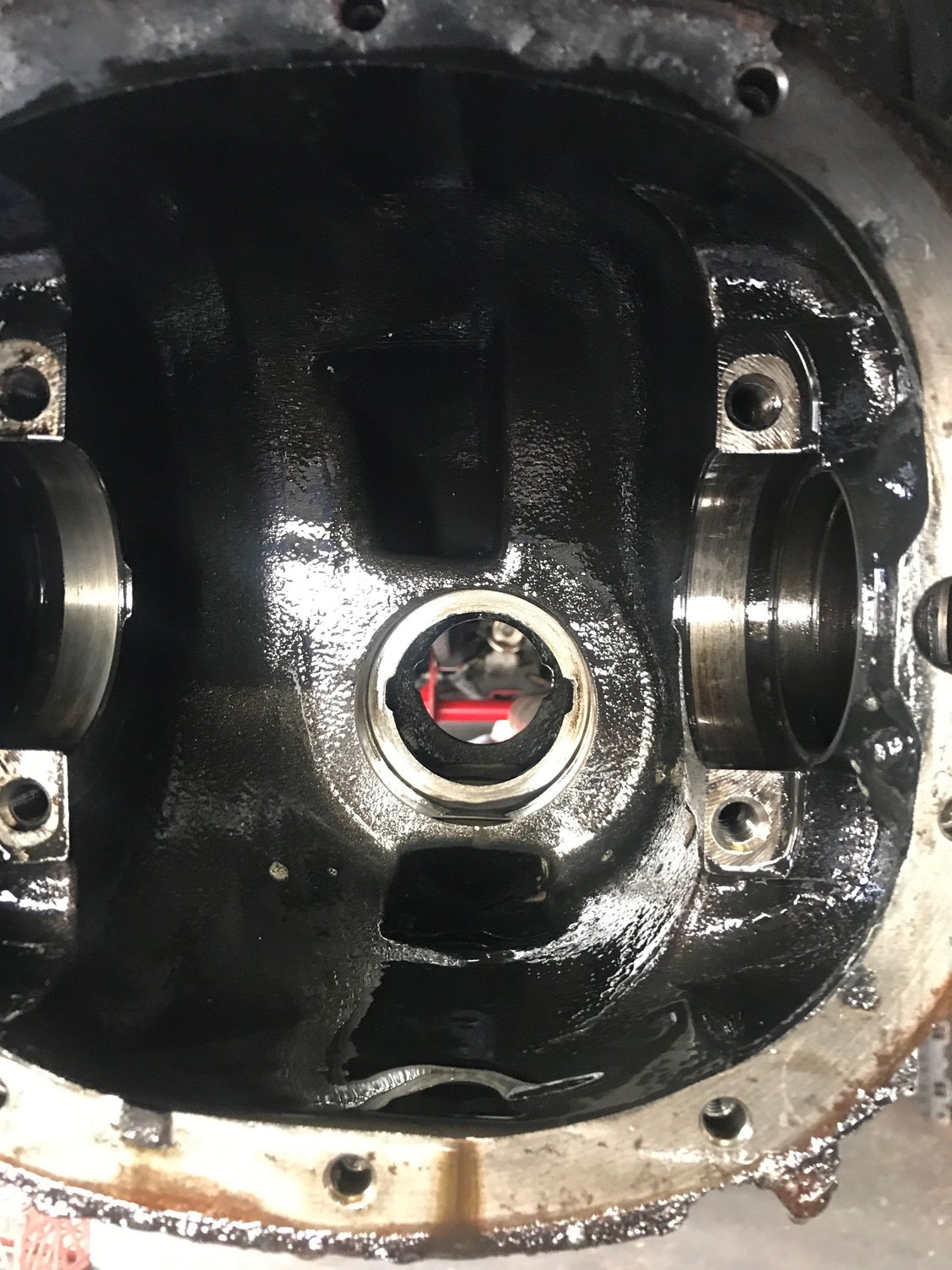

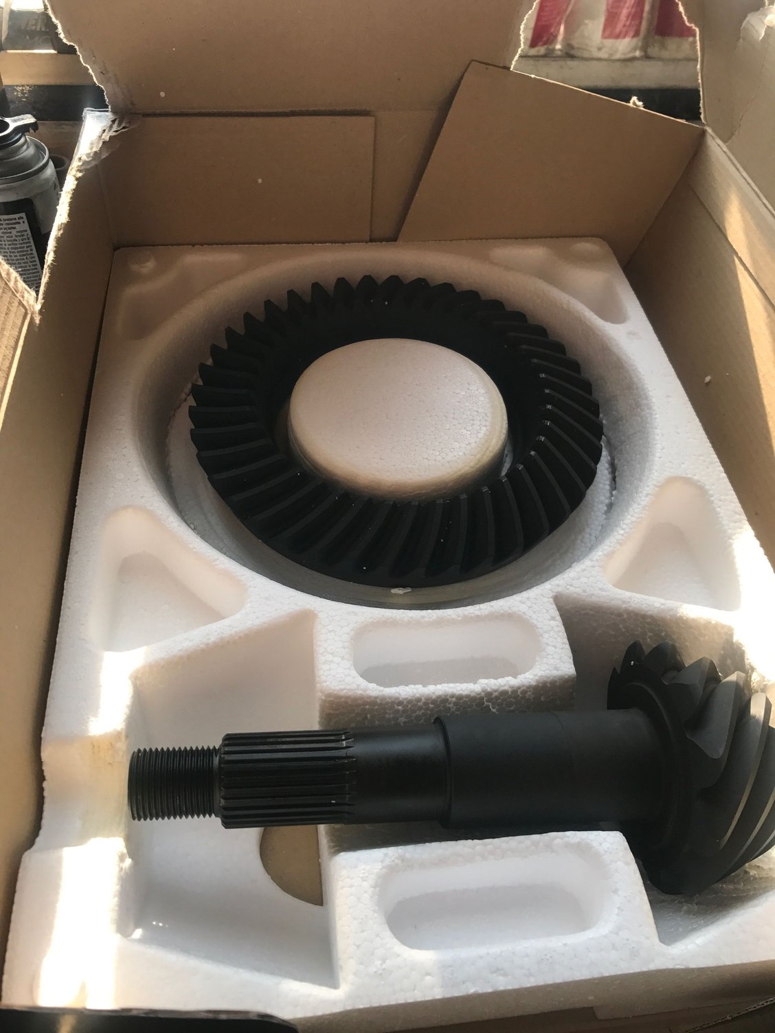

I settled for upgrading the 10-bolt. Threw in a Yukon posi trac unit with Richmond 3.73 gears. Moser 28 spline axles and an upgraded diff cover. Also welded the tubes to hopefully help longevity.
Shortly after the first install I sheered the spider gears off... was out of warranty for the diff unit so had to buy a new one. I have a feeling I didn’t break the first one in properly. After second install everything has been fine. If I can figure out how to upload the video I’ll show why the first unit sheered.
