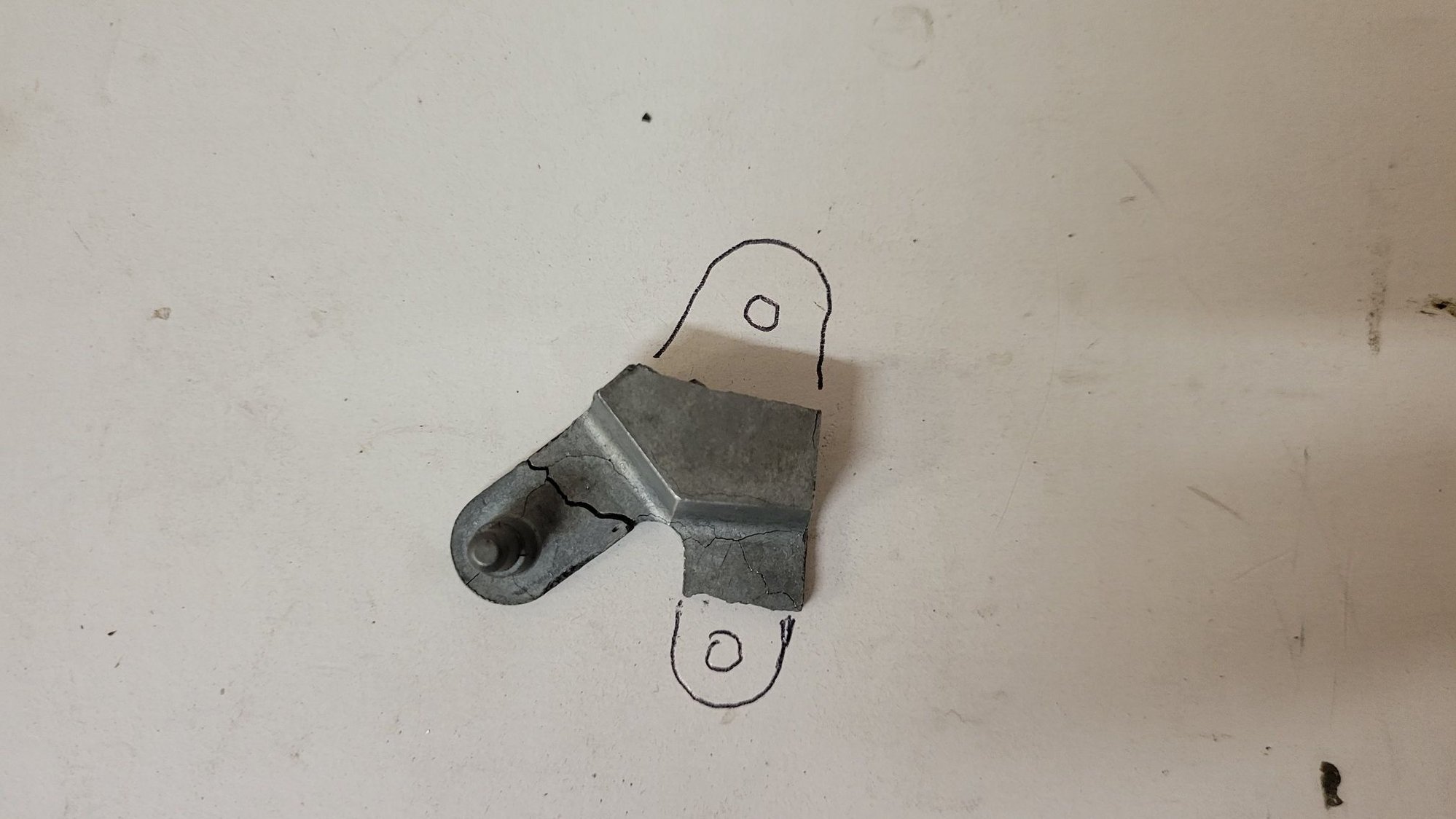

I did fix a stuck heater blend door, and found the potmetal actuator was broken.
I bought a nice metal one from @nickalope24 and it arrived on 3/30/26. It'll outlast the rest of the car! Very nicely machined.
I'll have time to install it in a few weeks, and also flush out the heater core and test the function of the shutoff valve.

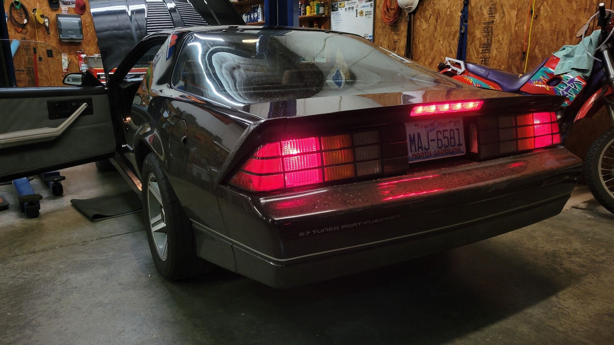

The third brake lamp bulbs weren't illuminating, and research showed it was usually a bad brake light switch, so I ordered one. With a new switch installed,
still no 3rd brake light. Upon closer inspection, all of my bulbs were burnt out! So last week I ordered five 10-watt bulbs from Lon at TopDownSolutions, a vendor here.
Reinstalled the OEM brake light switch, and returning the other one.

Heater blend door actuator. Very brittle potmetal, missing a couple arms.
3rd brake light working! 10w bulbs from
Very rubust replacement Heater blend door arm
