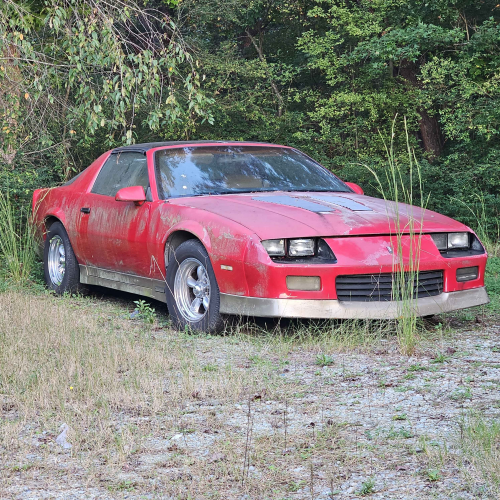

Pic from when I first saw her

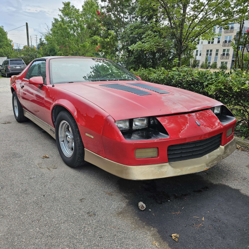

How she looks now after a good wash
