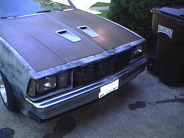

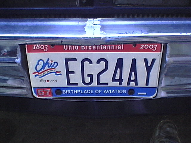

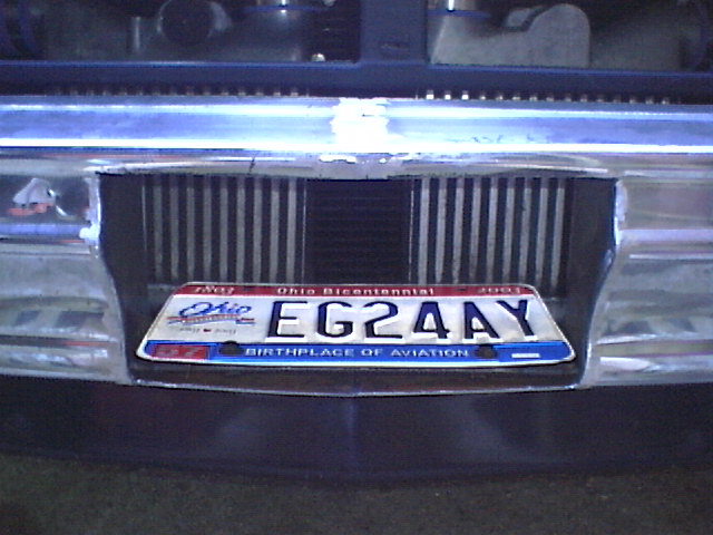

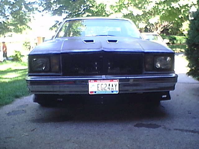

Made the front plate drop under boost to allow more air to the intercoolers.. And narrowed the bumper again,(4 inches total) and set it back 1.5 inches. Controller will be adjustable and additional outputs will also control water injection later.
Smooths things out a bit.
Yeah I'm weird.. BW

That’s pretty sweet, what did you use for an actuator/hinge setup?

made the hinge myself.. looking to use a firebird headlight actuator to flilp it up and down, via a boost referenced LM339. BW

thanks... it'll have a bottle too.. just not a blue one.. also adding a homebuilt WI plate similar to a NOS TB plate and additional nozzles misting the intercoolers. Also controlled via adjustable outputs from a 339 via boost.
Whats really trick is currently on stands in tha garage.. but that cats still in the bag.. (sworn to secracy)
