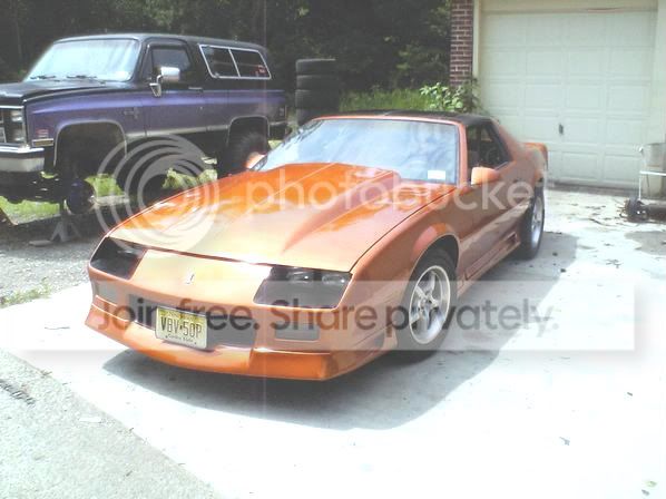

I can see the Jongbloed happening if you modified the K-member, & lowered the engine a tad.

thermal coat he hot side in black also. and i think it looks bad *** as is man.

First leme just say that I know NOTHING about turbos OR fiberglass, but, if you had someone good with fiberglass, how hard would it be to extend the hood out on either side. Not really cutting and of the hood that is there unless you wanted to, but just like.. either making a 90 degree arc with whatever radius on each side covering up the turbos. That could also make the front end perfectly balanced as long as the added stuff is equal radius on either side. I dont know how hard that would be so I may just be speaking impossibilities but /shrug. Of course a simple square extension on each side would work too.
anyone understand me? i feel like im speaking in circles

I think if you want the turbo's covered up ... glass in each side of that cowel at a 45 to the side.
A good FbrGlass place should have no problems doing that.
I have that same hood on my car (Wide 3" cowel.) All my stuff fit under the stock hood but I wanted to do somthign different. That 3" cowel is nice. I'm not sure if your stuff will fit under it.. Your welcome to do some tuning and driving and come bolt it on your car. I drove mine home to the heated garage last night. It's not going anywhere till spring. Going over my list of winter stuff and getting ready for spring.
Leaving your turbo's exposed is kinda cool.. Just depends on the look your going for.

Right now, i likeit open to dissapate some heat under the hood...
I tried making some mock ups of bulges with cardboard and i cant seem to come up with anything that looks good on this car.. Oh well
